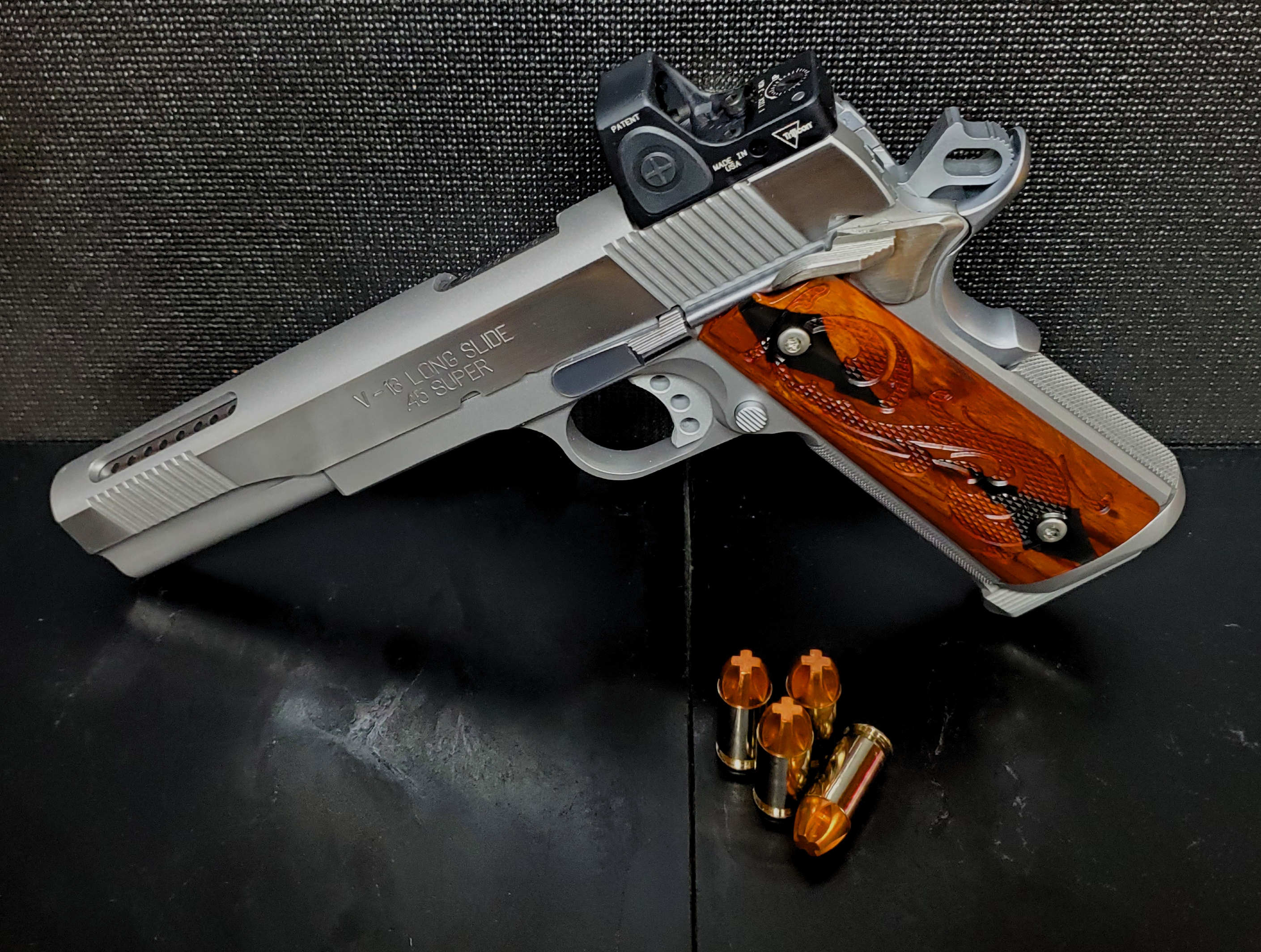

When I decided to try the optics I bought a complete slide assembly. had it milled for the RMR had the front sight milled off and no rears installed.
I didnt want to have to unlearn 50 years of iron sight shooting while trying to learn the dot & presentation.
Best move I could have made.
Any one that has a setup already and having troubles because of front sight focus/distraction I would recommend pushing the front sight off and trying again. Get rid of the rear sight as well if you can.
This is the pistol I cobbled together to learn the dot on and as you can see its sleek & clean, distraction free.
Fine shooter as well.

Nice set up!

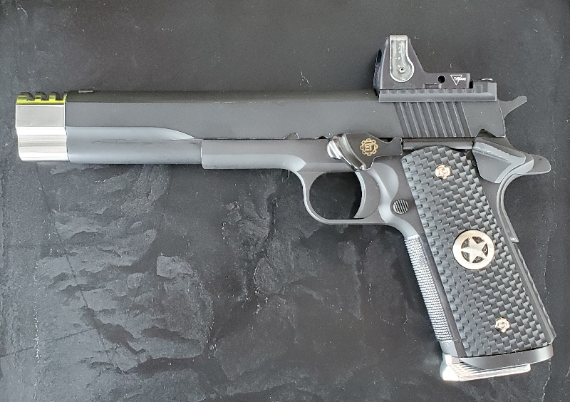

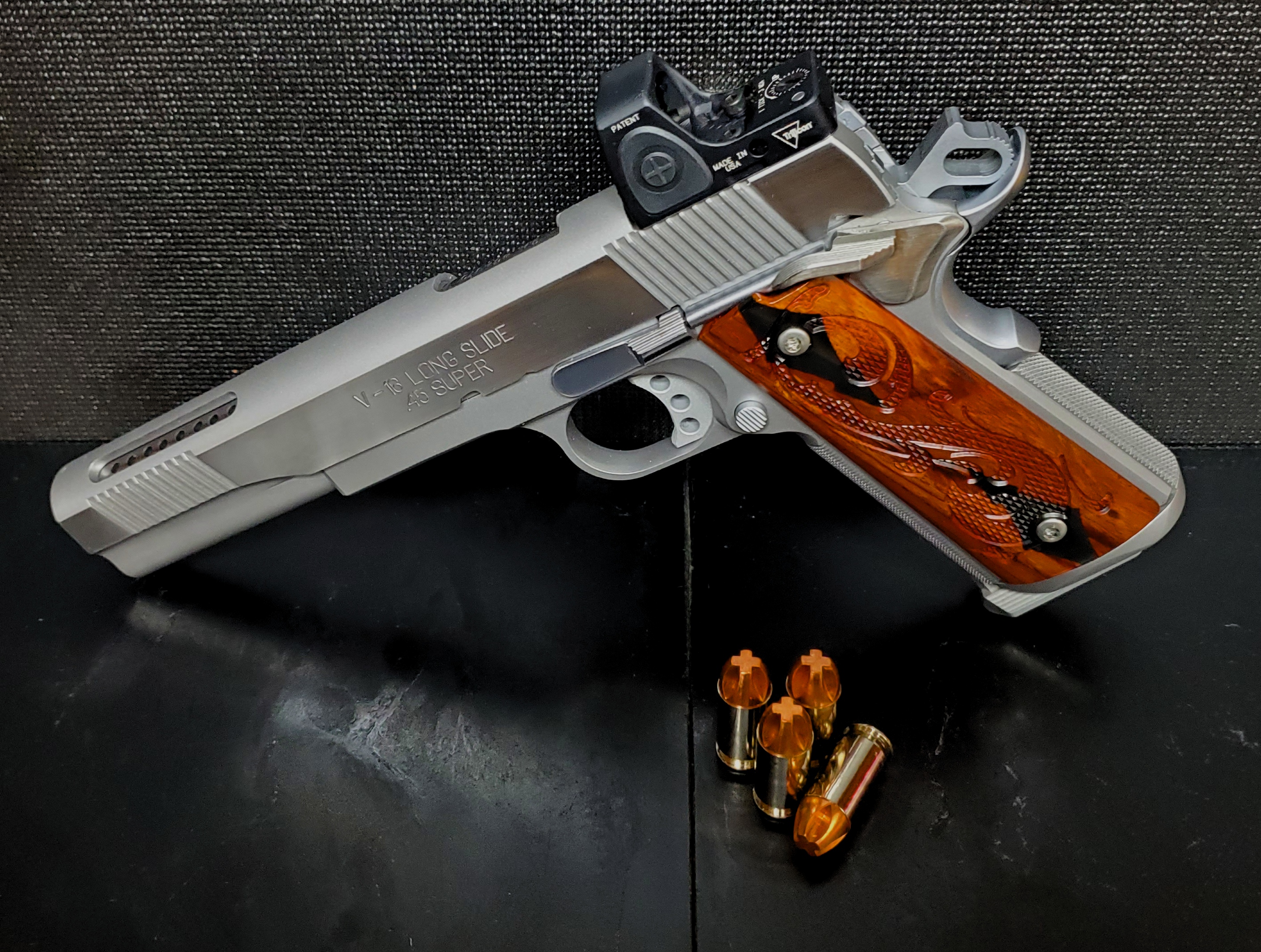

The test pistol above led to what i actually wanted.
I learned this...
1. No adapter plate, direct mount in the slide. Slung low is best.
2. Farther back on the slide is best. If you must have rear Irons mill the dovetail ahead of the optic instead of behind it.
3. Bushing style compensators are not very efficient as gas comps but the 2 oz chunk of steel out on the end helps alot but tends to make you dip in between shots.
From beavertail to muzzle its 10 1/2 inches and weighs 50 ozs
My neighbor lady shoots it, loves it. Shes 88 and weighs 120 lbs lol

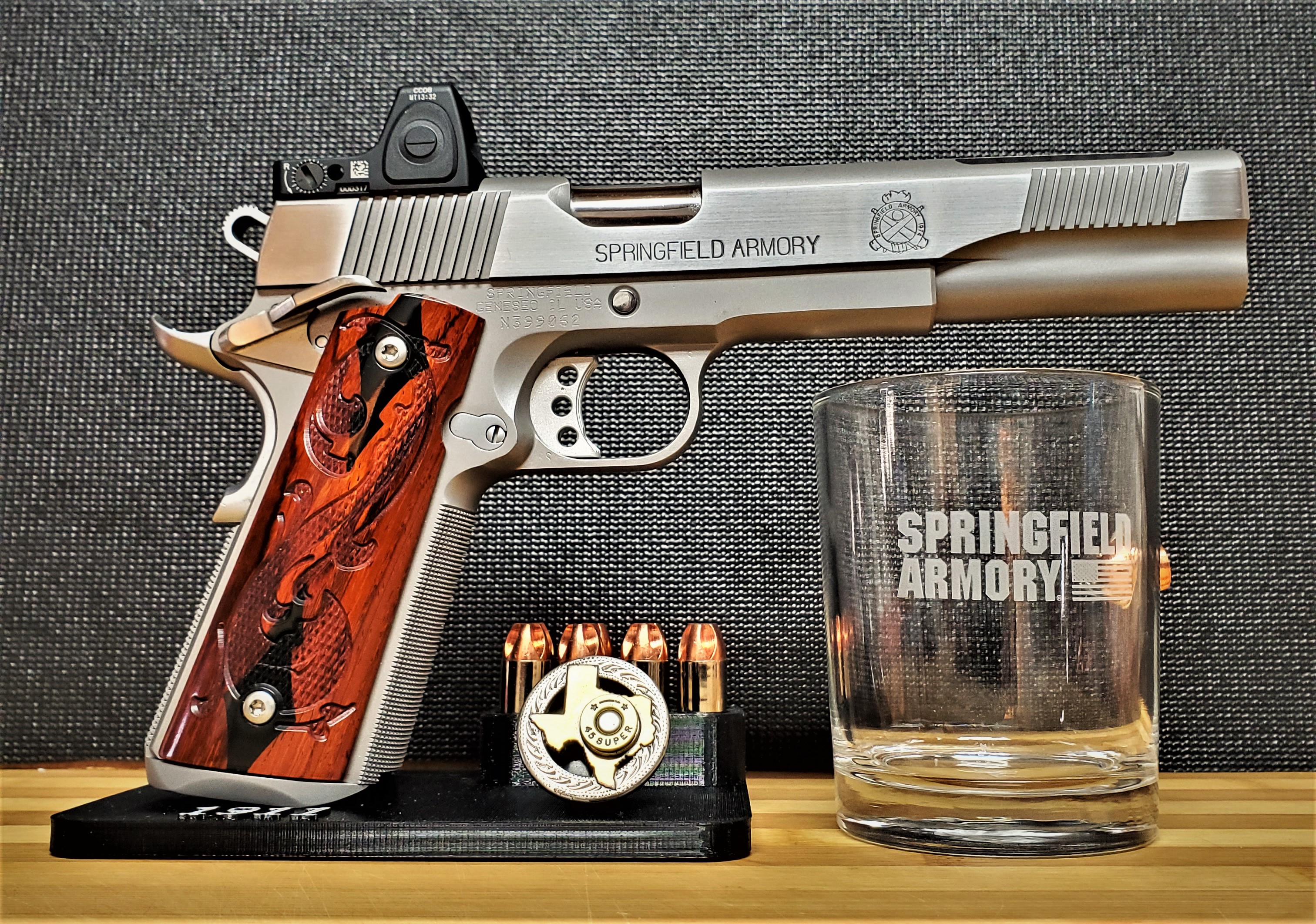

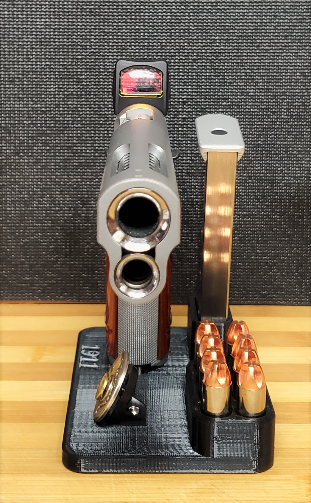

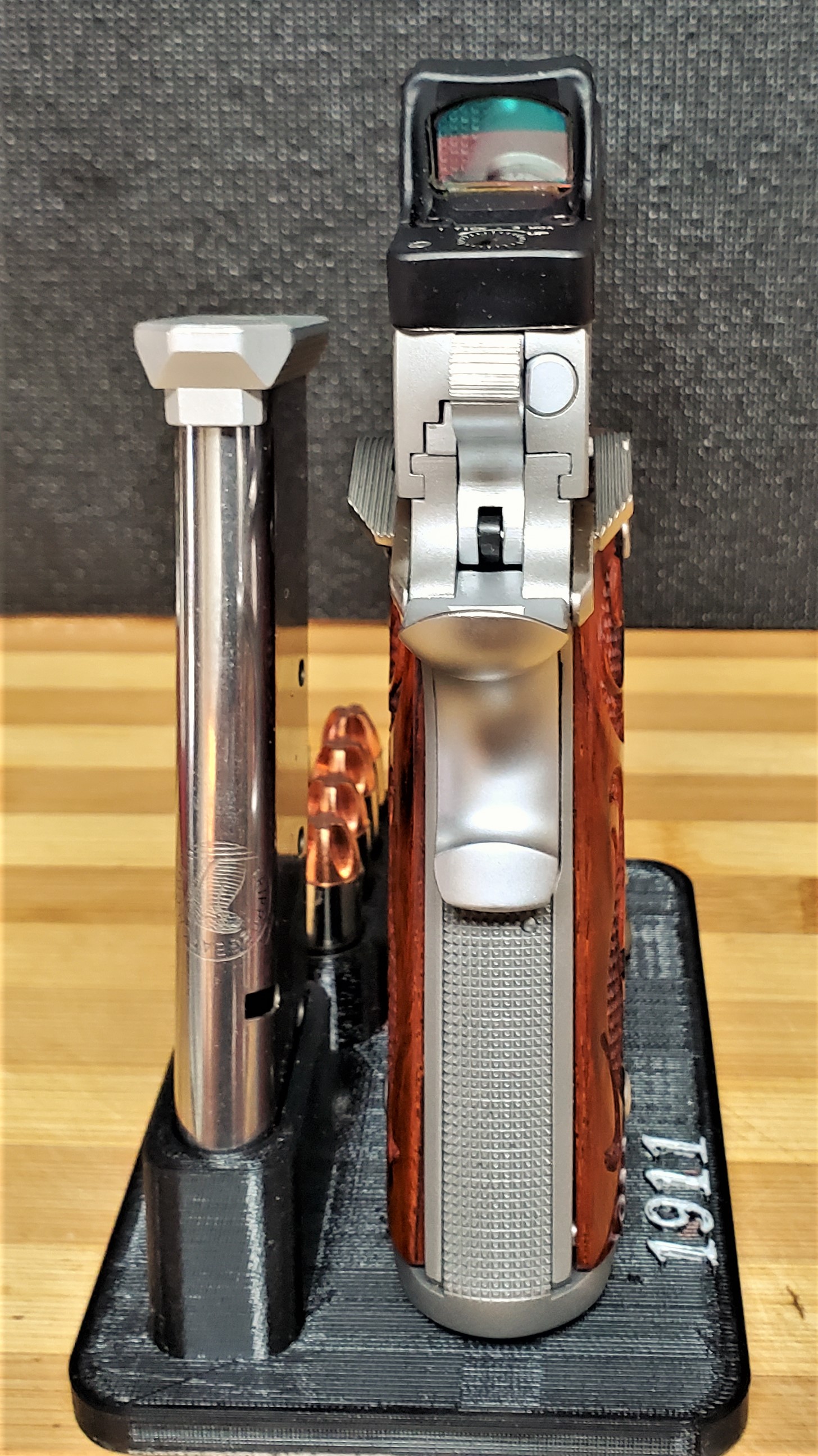

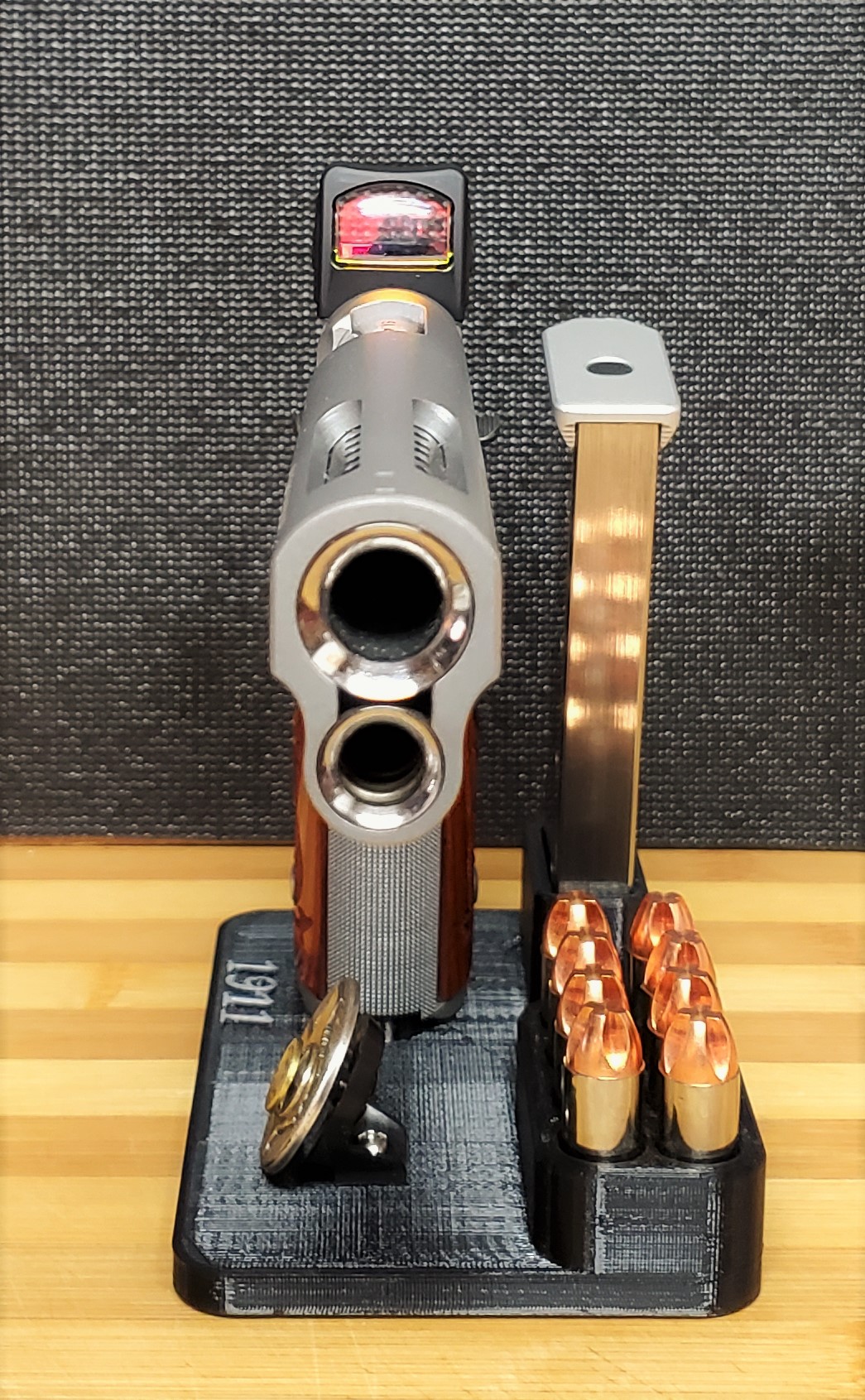

Based on the above I started on my Springfield project with a NIB/NOS V16
Born April 2000 so it was 20 when I started on it.
Took 9 months to complete
Every aspect was touched in some way internally & externally.
Dehorned
Smith & Alexander 1 piece magwell blended & scalloped.
RMRcc and associated milling
Every piece inside is polished and stroked and looks like a mirror
3.5 lb avg trigger pull
Reverse crowned barrel with matching reverse crowned spring plug.
.45 ACP to .45 Super with a simple recoil spring change
The list is long lol
Most of you guys seen it a hundred times prolly but I cant help it.
Im still enamored with it so here it is... again :ROFLMAO:

"EDIT: my apologies guys I completely lost sight of the fact that this is a thread about the Hex optics. :rolleyes:"
Eh, we'll live! :)
Labors of love?
Why does anyone think people have/had reams of kid's photo's weighing down wallets or things hanging off fridges? Now day's those pic's may be on cell phones, but? Strongly suspect same holds water or is true for any finely tuned project including firearms we've gotten into?....Many of us are likely guilty and as proud as charged? :)
