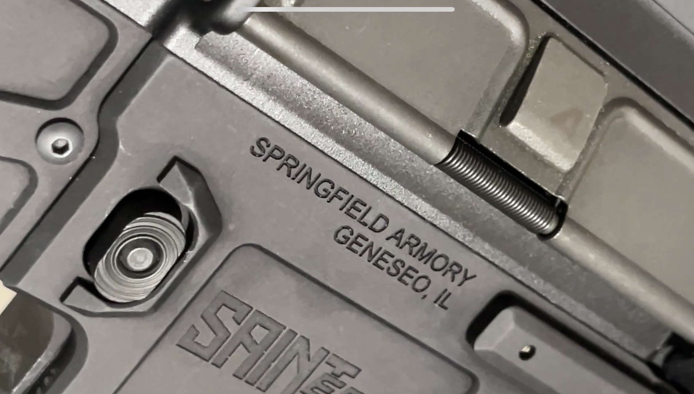

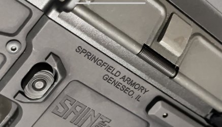

Hello everyone. How much play (slop, wobble) should there be between a Saint upper and lower?
I never noticed any play between my Saint Edge upper and lower when I got it a few months ago. Unfortunately, I had to send it in to Springfield Armory to have the lower replaced due to faulty quick disconnect mounts. When it came back I started hearing clicking and feeling wobble when handling it. I understand there can be some play between AR uppers and lowers. Especially when building them. And I'm new to ARs so maybe my expectations are just off. But I feel like there should be better fitment in a Saint than what I've got right now. I recorded a video to share but I guess you can't upload videos directly to the forum so I'll attach a few pictures. The pictures aren't a good representation of the wobble but probably better than nothing.
Thanks in advance for any feedback or insight.
Take off the pistol grip, be careful of the small springs. Use a long Allen wrench to tighten up the set screw. Be careful about tightening it up to much that you can’t push out the take down pin. Reinstall the pistol grip. Again watch out for the small springs.
This information is in your owners manual.

Great advice!
I will add that when loosening the grip screw keep light pressure down on the grip and when the screw is free, slowly lift off the grip to not have springs flying.
Here's a video below on how to tighten your Accu screw in your Saint Edge.
