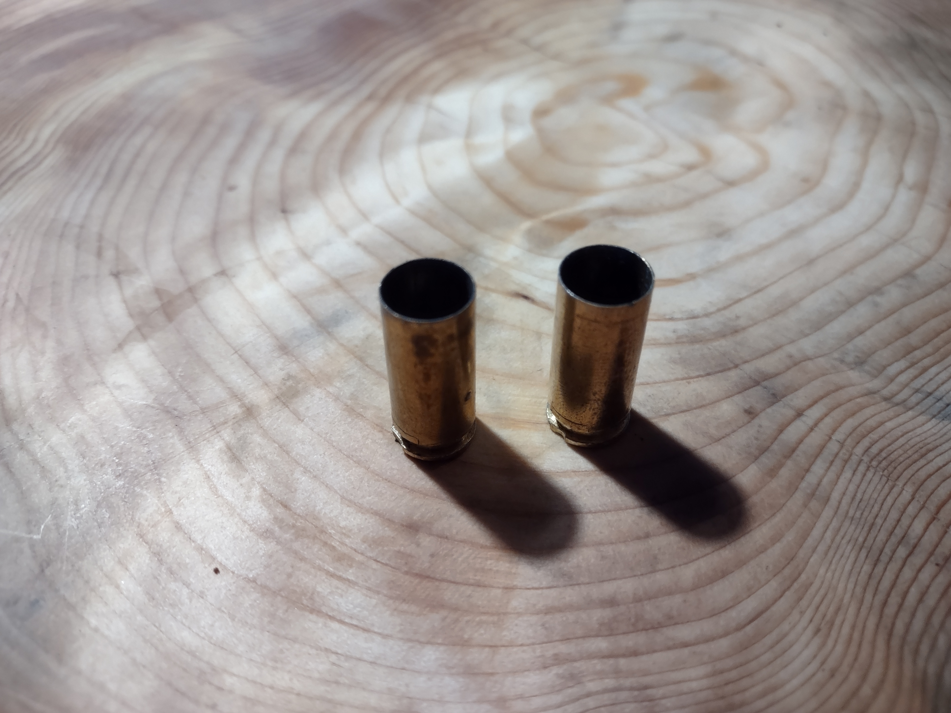

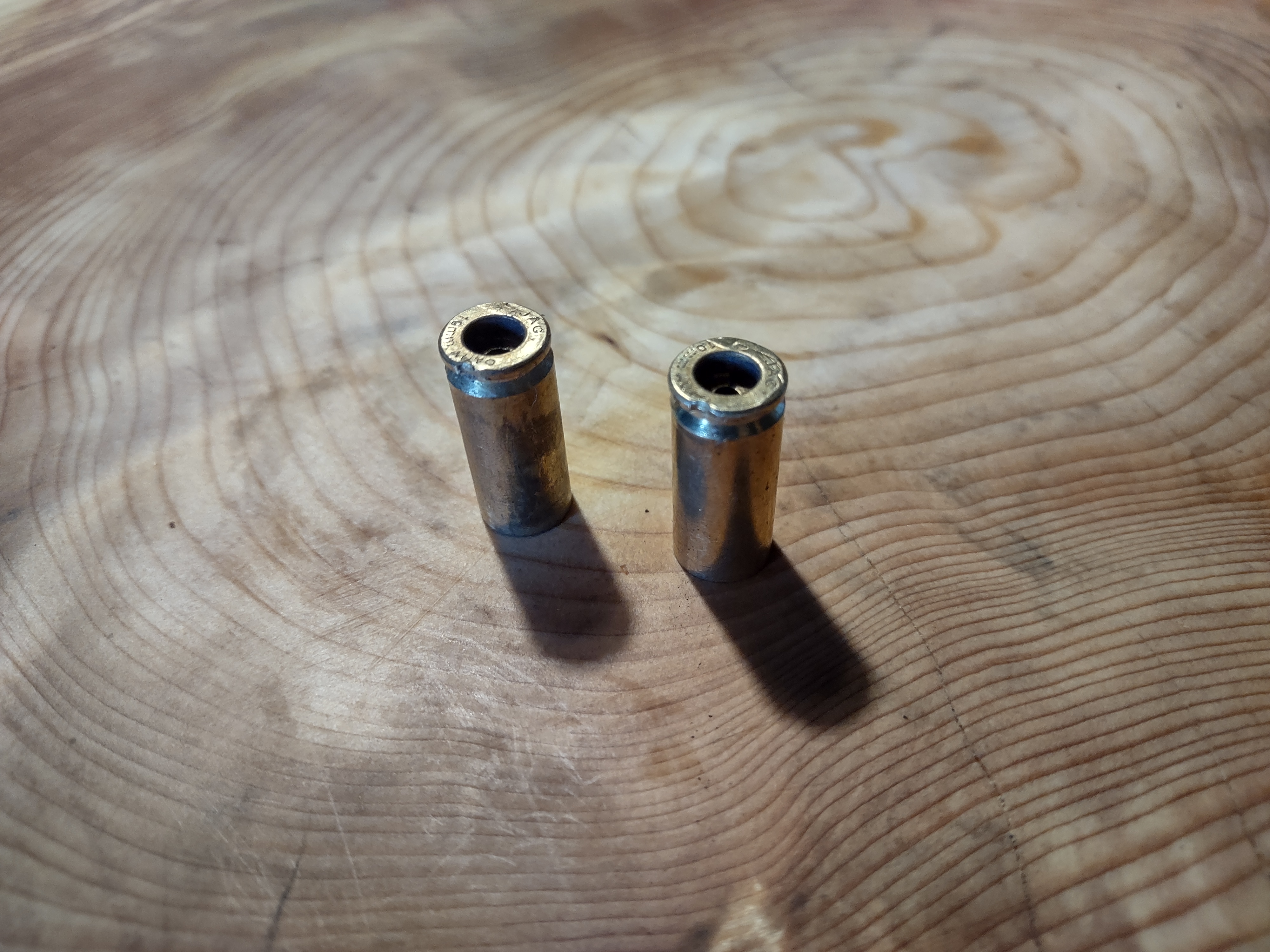

I wanted to post a couple pictures of the two 10mm cases that got stuck in the chamber of my 1911 and a couple pictures of one of the ammo manufacturers. Both loads were hard cast 220gr. One from Buffalo Bore, the other from Grizzly.
Now it's totally clear that you can see the primers blew out of both cases. However, if you look closely at the rims of both cases you can clearly see where the extractor left a notch in it after cutting through the rim when the slide cycled back!
Kimber replaced my extractor when I sent it back for repairs. I'd bet even money that the extractor was damaged from the two stuck cases and that's why it was replaced by Kimber!👍

If it’s blowing out primers it’s too much for the gun. Pressure reaches its peak right when the tail end of the bullet enters the rifling. Your brass is essentially welded to the walls of your cylinder at that point because the pressure is too high for the extractor to pull it. There isn’t enough weight in the slide to prevent the primer from forcing it backwards at peak pressure. If I had to guess, they are likely over pressure of you’re lucky you haven’t had a kaboom yet.

There are obviously over pressure from your description .
