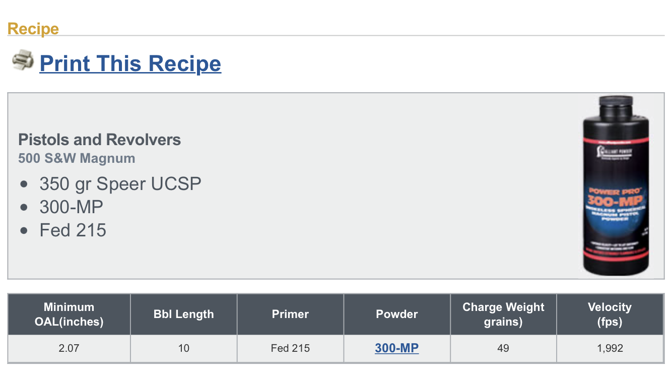

Lol, 500 S&W is a 65,000 psi cartridge. Here is the load data for my heavy hitters, it’s not for the faint of heart, I assure you 😉
That load is pushing 3084 ft lbs from a 10” barrel using a true magnum powder. It’d surpass 4000 ft lbs from a 22” lever gun with ease. You’re only talking +278 fps to get there with 12 extra inches of barrel.

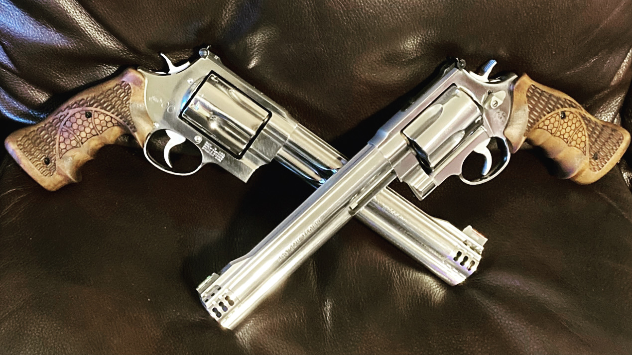

Personally, I like the handguns more than the rifles. Don’t ask me why, I have no idea. Guess I handle the recoil better in the wrist than the shoulder 🤷🏻‍♂️

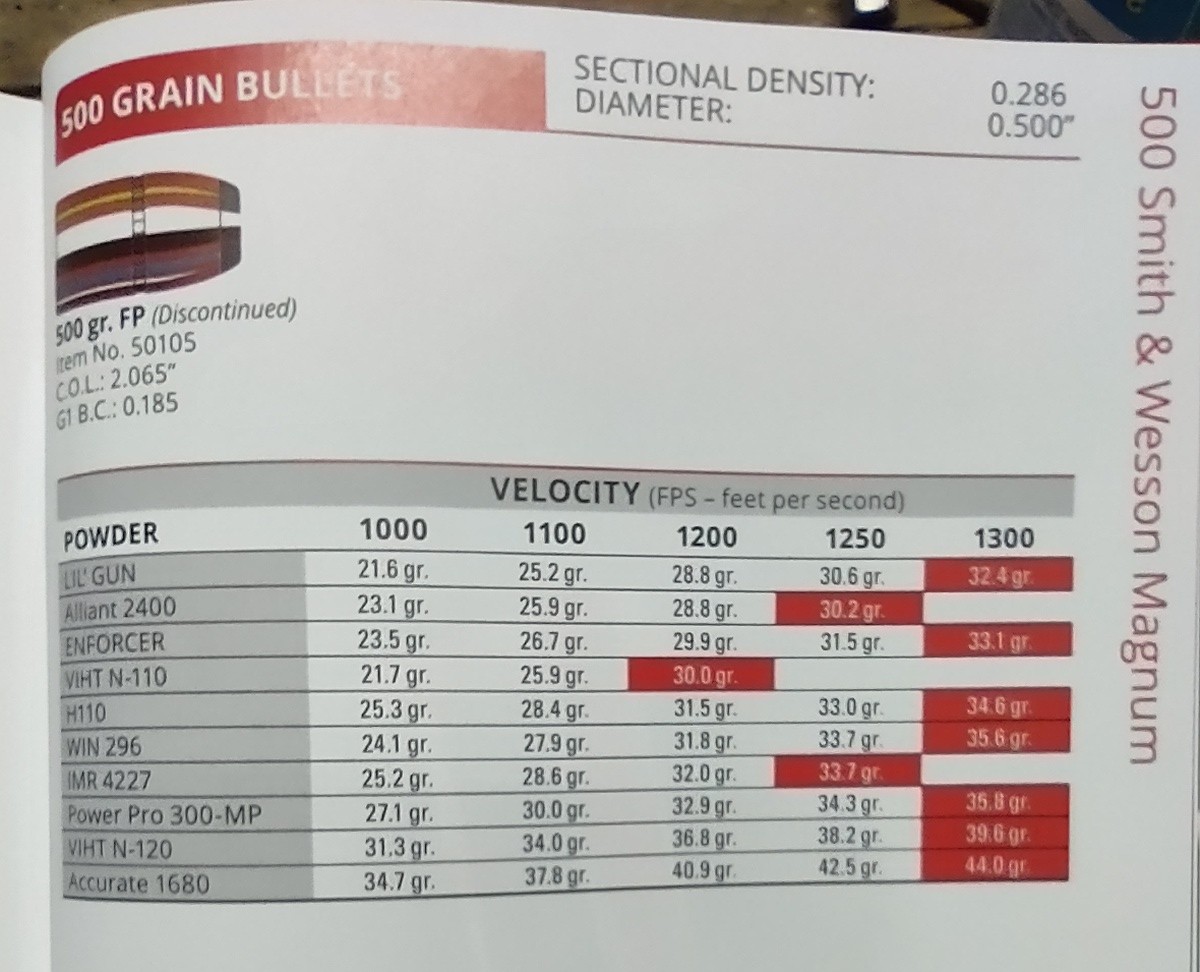

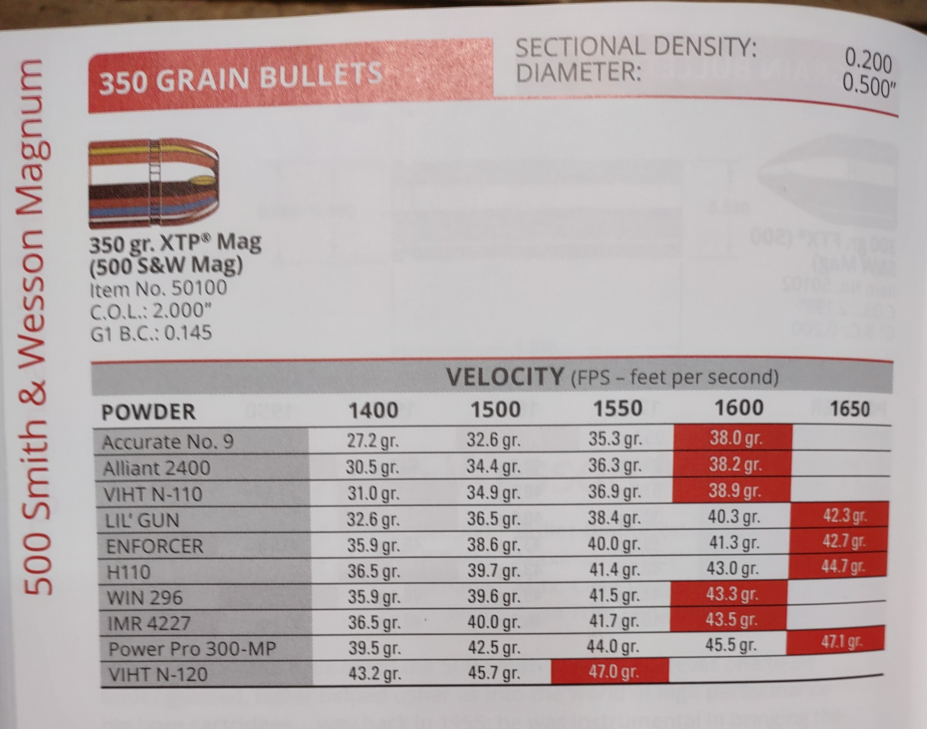

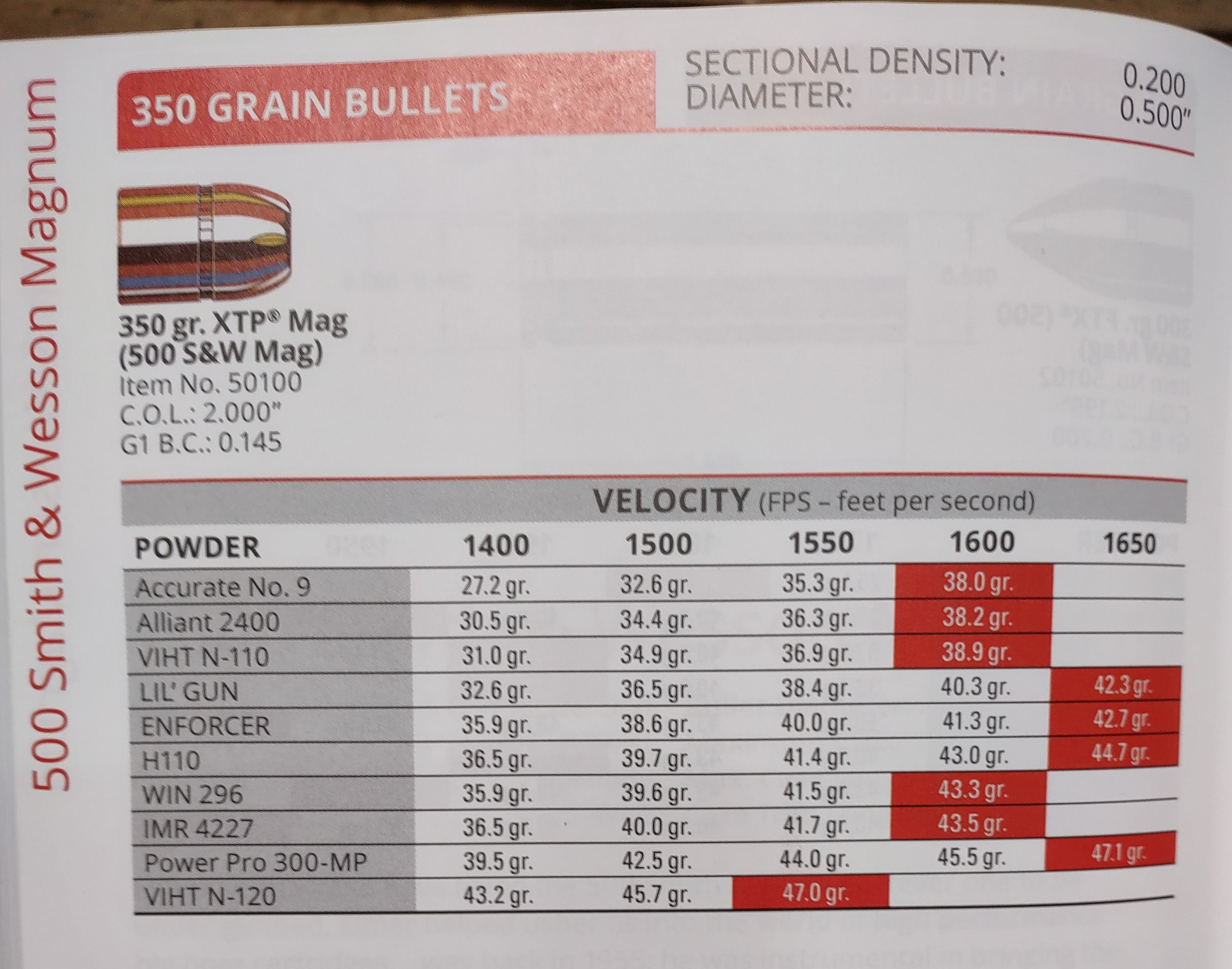

Your sluggish so called "big bore"cartridge pushes a 500gr at a mere 1300 and a 350gr at a mediocre 1650. Sorry bud, ☹️ but as far as big bore's are concerned? It doesn't at all impress me!👎

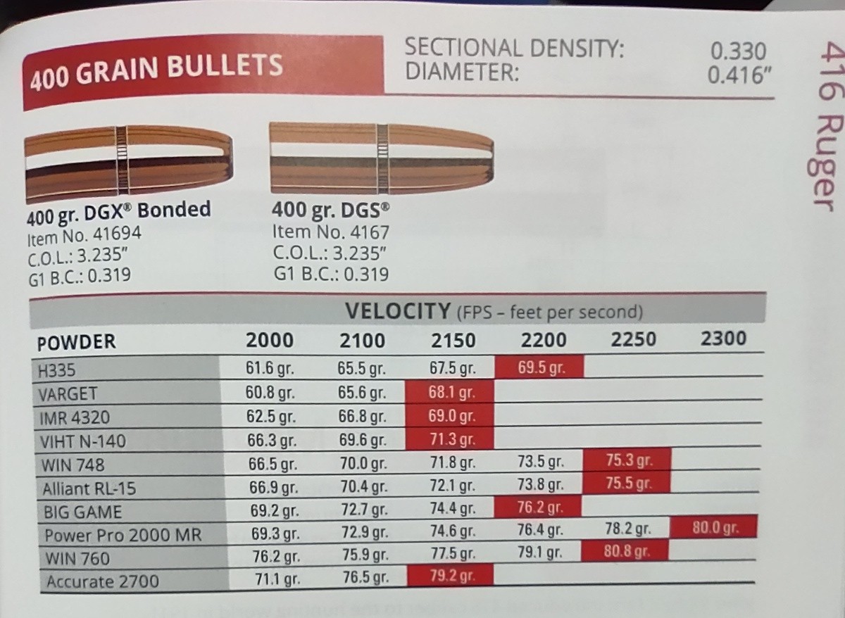

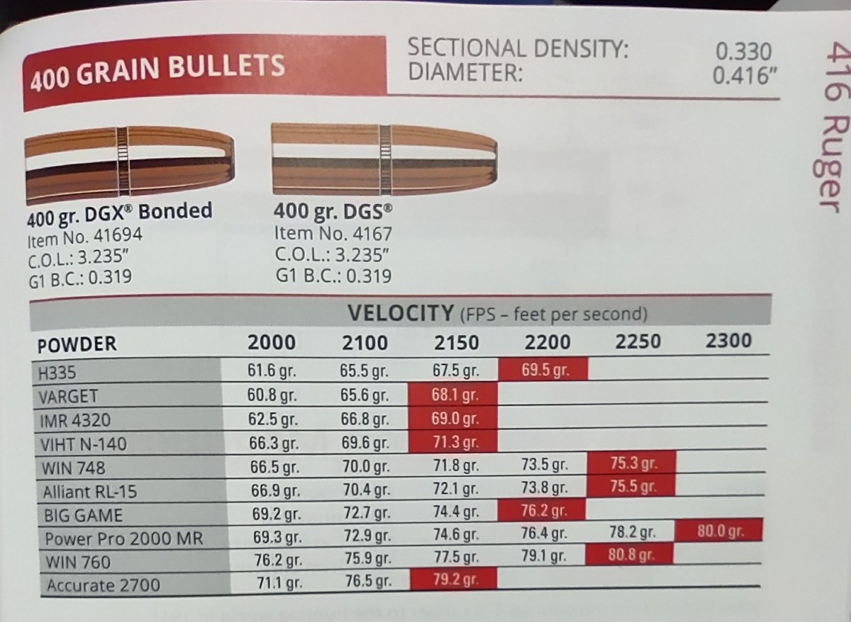

Now this is bad boy boom'n BIG BORE! Pushing a 400gr at 2300 and some other 400 gr loads at over 2400! 350 at 2650!
🤔Just compare powder charges. That says it all!
Hey! If you like it and your comfortable with it? That's all that matters right? 👍 I personally have no use for it. I have a few friends that own the pistol and other than shooting it at paper they have never used it for anything else. Pretty expensive target ammo if you ask me? 😂

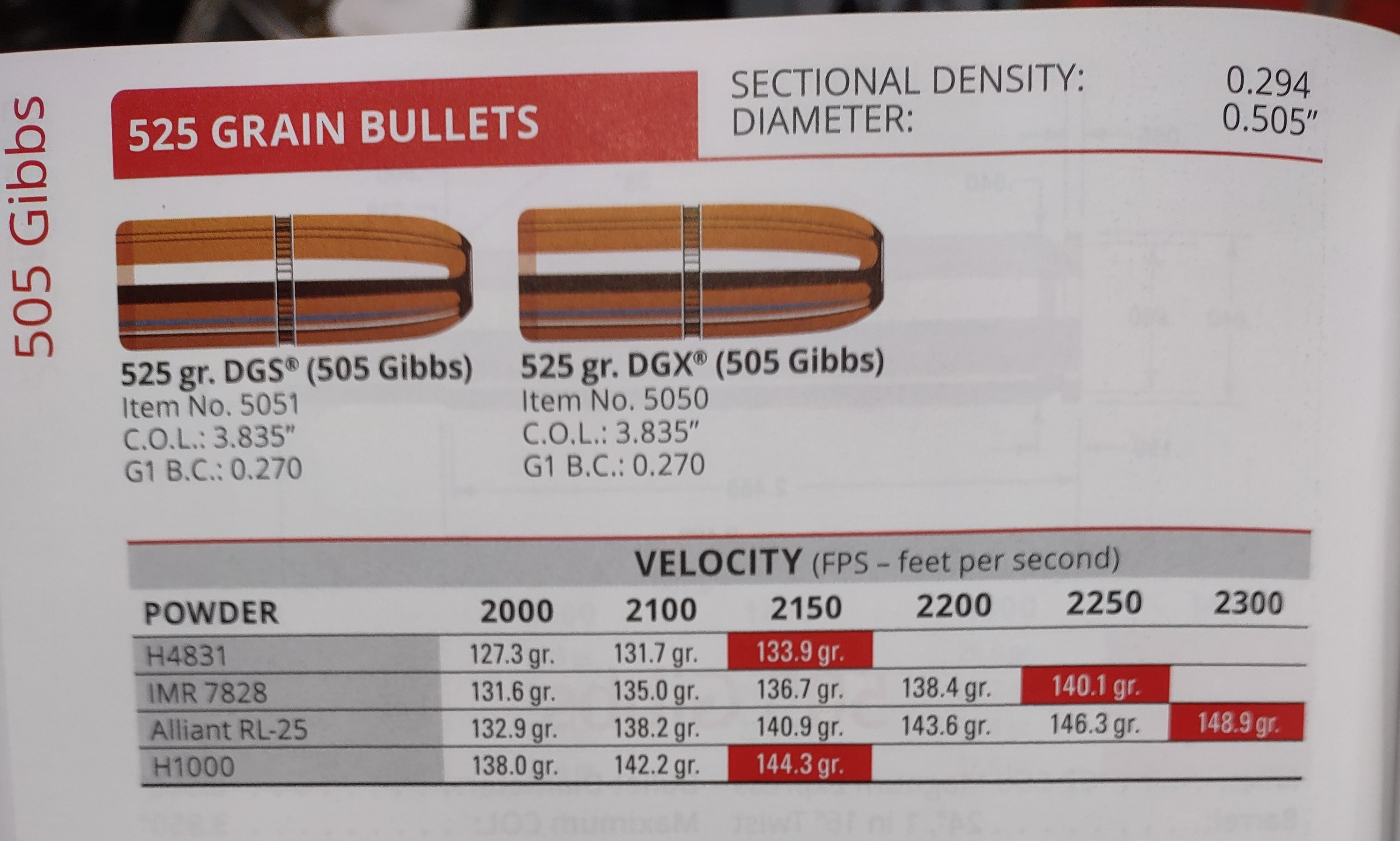

View attachment 27582View attachment 27584
I already posted my load data which is way more potent than your Hornady manual says. In addition I’ve posted the videos with the chronographed evidence. I don’t know how much more proof you need. You should probably go back and read it.
You should also compare apples to apples. If your 500 data is for an 8” and the rifle data you are comparing it to is from a 20”, you aren’t comparing the on equal ground, are you?
As for your charges, you are comparing powder weight of rifle powder vs magnum pistol. Not the same. Also not the same case volume. That also effects your pressure.
