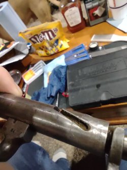

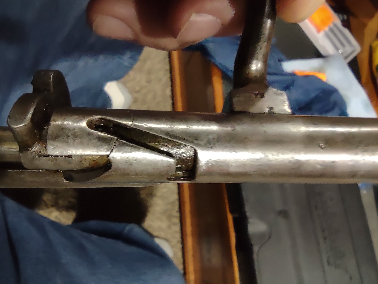

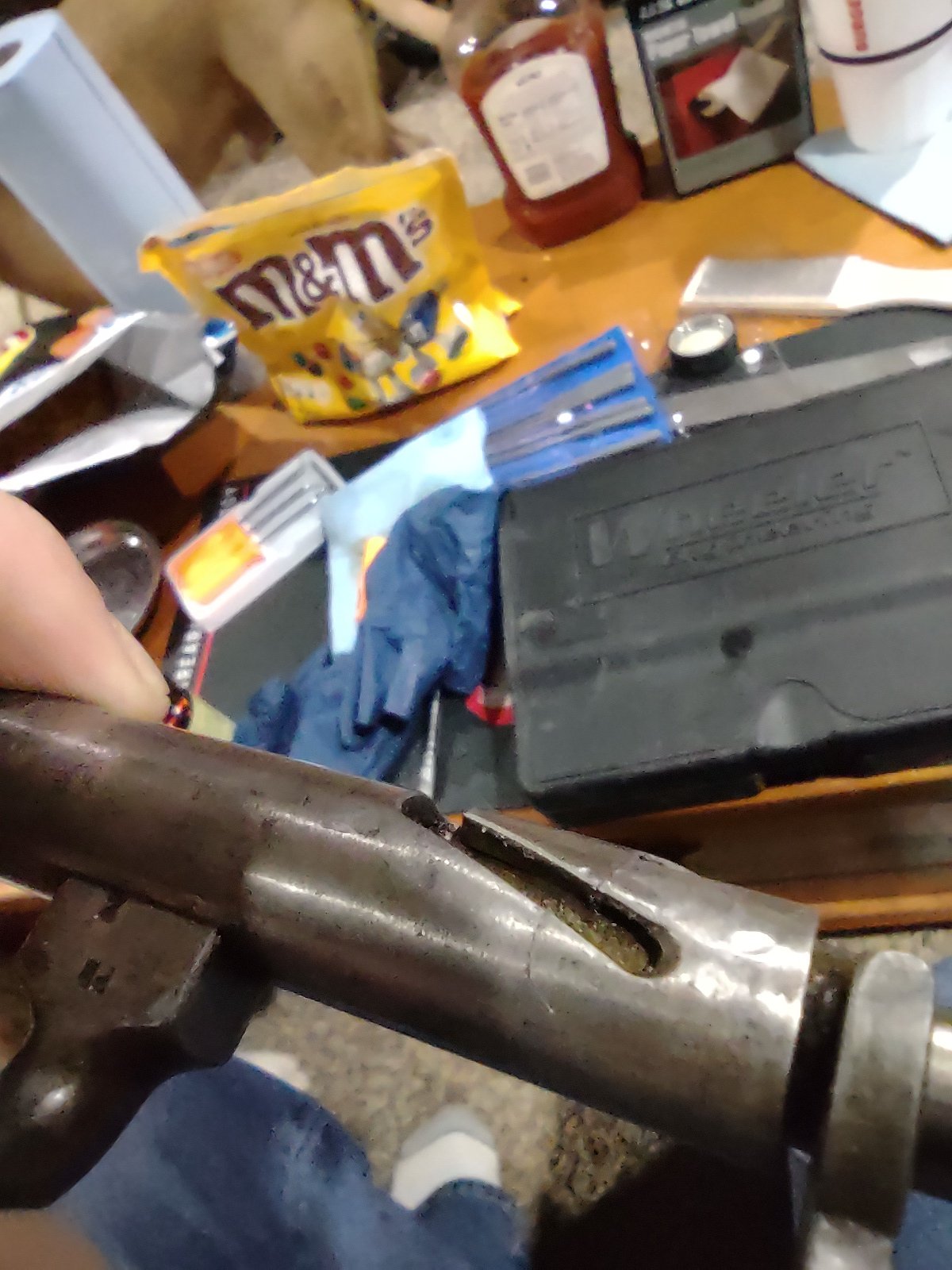

Well..damn! Cracked bolt..

Don't give up. Here's what I found and I'm sure there are others out there:
https://axisarmsonline.com/product/italian-carcano-bolt-complete/
Then there is Sarco and Numrich and ebay.
Look at it as just a minor setback.
This.
Just make sure to get it headspaced when you replace it.
