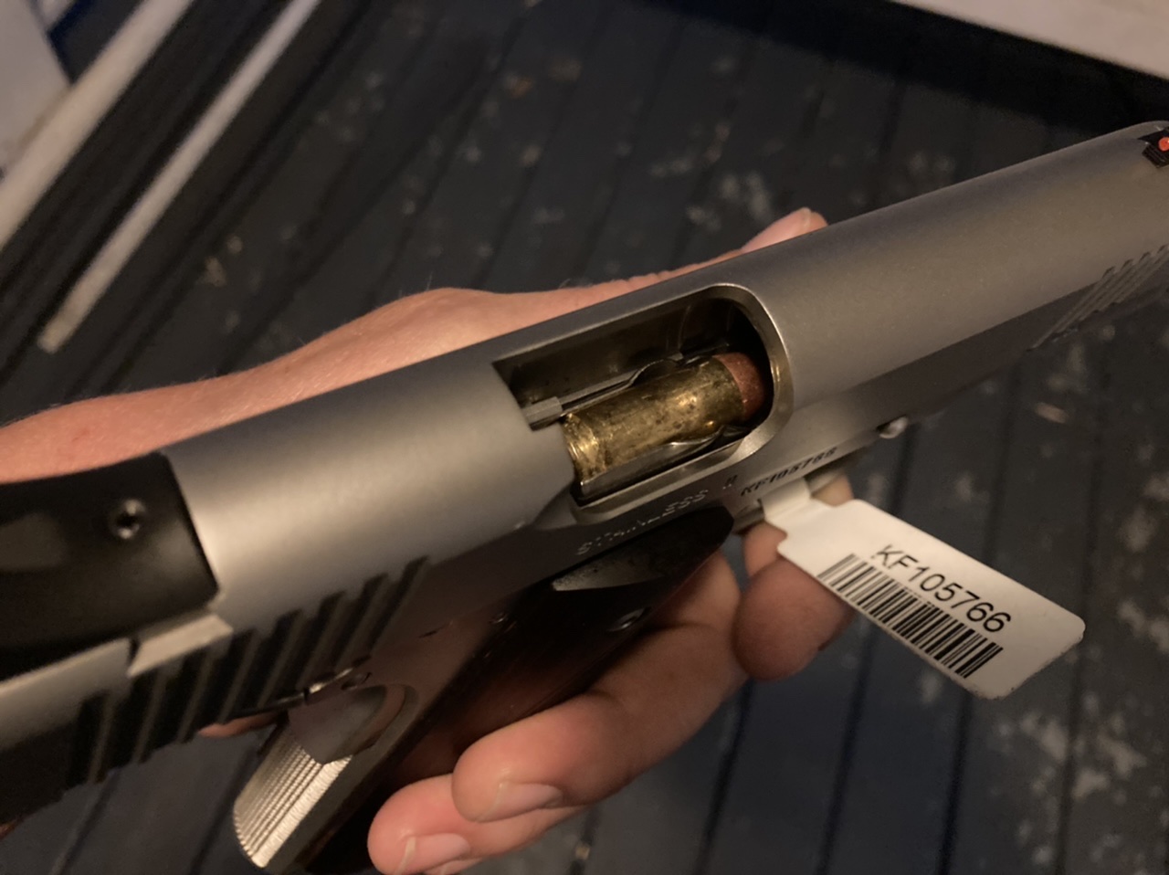

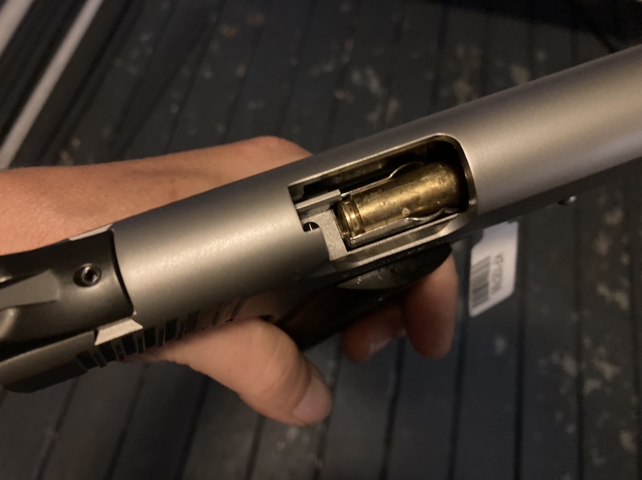

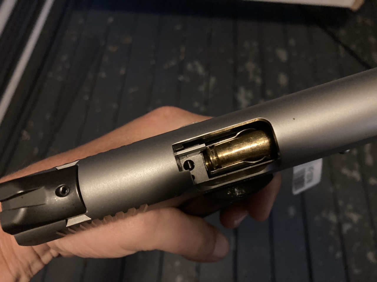

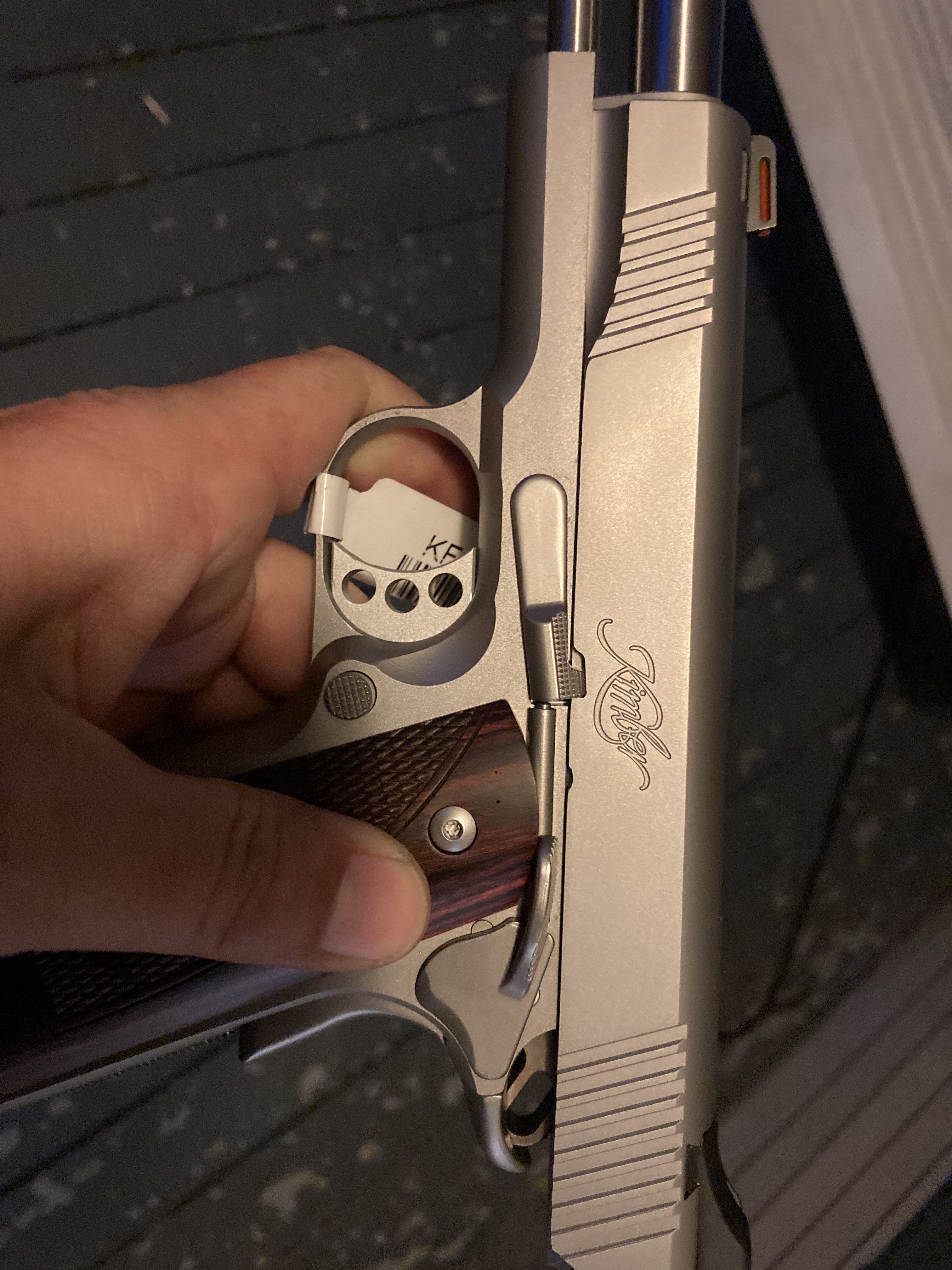

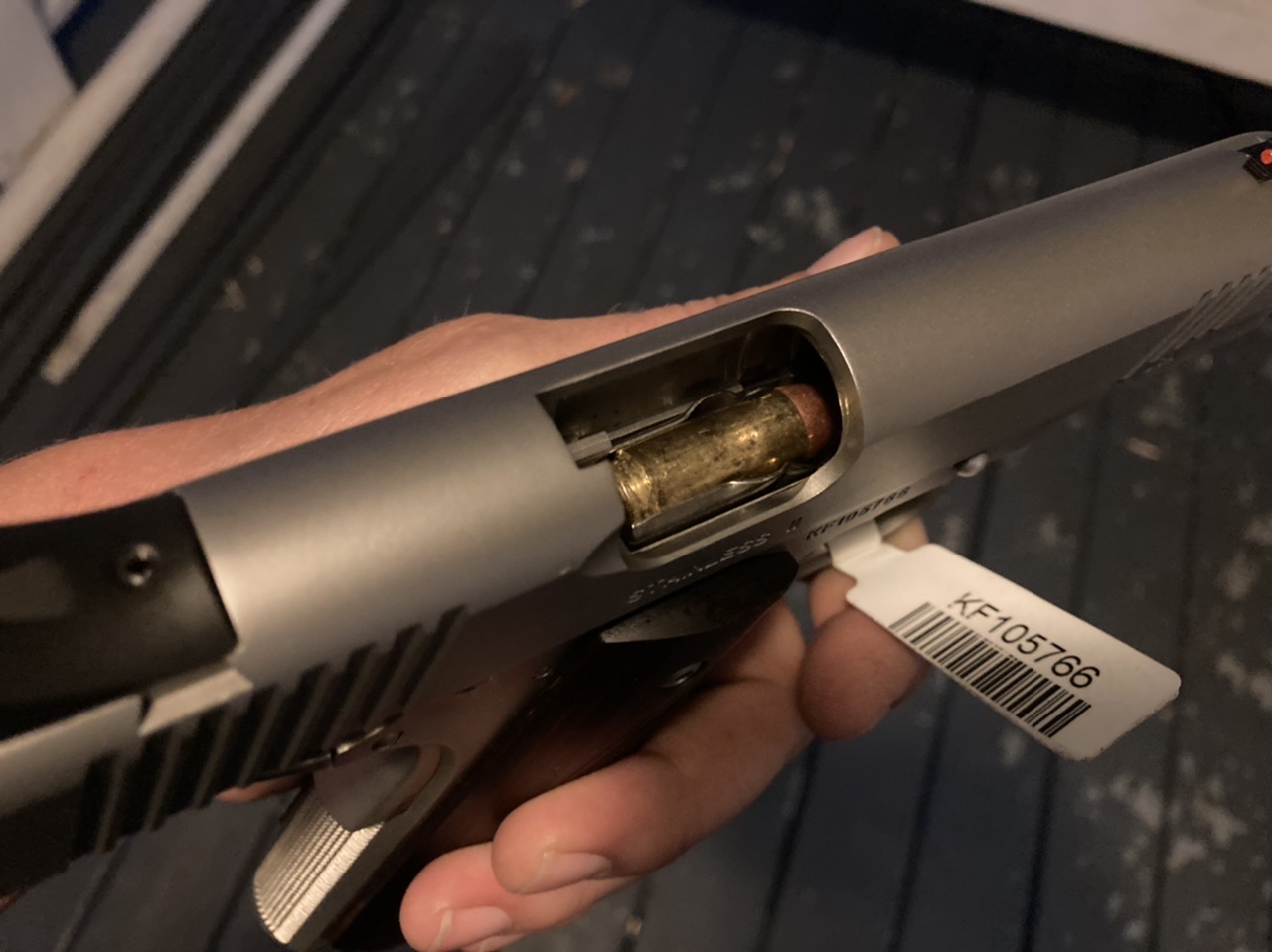

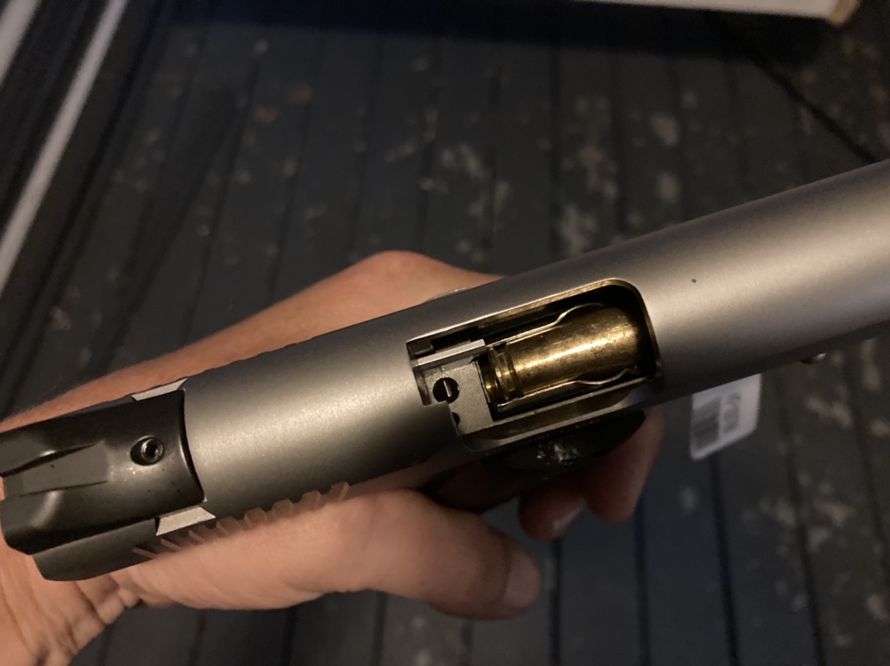

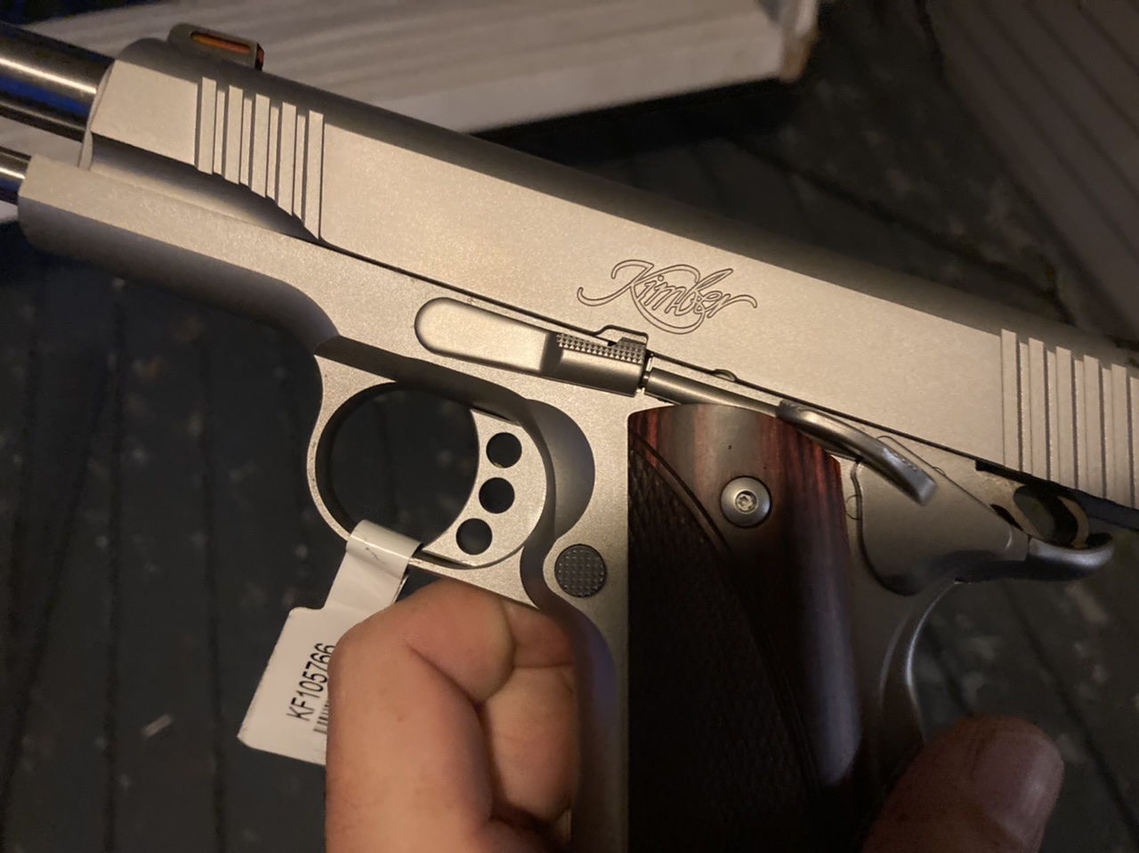

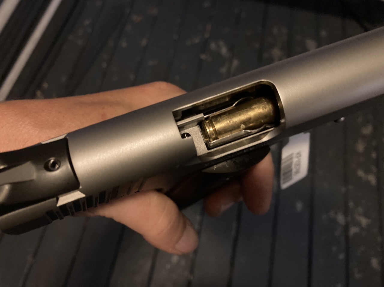

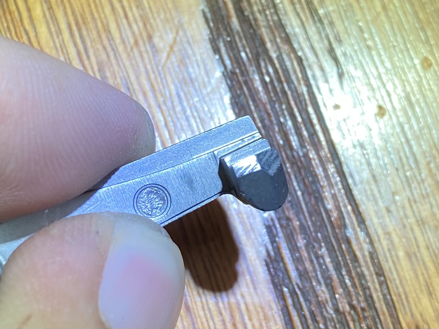

Well, I got to test the Kimber Stainless II 10mm I gave to little brother. It came back from Kimber a little while back but he immediately left on vacation. I picked it up this evening and only had to run one magazine through it to assess it.
There were 3 times the slide locked back mid magazine. It was literally, fire two rounds, slide would lock, rinse and repeat. Rounds 3,5 & 7.
Awesome right?
Good news is that it doesn’t ftf in the traditional sense anymore.

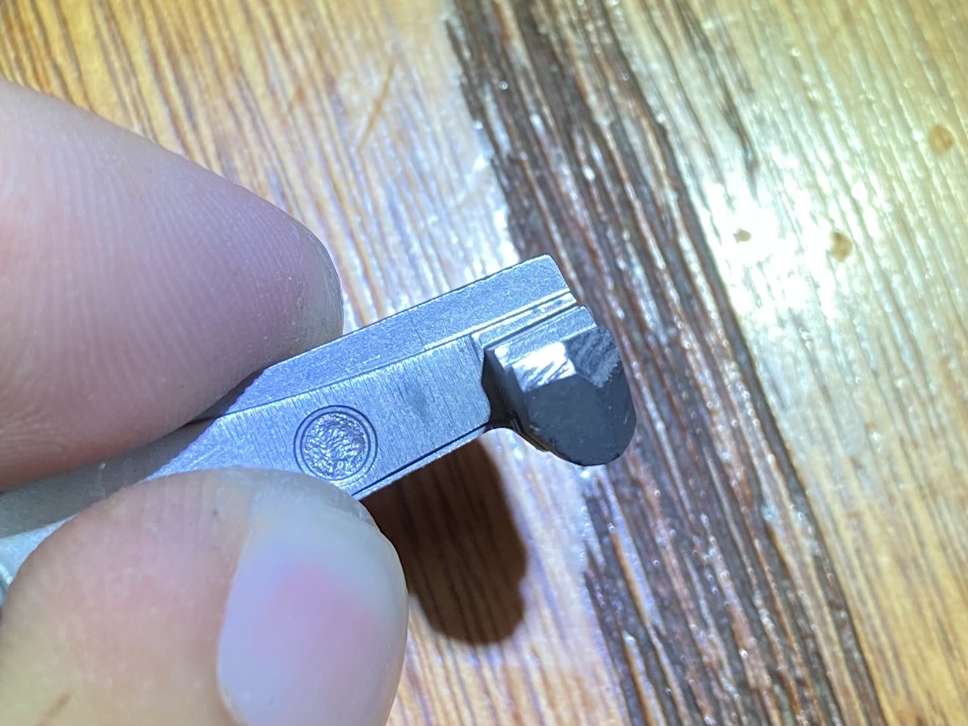

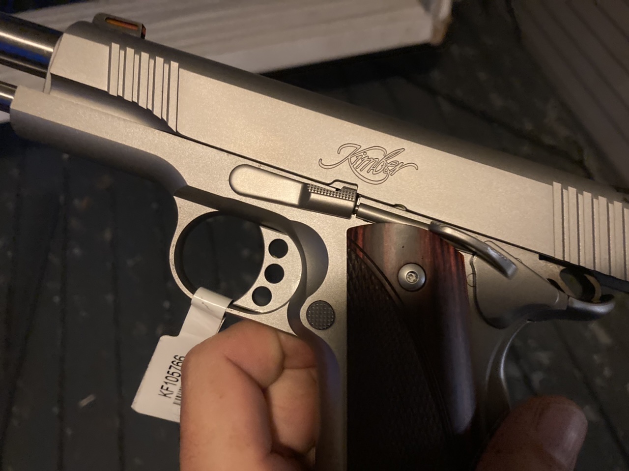

After fiddle farting around with it for a little while, I called little brother and got his permission to just fix it and get it over with. Problem was, if the rounds were forward in the mag, i.e. load your mag in a hurry, drop it or in this case, just the friction of stripping the round above it will send the next round forward to the front of the mag. The rounds would then engage the slide stop and lock it open.
Fix was to file the slide stop. You can see the two side in this pic that had to be filed.
I can now tap the mag on the table, sending all the rounds forward in the mag and it operates as it should. Why this wasn’t addressed, or addressed in the previous one I sent in twice, I have no idea.
Just makes me sad.

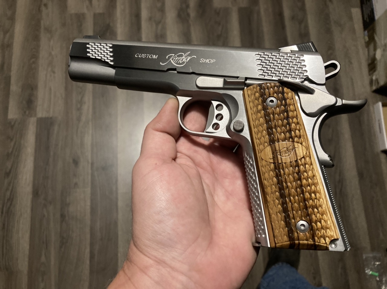

Sooo. The Springfield Loaded I was waiting on wasn’t up to my standards. Was obviously used quite a bit in one if those kydex holsters. Wore the crap out of it. Some pretty deep abrasions that I could probably fix but for what I paid, we’ll see what the auction brings, so I left it with them.

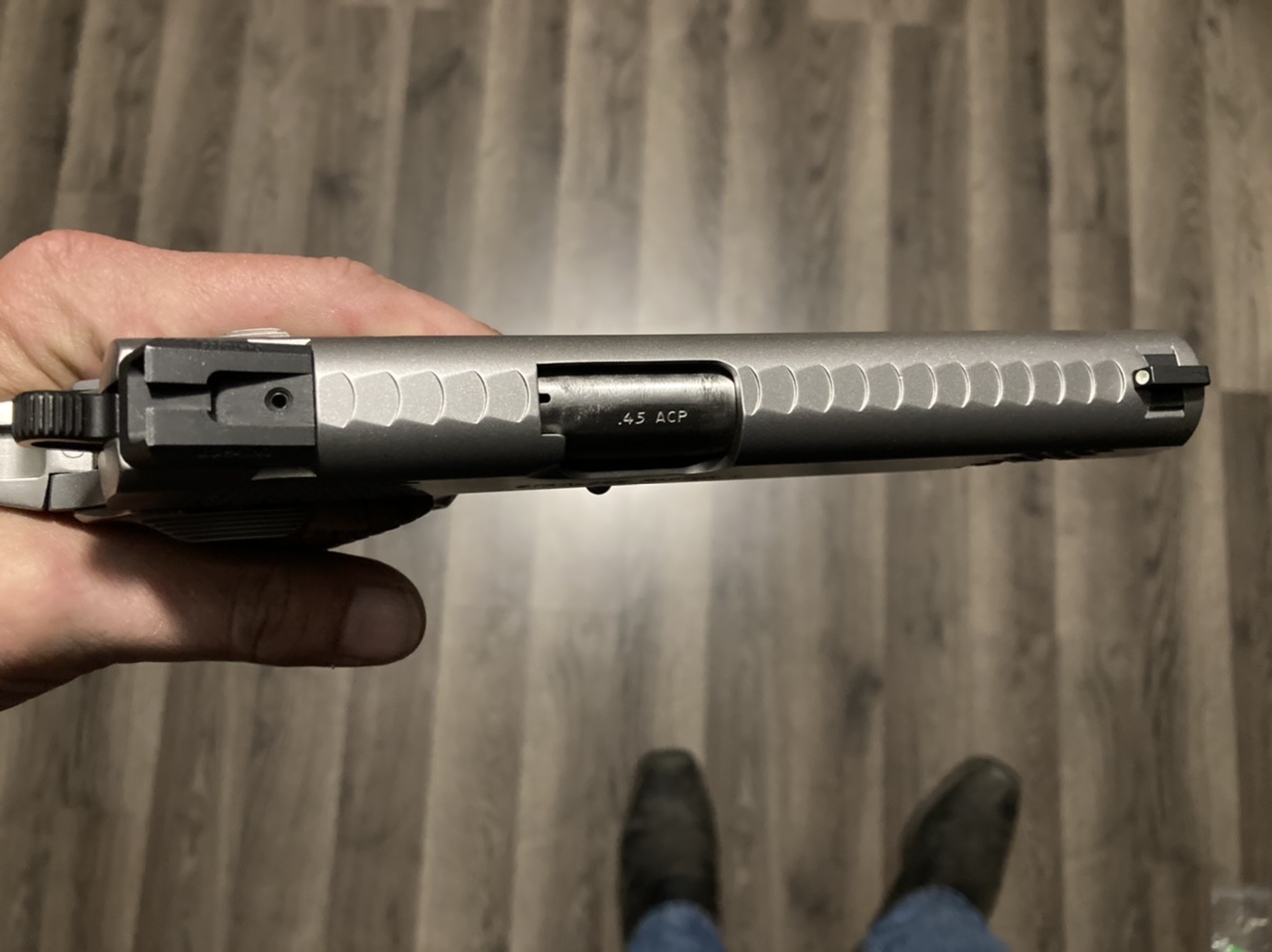

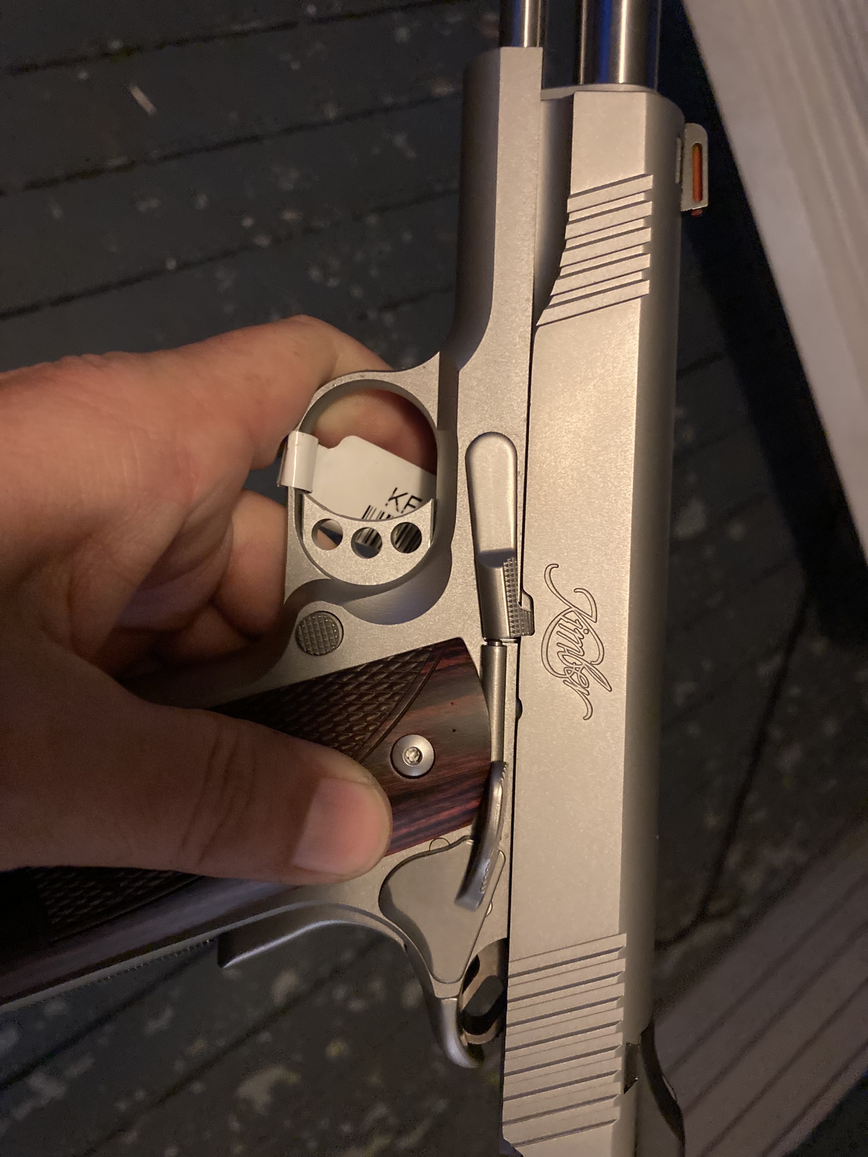

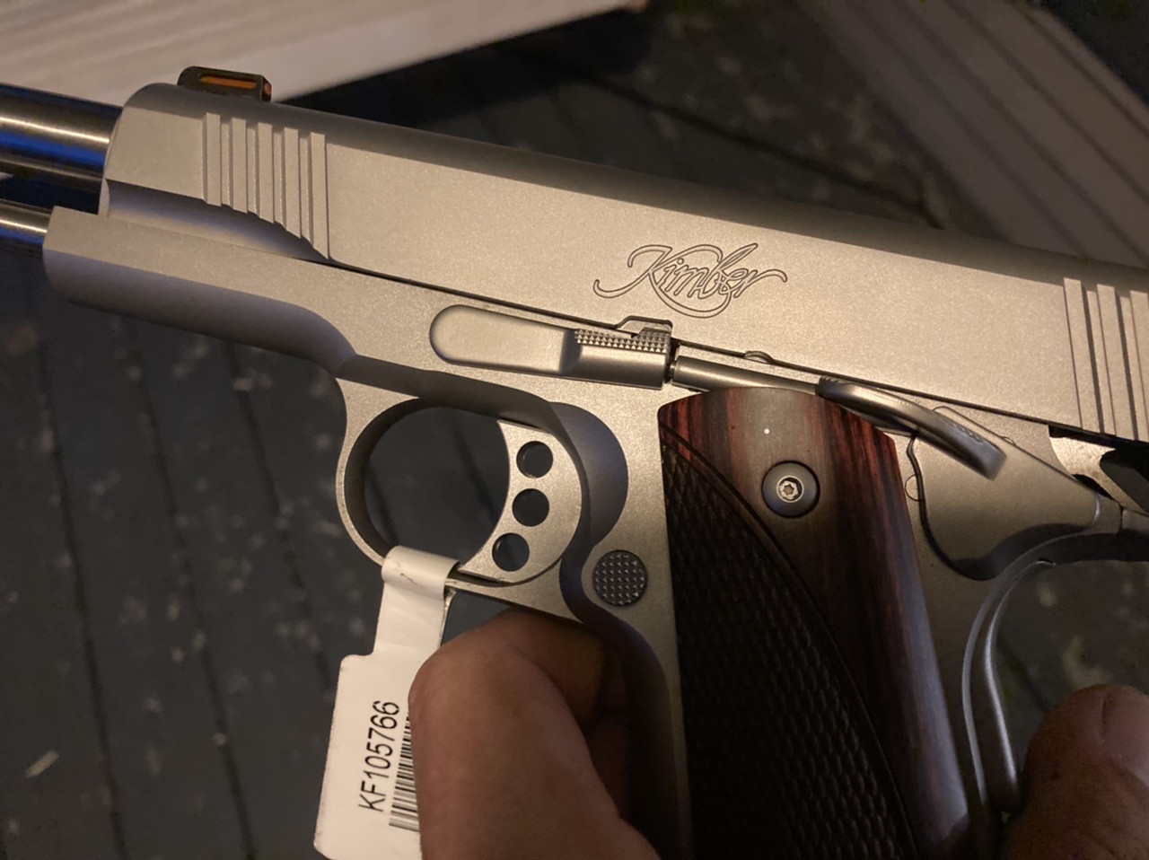

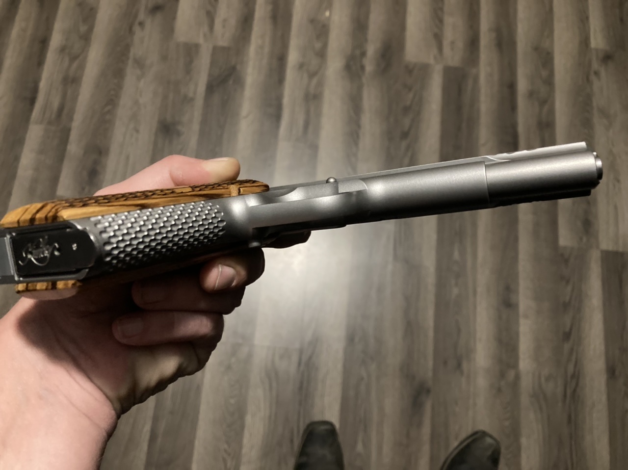

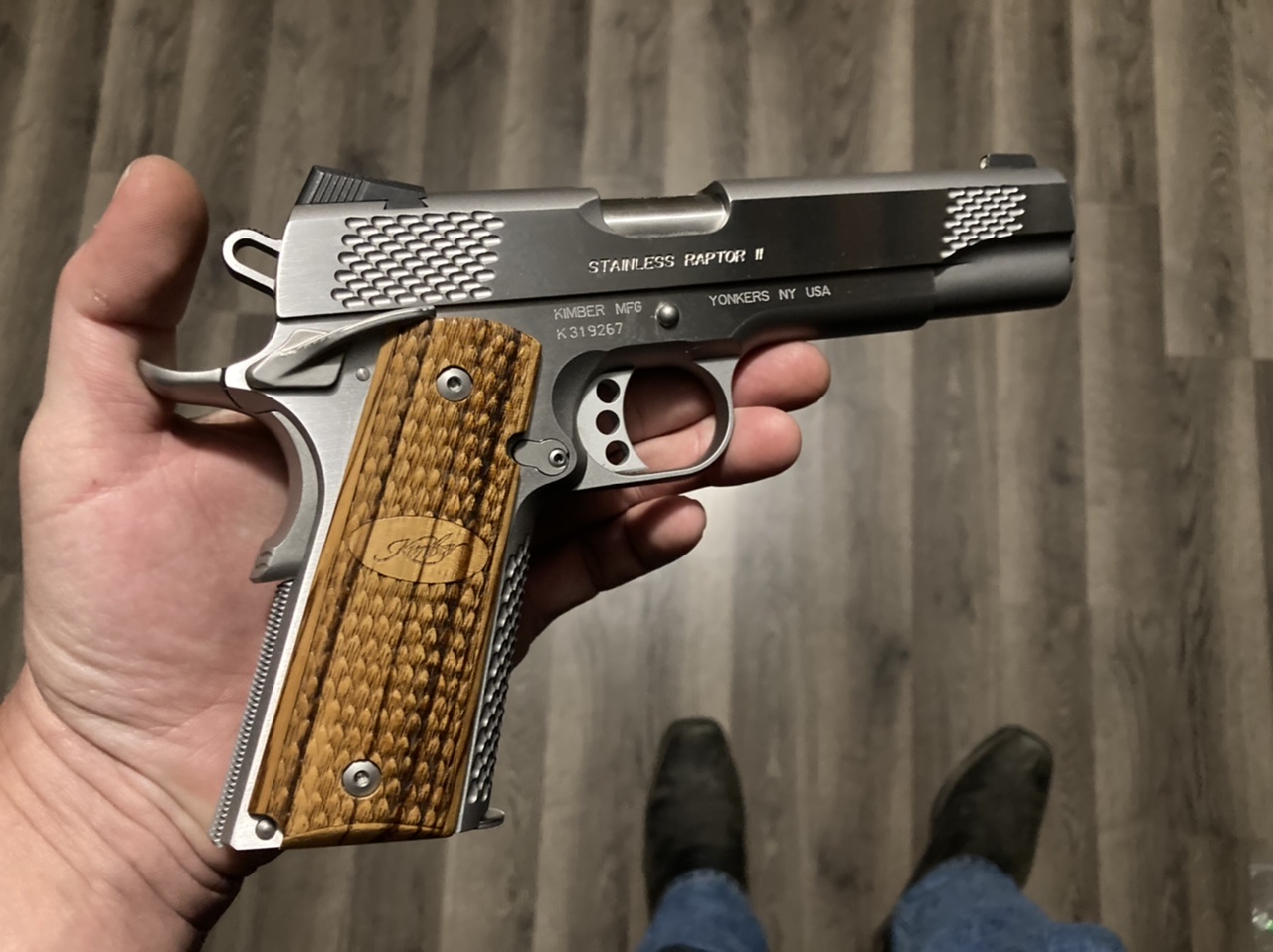

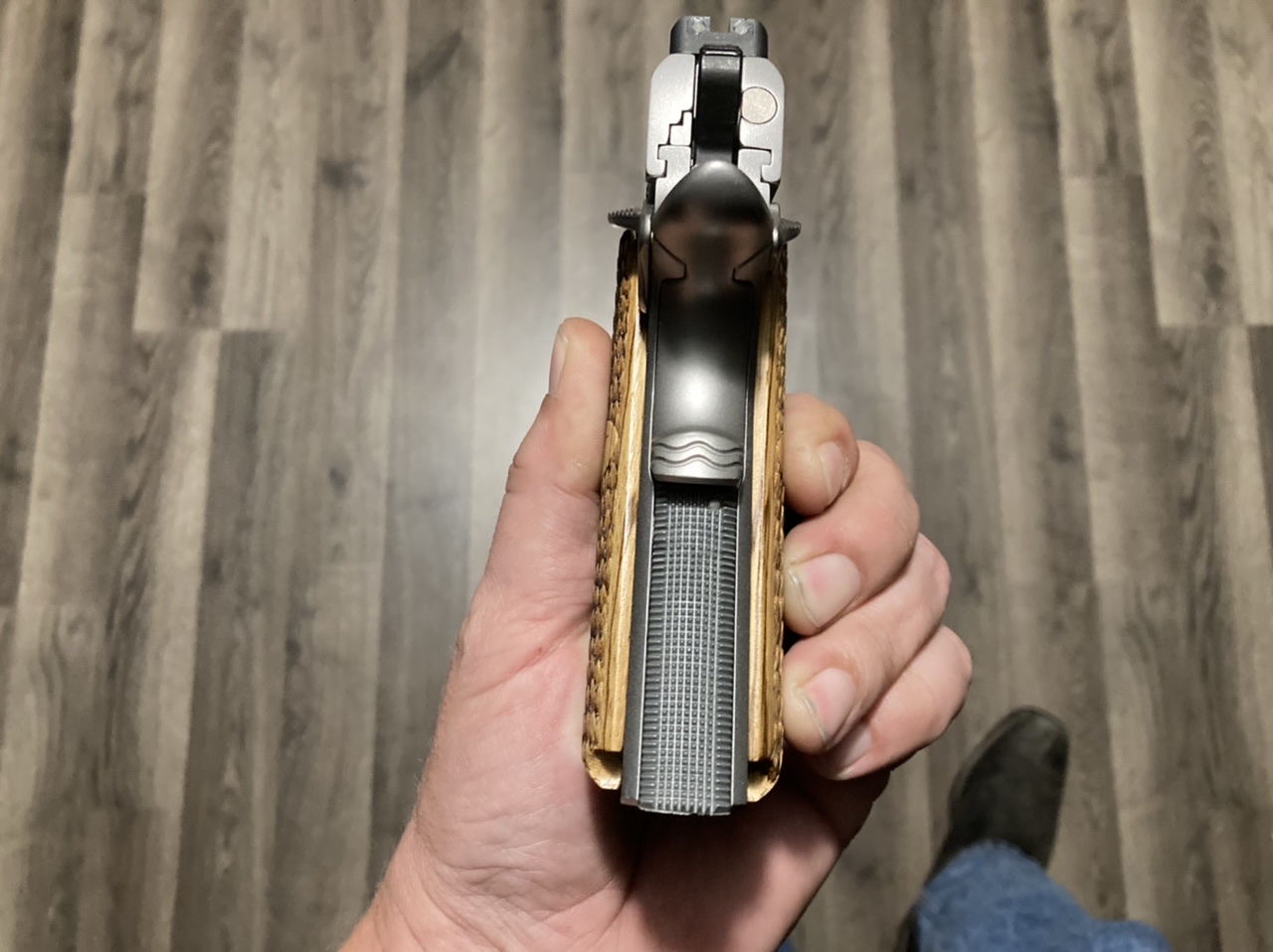

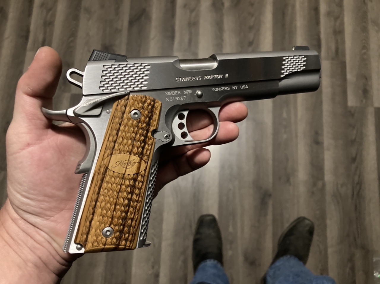

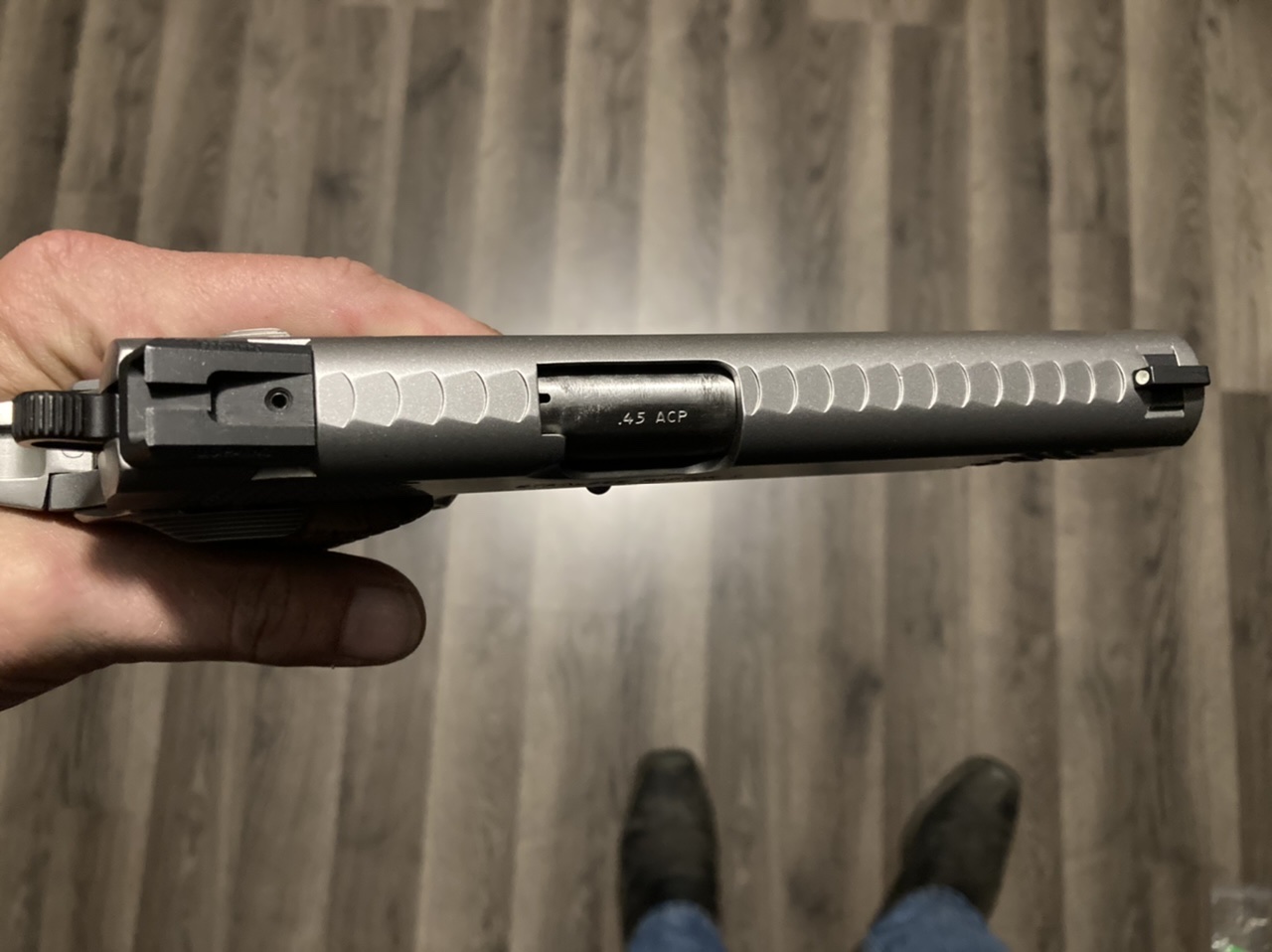

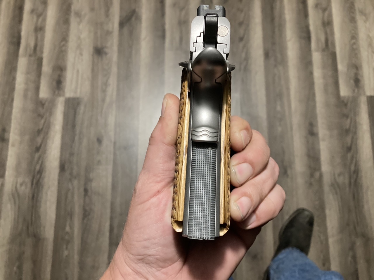

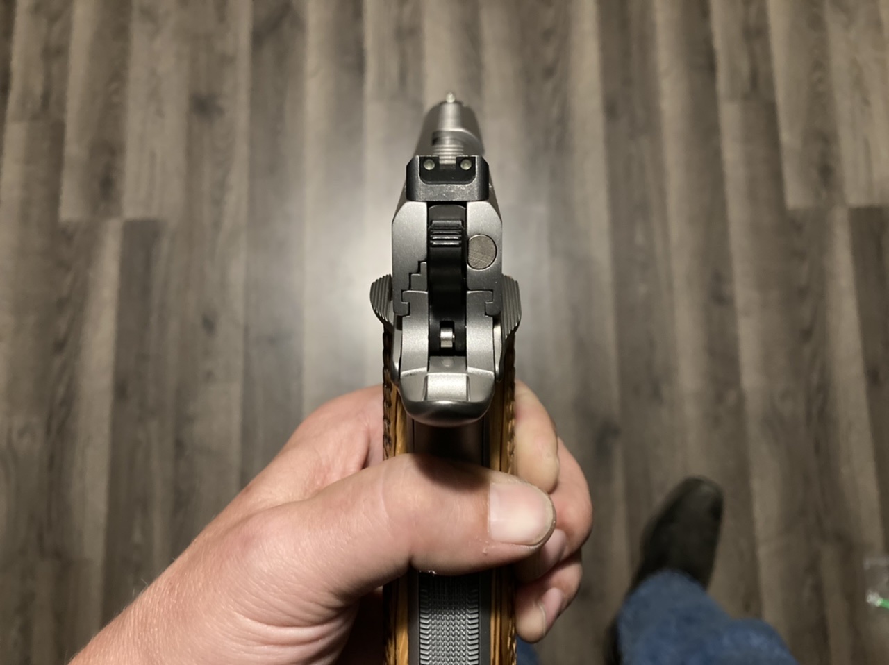

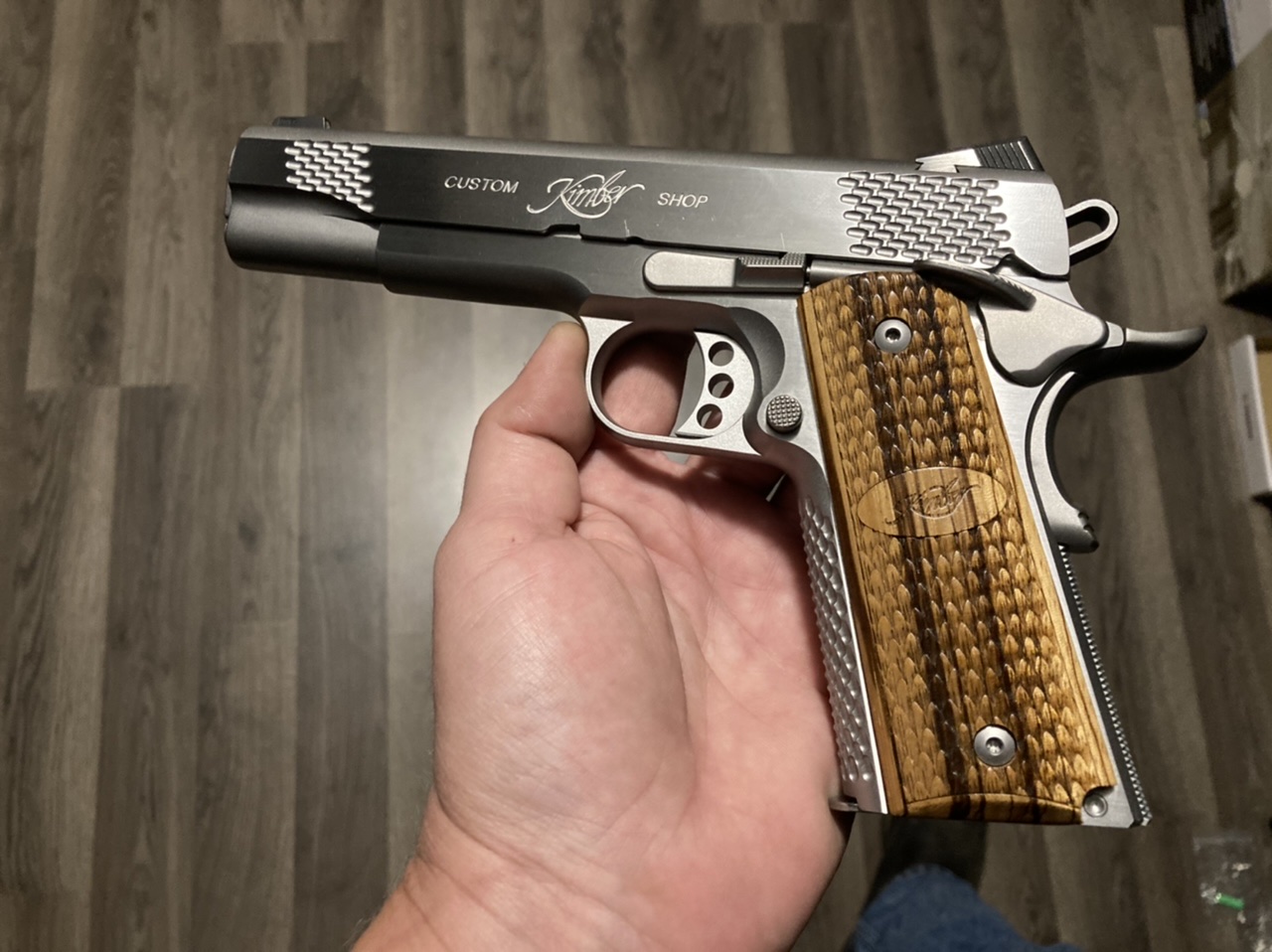

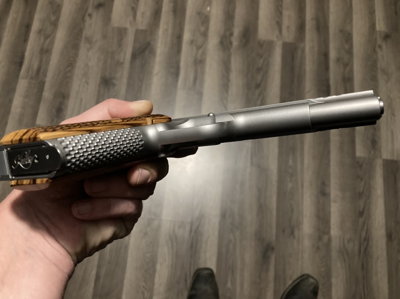

So for the final (and unexpected) entry into the Kimber vs Springfield saga, I received the Kimber Stainless Raptor II in 45 ACP. Wow that’s a nice gun. I’ve handled on in the gun shop before but not to the extent I did today. This one was used, however, not by much. It did have a hairline idiot scratch which probably won’t even show in the pics. Has two hairline scratches in the slide which are very light. It’s otherwise immaculate.
While I did not get to take the very first shots, I can say with complete confidence, the mag I just ran through it wasn’t far from the first. The feed ramp hadn’t even been scuffed yet. 230gr PPU range line ammo ran perfectly. The fit and finish are perfect. Trigger is light and crisp. In fact, the only downside to this gun that I can tell is the plastic main spring housing, which is a $35 fix off eBay.
The proprietary scale serrations on the slide and front strap are surprisingly very crisp and give you a very good grasp. That’s good because drawing the slide on this one is probably the heaviest draw of any 1911 I own, but it’s smooth. The scaled top of the slide is a nice touch. Does look cool.
The final note on the finish, no paint! That puts it at least 1 tier above the Rapide. Yeah, the Rapide has cool slide cutouts, colored barrels and flared magwell, but it’s 50% painted with Kimber’s Kimpro finish. It will fail at some point. The Raptor appears to be all stainless (except the MSH).
In my opinion, this is the nicest of the 11 1911’s reviewed so far. I just wish Kimber had a warranty service that matched it.
Edit: I did forget to mention that the Raptor II does have tritium inserts in the sights, which is also a nice touch.
Awesome right?
Just makes me sad.
I believe Wilson Combat sells 1911 slide stops that are ground like that.
