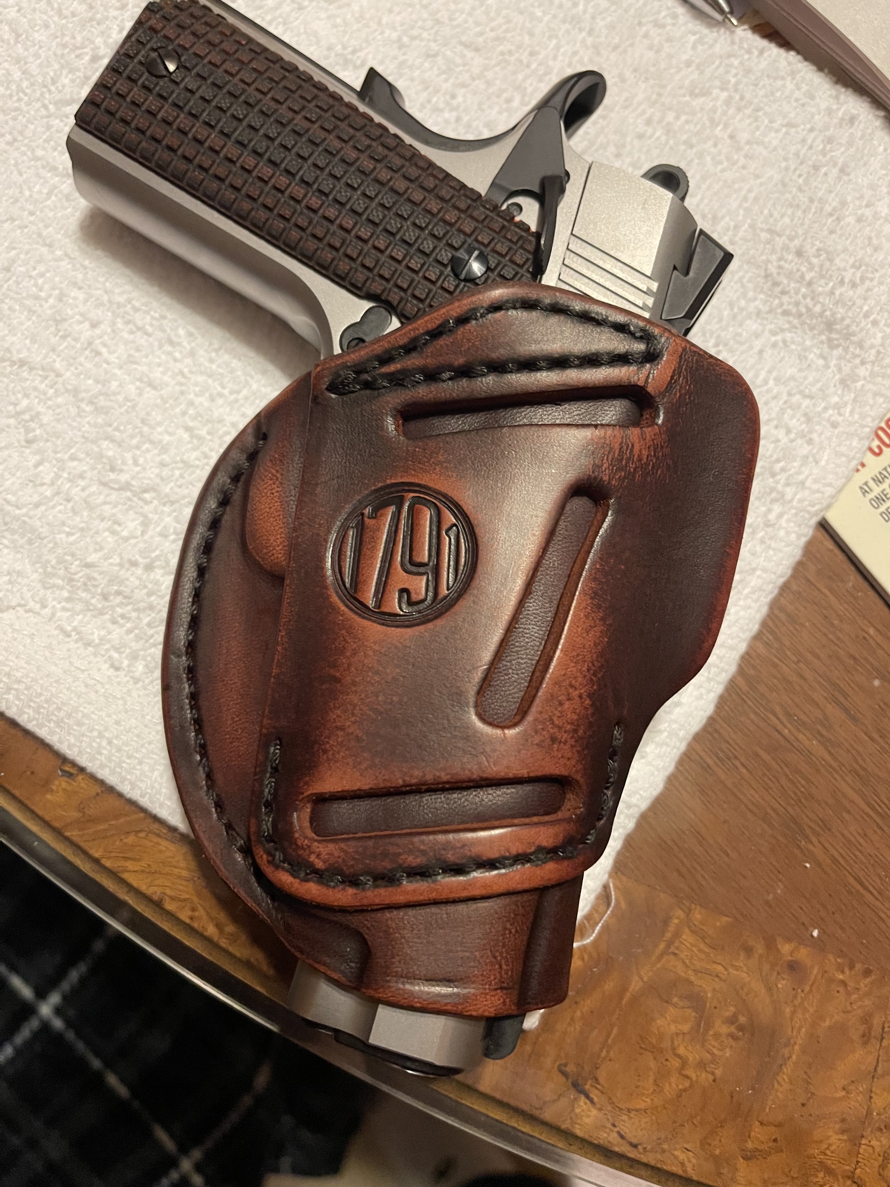

I just started carrying my new 1911. The holster I bought is a leather one with a thumb strap. Everything is still tight and when I attempt to button it, the manual thumb safety will sometimes come disengaged. I can sort maneuver back to safety with the thumb strap engaged. I'm a bit apprehensive about carrying it with one in the chamber until I'm a little more comfortable. Mostly a psychological thing I believe. I have zero issues carrying my hellcat and Glock (both striker fire) but this is a new gun to me.
So my question is that thumb safety concern an issue if I carry it red? (One in the chamber, hammer to the rear) The grip safety seems mechanically sound.
My other question is also holster related. In this case, I've heard of western folks, Buffalo Bill in particular, talk about covering the inside of their holsters with wax to make drawing easier. Does anyone do this?

2) I have a 1791 holster for my 1911 and noticed that thumb safety issue. Snapping the strap shut with the hammer pulled back at least has the strap in the way of the hammer, should it fall. (As shown in your pic).
But I gotta say, I’m uneasy with it. You’ll just have to consider all options: nothing in the chamber, strap between hammer & slide, or hammer down with strap behind the hammer.

This old thread on the 1911Forums has some great information from a couple of noted holster-makers: https://www.1911forum.com/threads/help-my-thumbbreak-holster-snaps-my-safety-off.62452/ - Matt Del Fatti and Tony Kanaley, for instance, both contributed to that thread.
If your holster is indeed properly designed for cocked-and-locked carry (and note that there are 1911-specific holsters which are designed for hammer-down carry), your current issue now, @Wannabewoodsman , should resolve after proper break-in of the holster.
That said, as both of those noted gentlemen pointed out in that thread, because of the variations specific to the 1911 platform, the fitting of even a properly designed thumb-break can be problematic. Changing the thumb safety to a different OE option or an aftermarket solution may or may not improve compatibility. Alternatively, you can contact the holster maker, to see if they can tweak the fit or otherwise make-right (as you can see Kanaley offering to do so, in that cited thread).

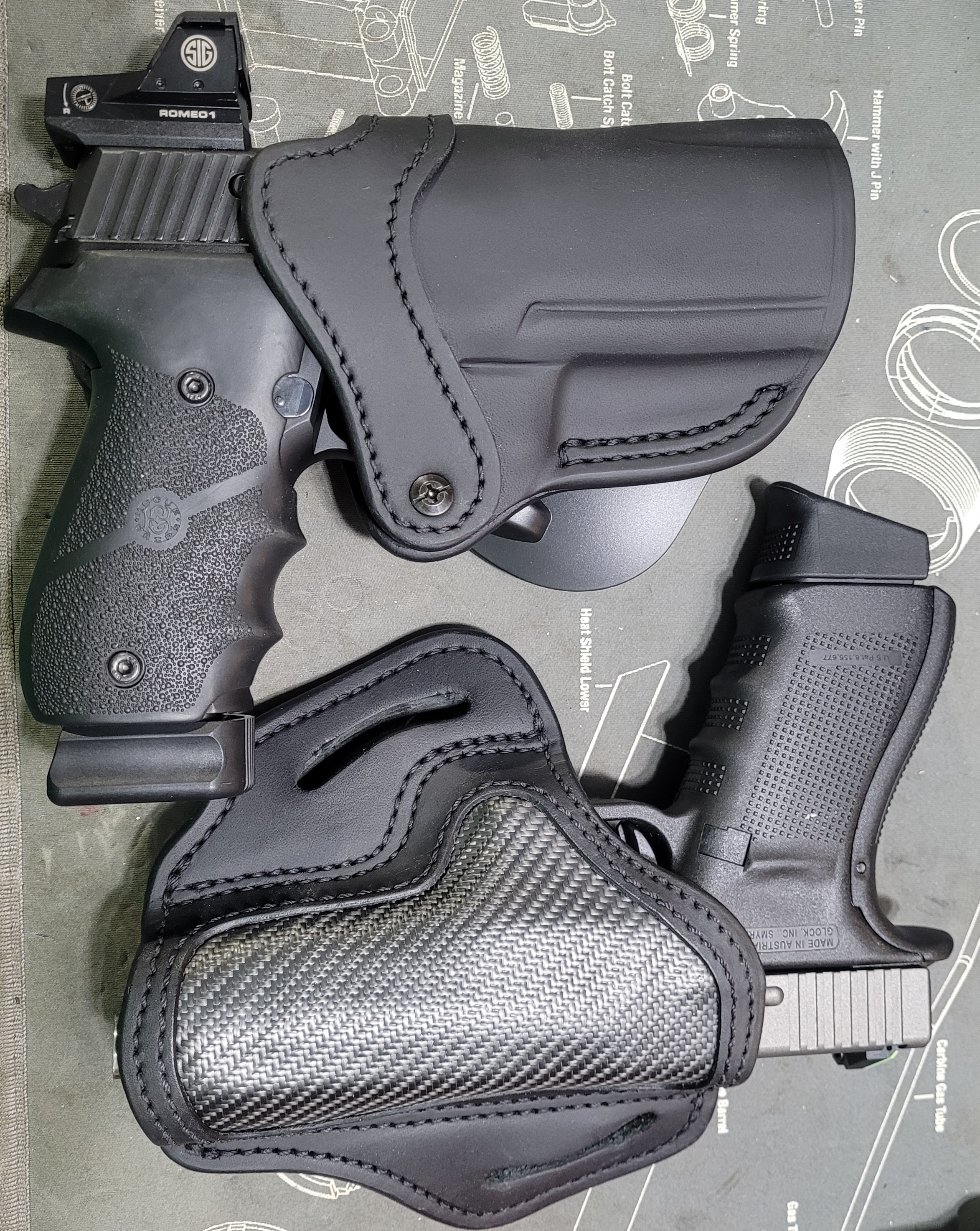

I really like the 1791 holsters, but my last 2 holsters have been lock leather holsters. High quality, great fit, comfortable IWB and has a 'locking mechanism' inside the holster. I have tried to shake out my 1911 4" and cannot, yet after just a few practice draws, I cannot really even feel the lock. Its a smooth easy draw while keeping the pistol secure. The tension locking mechanism has a screw adjustment so its easy to get it right where you want it to be. I have 9 different holsters some leather, some kydex, some hybrid. The lock leather is my go to ATM. I do like my kydex IWB for my 3" Taurus.
