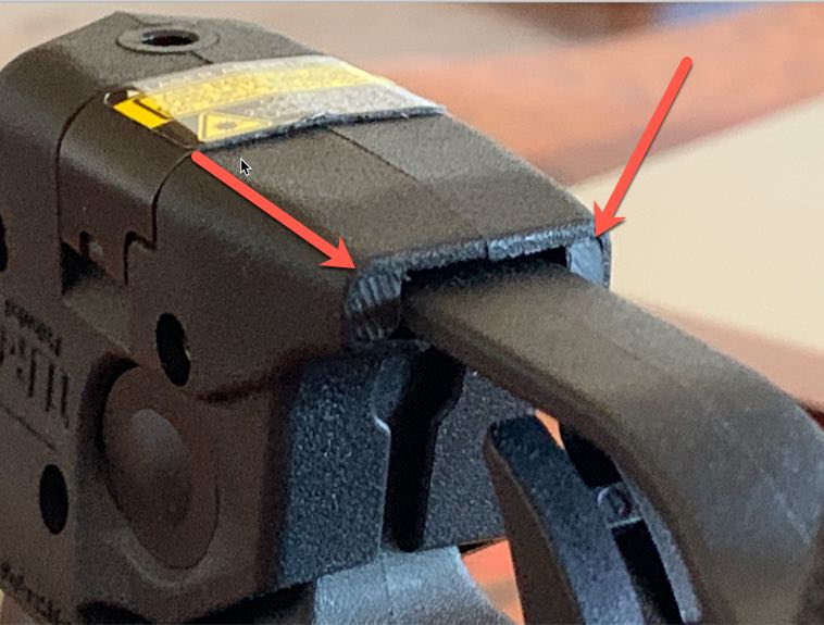

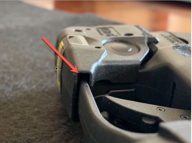

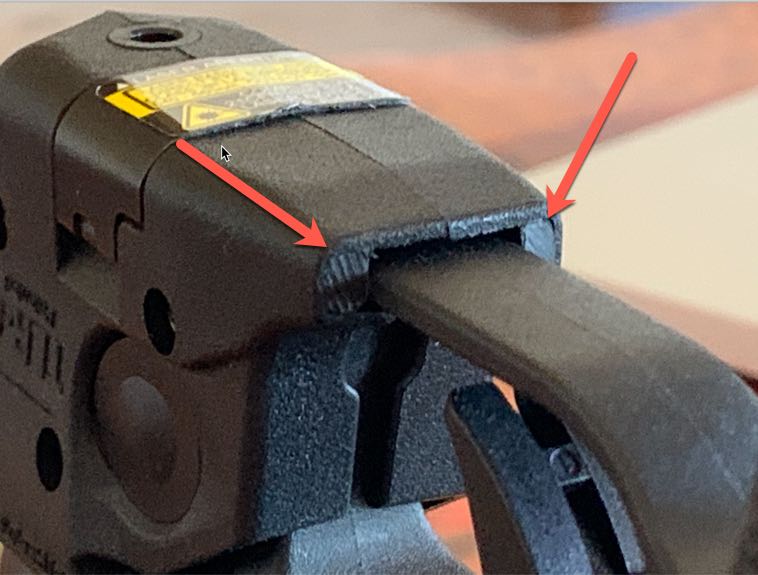

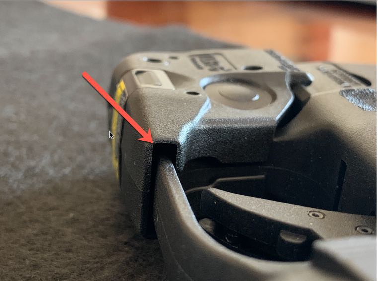

Wanted to chime in here since there is not a lot of info out there or exactly what works and what doesn't on the Hellcat. I have a Hellcat OSP and just fit a TLR-6 onto it. While the TLR-6 will mount on the rail and wrap around the trigger guard, the trigger guard of the Hellcat is too narrow and you get side-to-side movement of the TLR-6. I ended up fabricating some small plastic inserts to take up the slack and now it's rock solid and seems to hold zero just fine.
I also have a Viridian CL-5 that I tried to fit and it did not grip the rail well so as much as I like the CL-5, the TLR-6 is a MUCH better fit for the Hellcat.
Before
After

Hey, just curious, how did you make those little plastic pieces?
EDIT: never mind, just saw your post about the tent stakes. Gotcha.

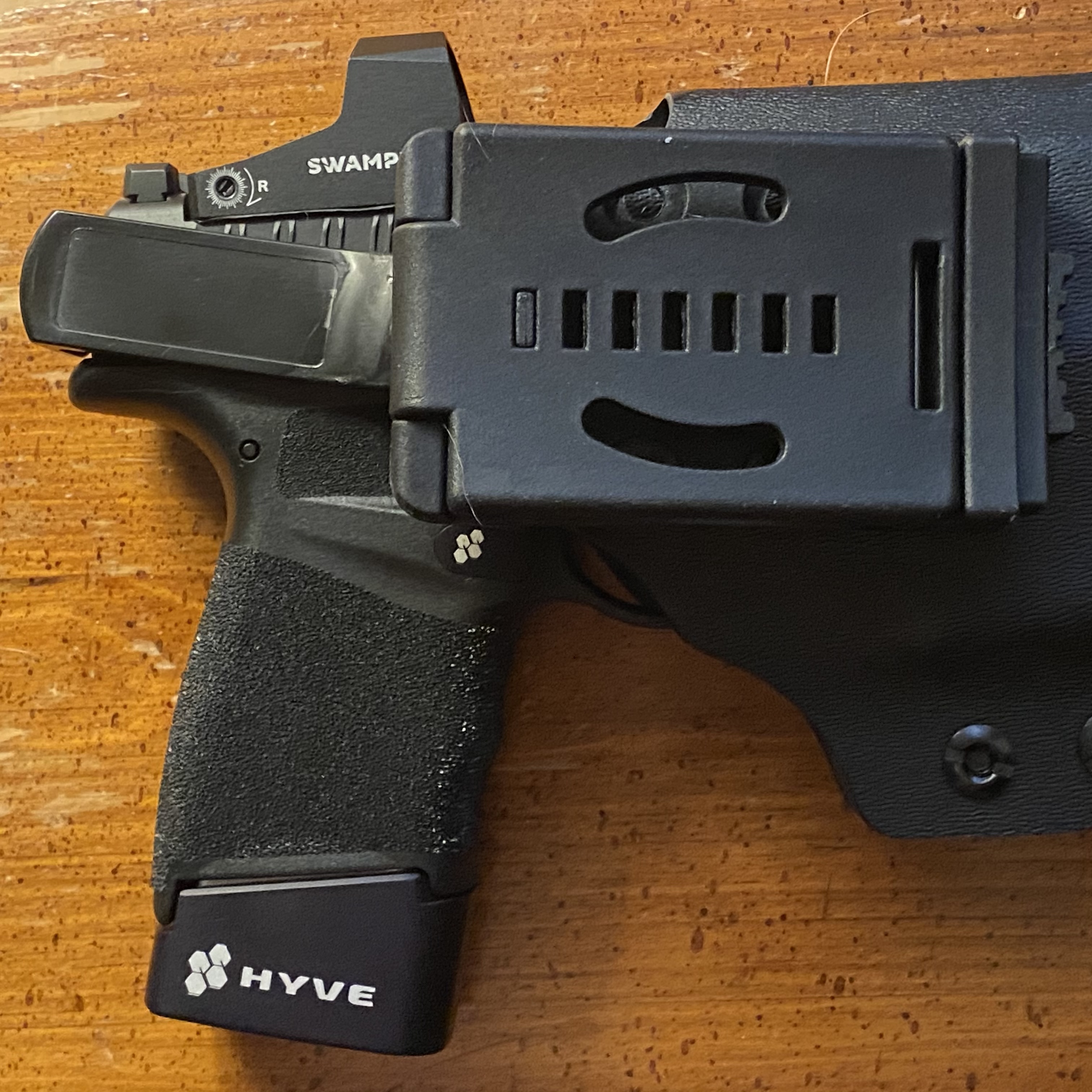

FWIW I had a holster custom made by "Just Holster It" for Hellcat+TLR-6+Swampfox Sentinel RedDot. It fits very well and I'm really happy with it. I did end up swapping out their paddle for the Blackhawk one I got from Amazon, and I ended up having to cut about 1/8 off the holster where it was hitting the mag release in some circumstances but otherwise it came out really well and was only ~60. Photo below was before the Sentinel arrived but there is a cut out for it and it fits well.

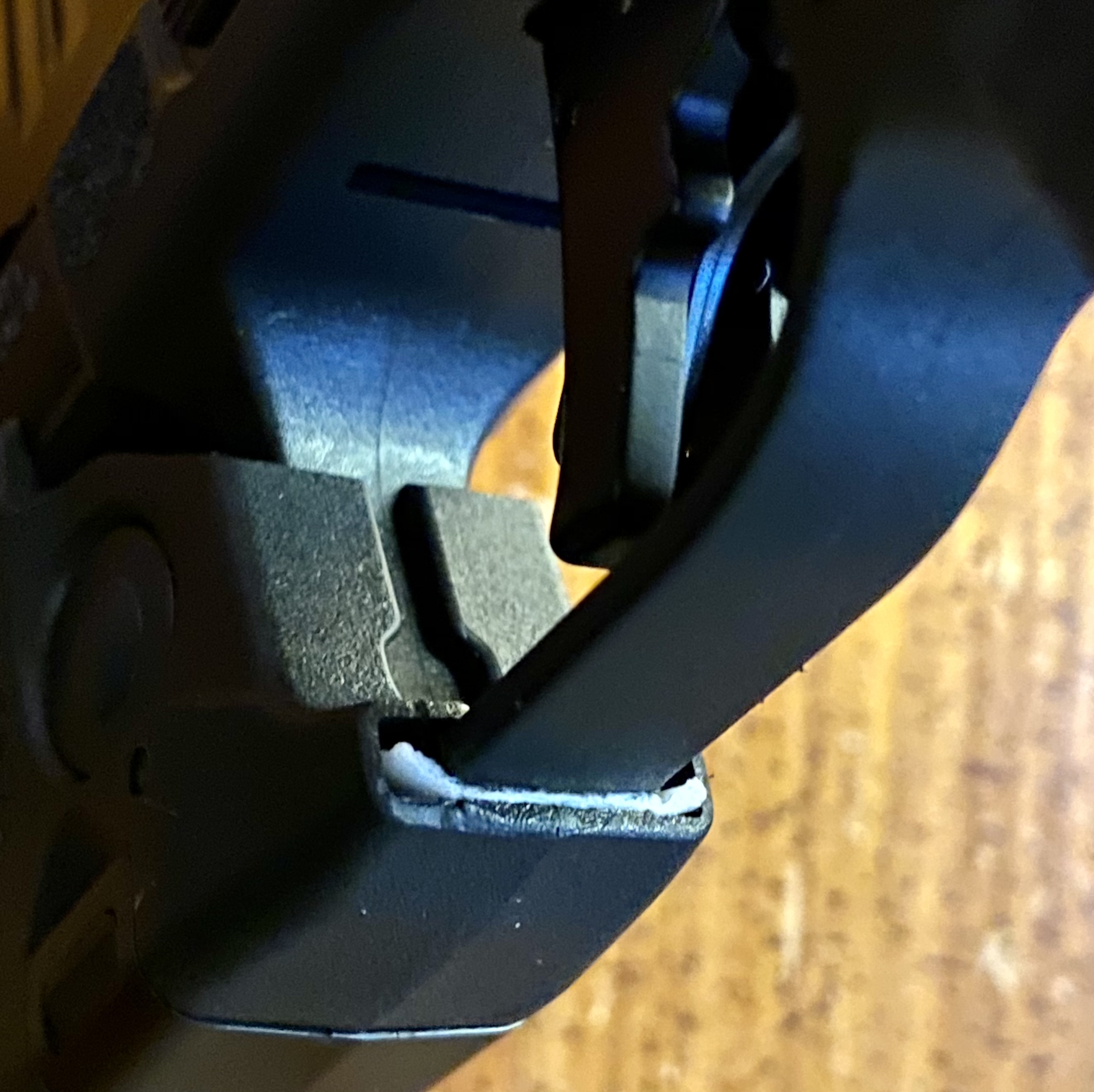

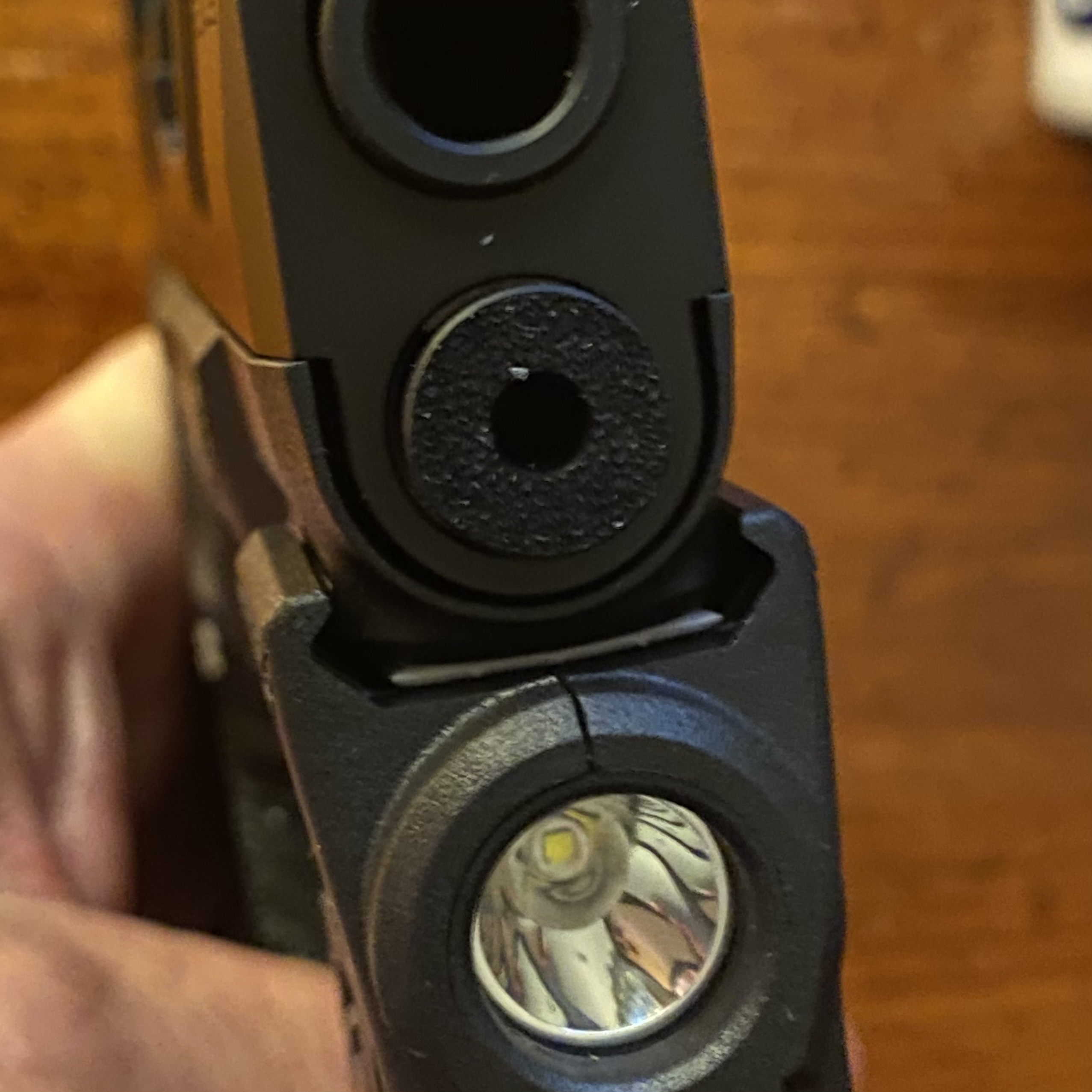

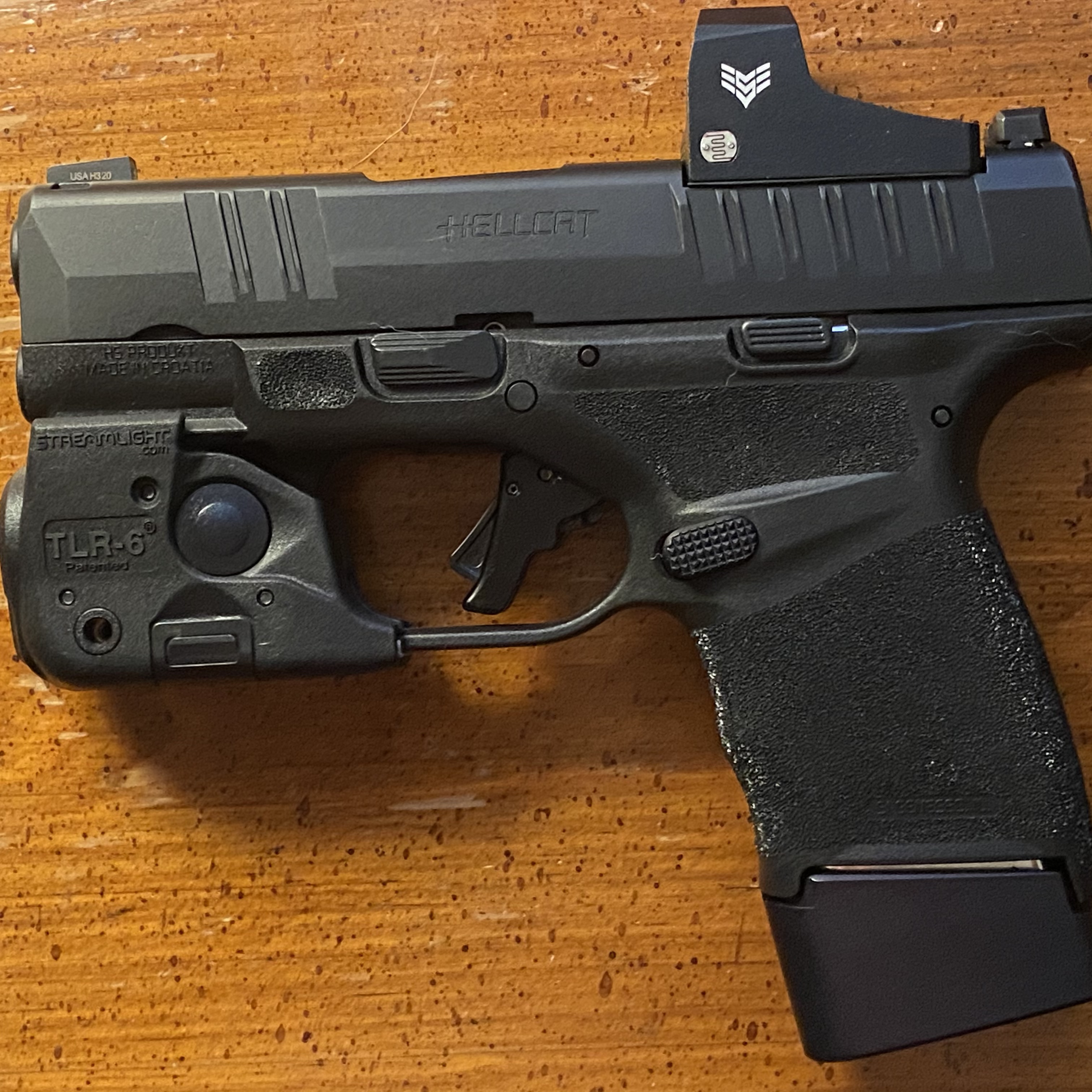

I did something similar with my Hellcat and TLR-6 using 3M hook hanger double sided removal sticky strips. I cut the strips to fit inside the trigger guard and the rail clamp before attaching the TLR-6. It is also rock solid and the 3M sticky strips are easily removed from the pistol and the light without leaving any residue. The Swampfox red dot sight fits the OSP cut perfectly and the PJ Holsters IWB SOB holster is a favorite for me. Ever since the FBI backflip incident, I modified all my IWB holsters with a locking belt clamp and a thumb break for absolute retention under any circumstances. You may want to checkout the Hyve Hellcat magazine extension and extended mag release. I also used an Apex trigger and PRP sear and disconnect or kit for a 4 pound trigger pull and a DPM progressive recoil spring to reduce recoil. While I would prefer a green laser light, I haven’t found one that really fits the Hellcat well or isn’t too wide and defeats the whole slim compact design.

Have the Hellcat with OSP in FDE plus the Sentinel and the new Apex trigger and really like this setup. I have on order the Viridian red laser to try Since it’s pretty small but really hard to get. On my Sig P938 I have the fitted TRL -6 and that’s a nice setup. See how this laser goes over for me. If not the TRL-6 looks nice on the Hellcat

Wow - that turned out well. They did the holster nicely on yours that it does not hit the mag release - mine did in certain circumstances so I had to modify. Good tip on the 3M Sticky Strips to firm up the rail mount - if there is a weak spot on mine that would be it.
