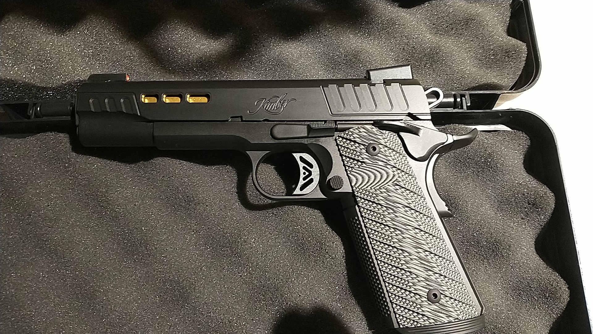

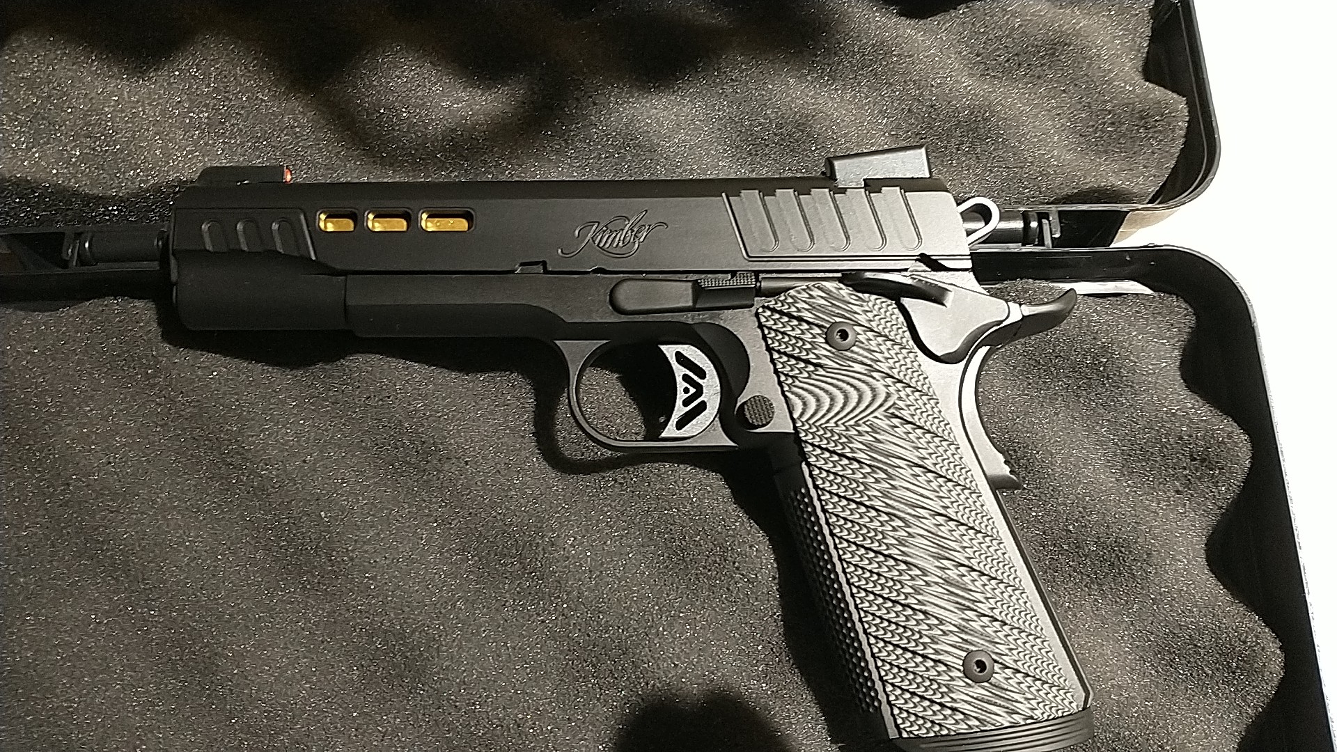

Found one. Guy who I left my number with called today. He had just received a Kimber Rapide 10mm. Now to make the 75 mile drive this weekend and see what he'll give me for my trade in. I'll be trading in a brand new never shot XD-M elite .45 3.8" compact.
This is internet picture of the same Kimber not the actual firearm I'm going to see.
