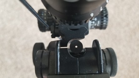

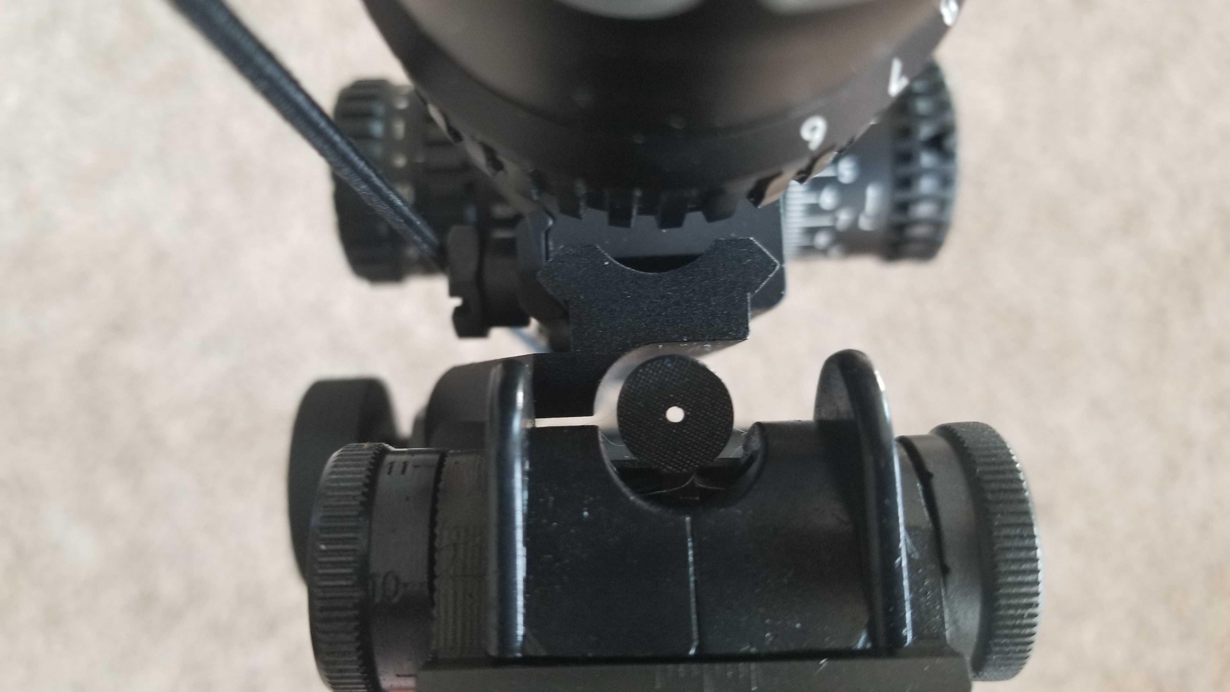

You can see under them but not well. I wouldn't plan on using your irons after the mount is installed.
Thank you for the good info benstt. If there is not a scope mounted, are they viable? I know the rear sight can be elevated, but didn't know if that was any help. Thanks again.

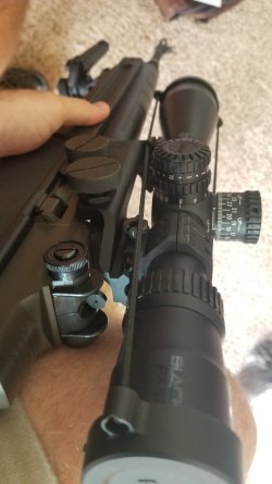

If you want to use your sights, I recommend you look at Sadlak mounts. They are designed so you can still use the sights even with the scope mounted.
Springfield mounts (at least the aluminum mount) require you to remove the rear sight altogether.

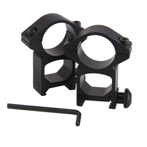

There are what's called "See Through" scope rings made if helpful?
Finding good quality rings in stock locally, online or available is another thing:
Like these:
This is a 4th generation aluminum mount. I can't say what a steel mount is like.
Like these:
