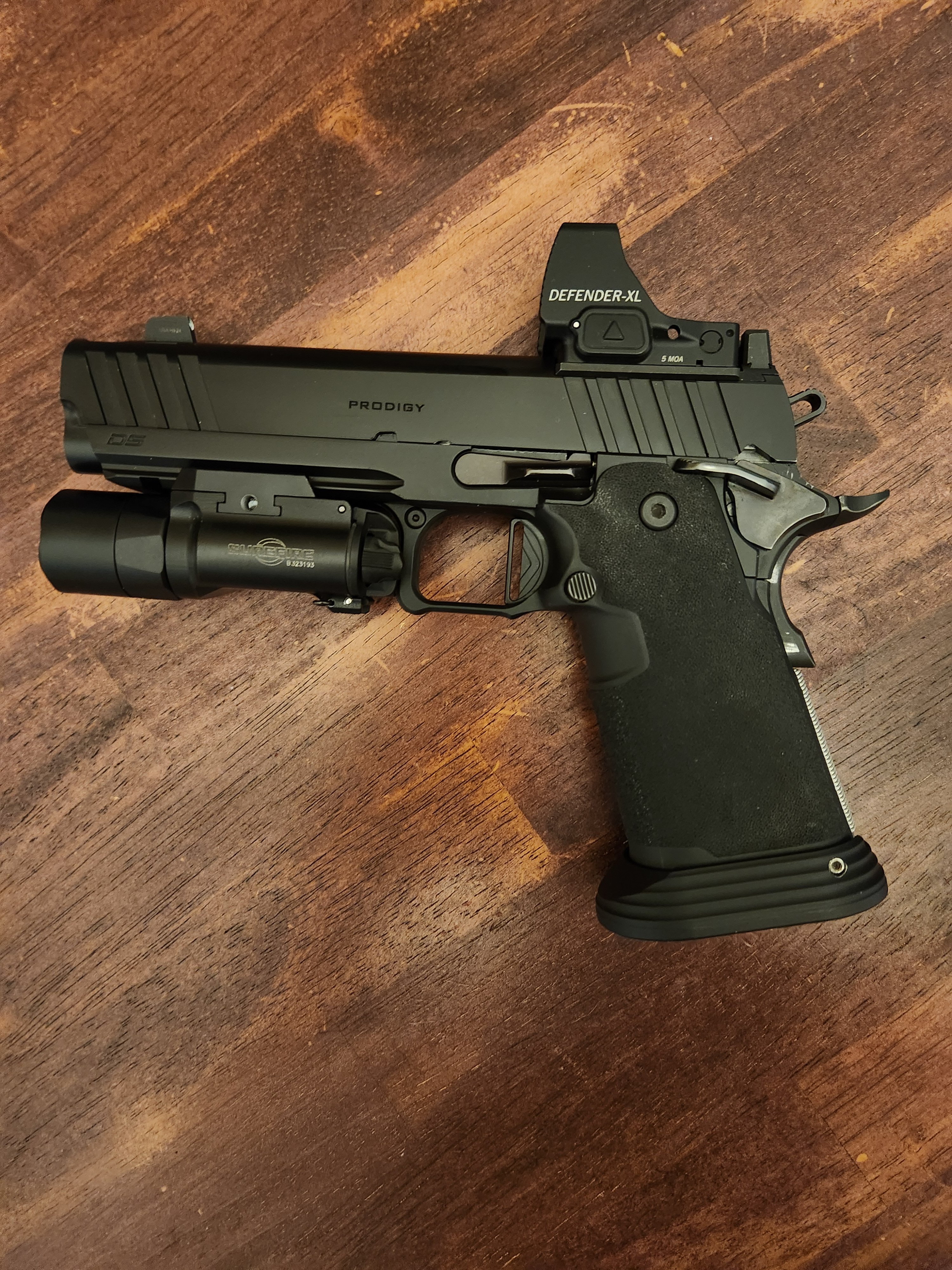

New Prodigy trigger pull weight only 2.7'ish lbs. after 650 rds.

I only have about 650 rds. through my new 4.25" Prodigy. I was expecting the trigger pull to be upwards of 4 to 5 lbs. being new, based on various reviews I read. I bought a Lyman digital trigger pull gauge to check it. I was surprised it was under 3 lbs.
So what's the problem then? My plan was to use the Prodigy for EDC. In that role I would like a trigger pull just under 4 lbs., I think. If so, what is the best course of action if I want the trigger pull around 3.7 lbs.?
I considered that the trigger gauge might be off. I checked various other pistols including a 1911 (SA Operator), a few SA/DA guns, and one striker fired gun and they seem to be what I would expect. I'll check the gauge against a known weight soon but I am curious what everyone thinks about 2.7 lbs. for EDC. Maybe its just personal preference.

One of the reasons I am a 1911 adherent is it gets me have a nice trigger pull, but with two manual safeties. Since Prodigy is a 1911, I have no problem with a 2.7 lb trigger pull.
