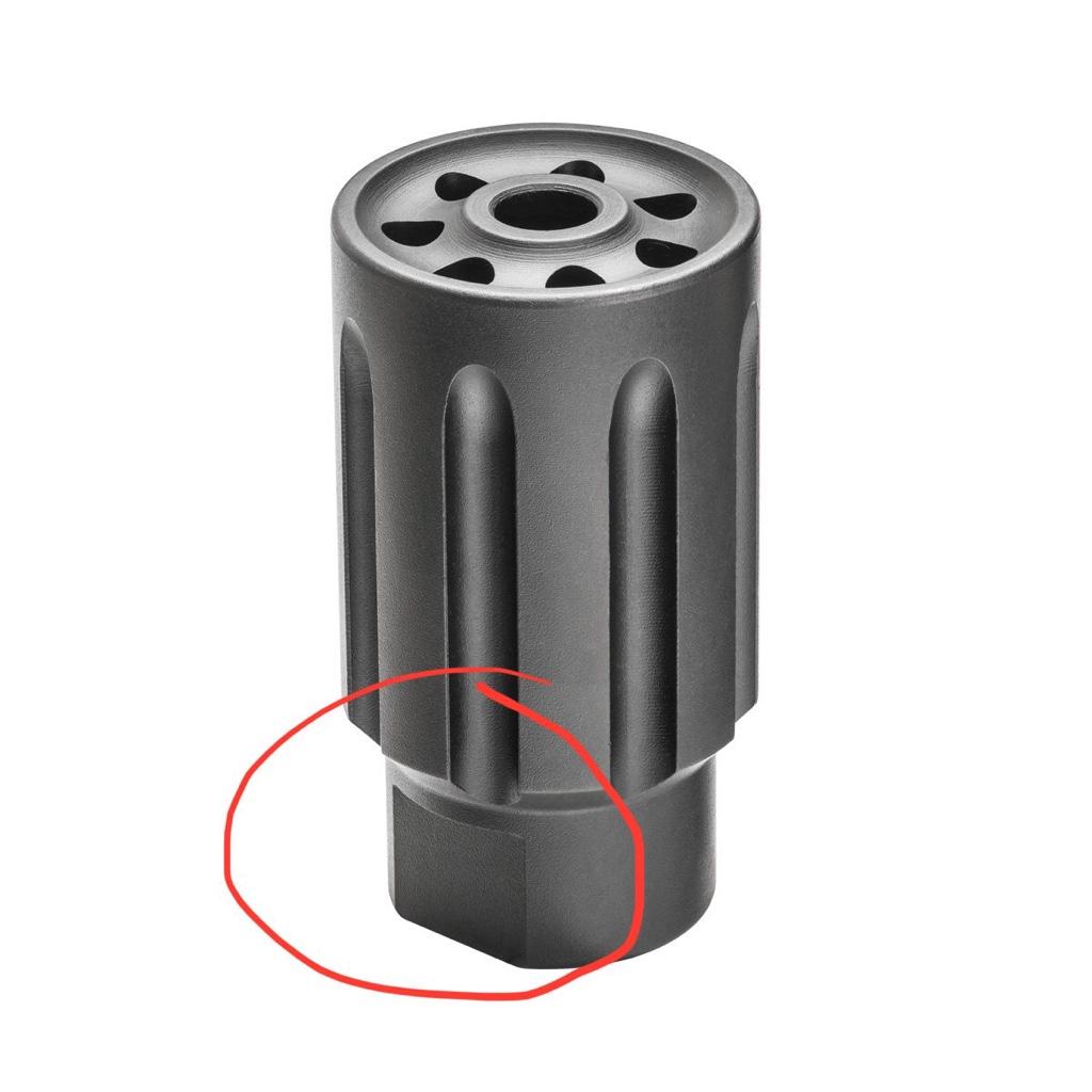

If you have shot your rifle the diverter has gotten hot. It will be a little tough to remove. You need a bev block or something to hold your barrel, a barrel fixture. You need to remove your handguard and on the diverter should be two flat spots. Take some channel locks and put it on those flat spots and take the diverter off. I’m pretty sure SA doesn’t use loctite, some companies use Rockset but not aware of SA doing this.
Wrong blast diverter. His is for the Edge PDW, That’s different than the one you’re showing. That one is on the Saint Victor pistol.
Mine is different, looks to be based off the hate brake from maxim defense. Thank you very much for your reply!!
