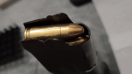

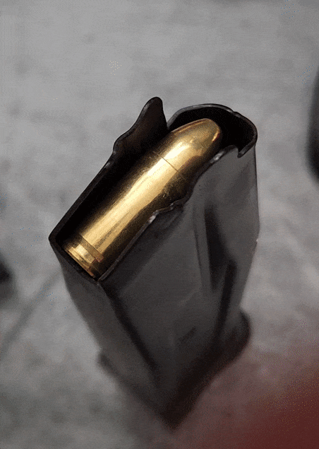

Gifs are worth a thousand words... but this has started to happen on BOTH my stock 17rd and 20rd Prodigy mags. The mags are not full in the gifs, 17rd only has 10rds at this point and the 20rd had 13 or 15.
I think this might explain my very infrequent failure to feed issues. I have several hundred rounds through each mag already.
Can this be fixed without replacing internals? Haven't had this issue with any other mags for my other guns so not really sure if this is fixable.
Left gif is the 17rd which will slowly come up on on its own. Right gif is the 20rd - which is much worse as you can see and has to be tapped on the desk to get the rounds to feed up again.

Take them apart and clean them.
All good suggestion above.
Do you use one particular brand of ammo, or do you use different brands? The reason I ask is that you might be having a problem with inconsistent OAL of your present ammo. Poor quality control might be letting some by where the OAL is just out of spec enough to cause the cartridge to jam up on the inside of the mag. One of your photo's kind of looks like that might be happening.
I think Walther had a similar issue with their followers on the PDP mags and issued a recall with updated follower kits and a free mag per customer.
Seat the magazine to stager the rounds. If you smack the bottom of the magazine it will help the rounds stagger. Maybe the internals are dirty?
I took them apart and cleaned and they were not dirty at all. Only a very little dusting of carbon at the top which wiped off easily with a paper towel.
When I put the springs on the table, I noticed they're not sitting flat; they're both slightly bent and in different ways. One has a decent twist in it and is bowed in the middle. The other one, the top portion of the spring itself actually rubs against the inner walls of the mag - you can see the wear marks near the top of the spring itself just under the follower.

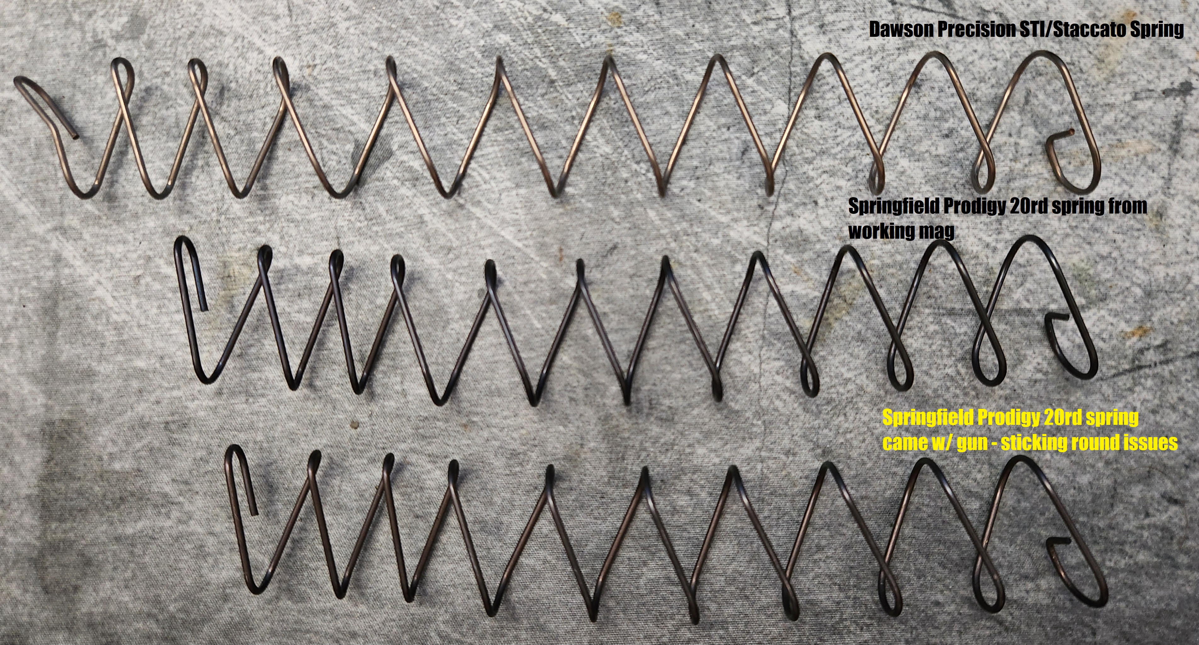

I took my original 20rd and the 20rd that I bought at my local GS apart together and what did I find?
A completely different spring in both of them. Top spring is the original mag that's having binding issues and bottom one is the spring from the good mag I bought separately.
(Not that this matters? But the top spring is actually more of a gunmetal grey color and the bottom is black)
So essentially my original mags are under sprung from the factory.

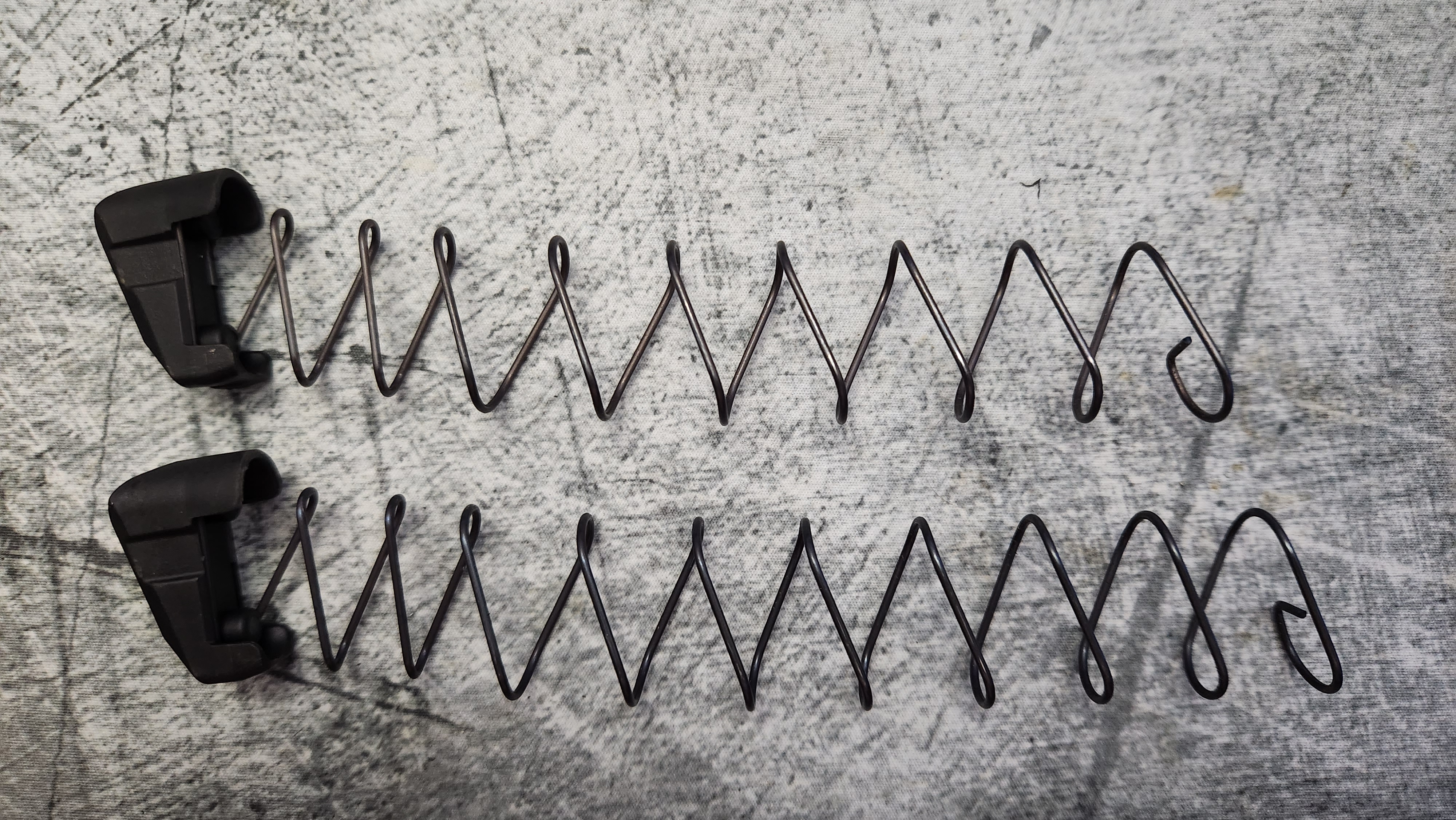

I purchased some Dawson Precision STI/Staccato springs for the 17rd and 20rd mags.
Put them in and instantly saw a massive difference when loading rounds. The springs are perfectly straight and zero issues with rubbing on the insides of the mags now. No sticking at all.
Picture for a comparison below.
I found out that my original 20rd mag that came with the gun actually had the SAME spring that the 17rd mag did :rolleyes:. No wonder I was getting FTF and sticking round issues.
Only little modification I had to make was to bend the curve on the spring where it attaches to the follower to match the angle of the Prodigy spring (Oddly Dawson's own site picture doesn't have the angled bend, but it was easy to fix)
