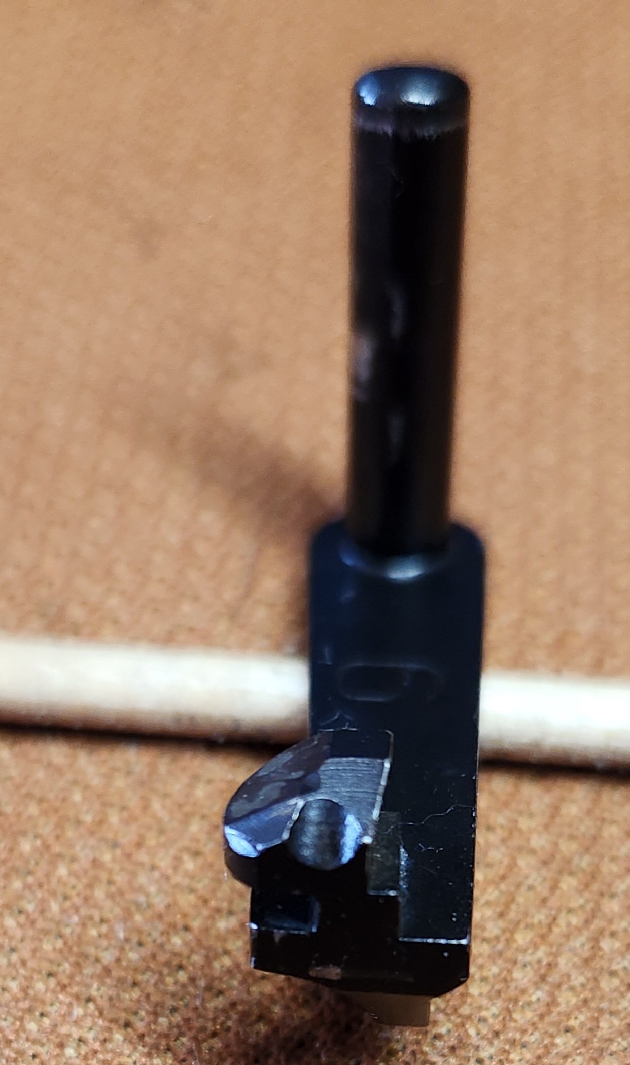

I had to look up MIM. I guess the EGW part "should" be better then.
Generally, people freak out about MIM because the internet told them to. In this part, however, since it's a high-stress part (even with low "impact"), it's probably worth tool steel. The slide stop pin is what feeds through the link on the bottom of the barrel and "pulls" it down during unlocking, and especially if it's loose, it's taking more stress and impact than it should.
Past that, low impact/low stress MIM parts are generally fine. Your car engine is full of them.
Or use really thin oil (FP-10, Kroil) on the "back" side of the pin on the right side of the slide.
That, and put 1000 rounds through it. That'll help work things in.
If you're willing to use a file and some bluing paste, the work on the slide stop to make a small little indent to make it easier is less than a half hour.
Does have over a 1000 rounds through it. This slide lock has been tight from the get go. My index fingers are not the best either for pulling the slide back and removing the slide lock. I have some arthritis going on for both of those fingers.
If MIM is done right, there’s no issues, I think it’s just when MIM first came out many years ago, they were not very well done, I do remember when you do a trigger job on MIM parts, you can’t go to far stoning them since there just surface hardened.

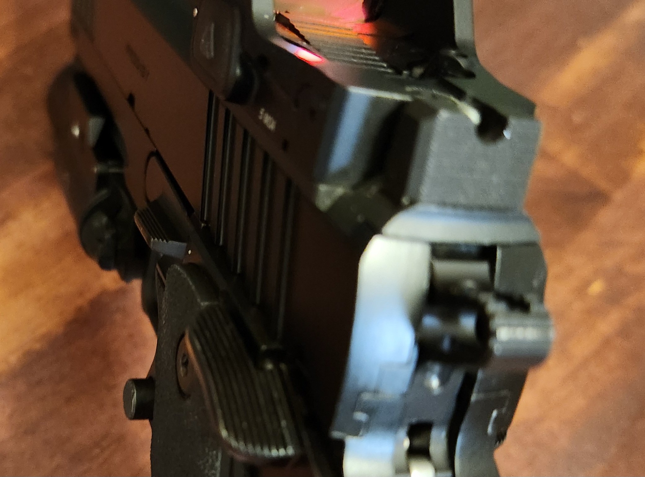

This is the one I was looking at:

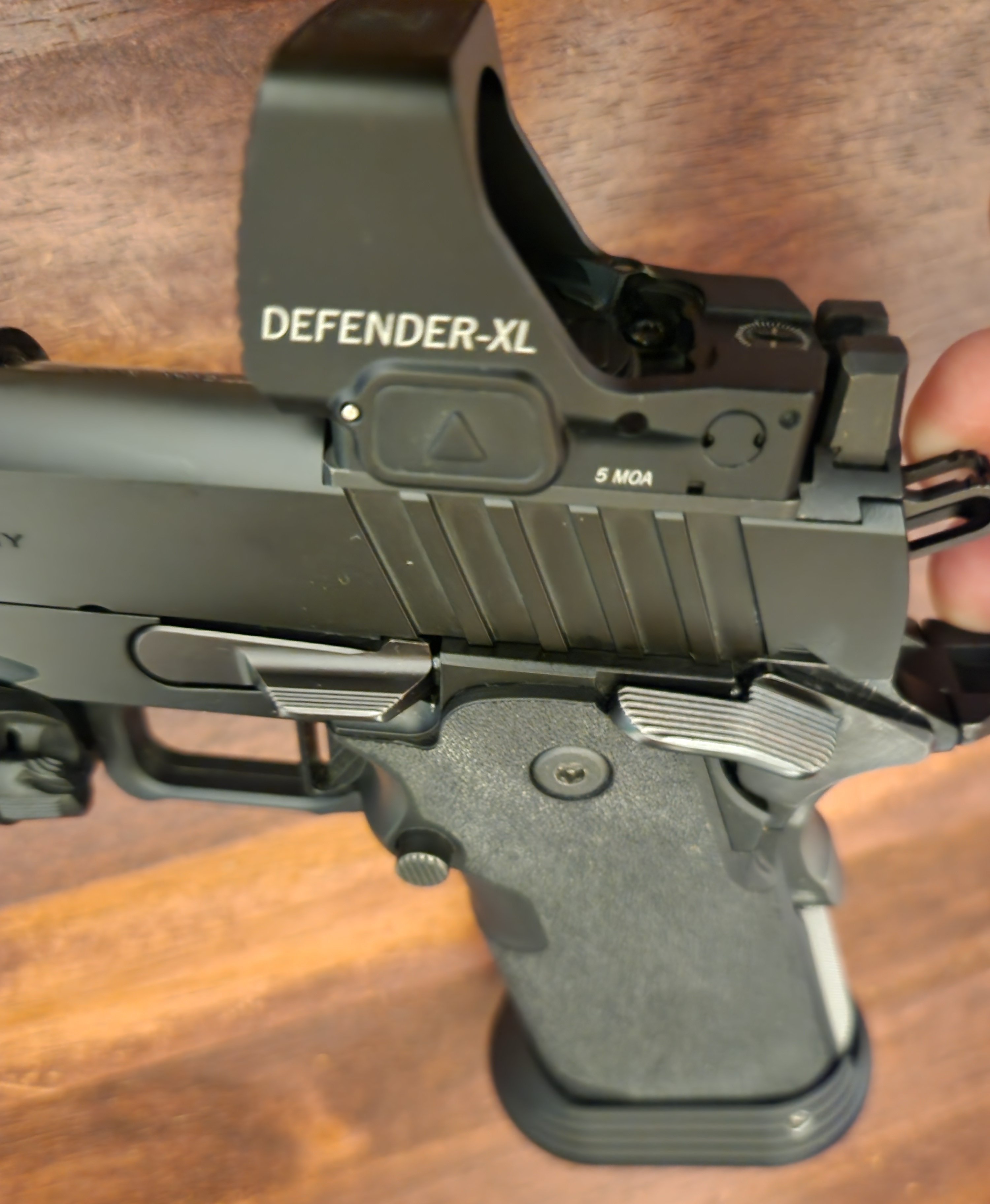

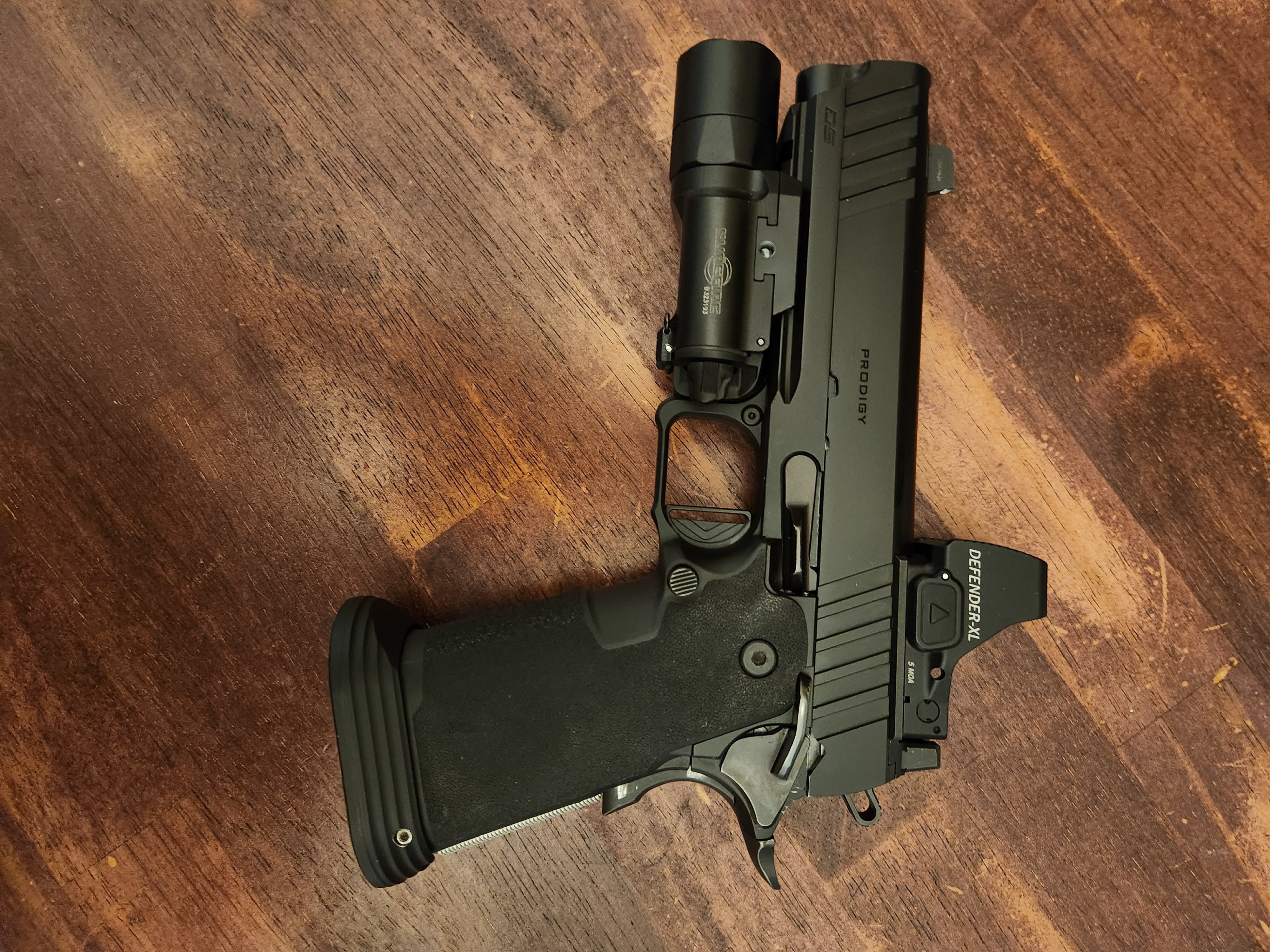

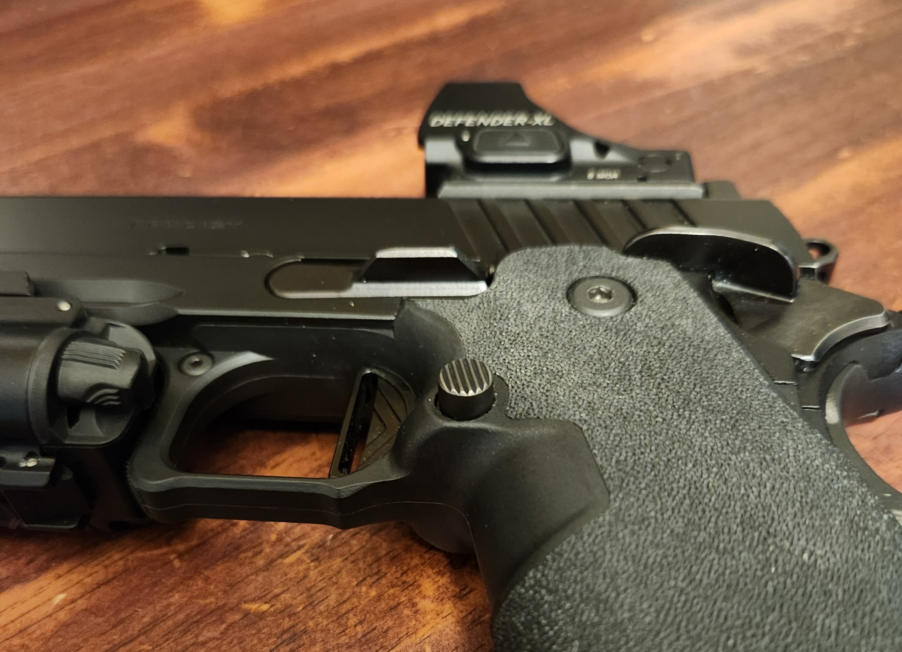

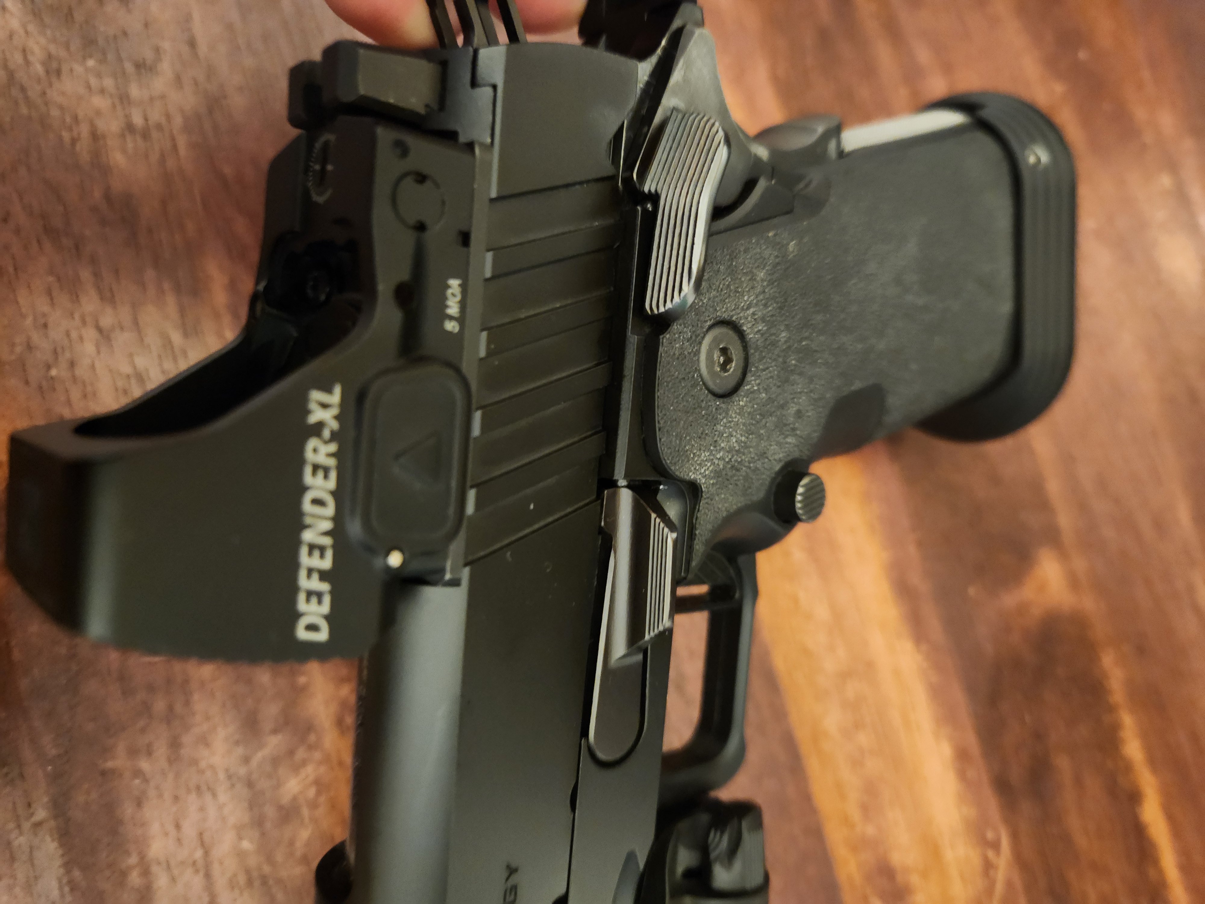

Have this slide stop, as well as EGW lightened hammer two tone ignition kit with shortened sear and ball head disco. EGW HD Ambi safety. Red dirt size 3 flat faced trigger. Slide stop was drop-in, measured same diameter as factory with digital caliper. Ignition kit required some light stone work at hammer and sear, was fine but wanted smoother action. Ambi safety required fitting of lug. End result is pure satisfaction. Trigger is a smooth Crisp 2.5lbs.
