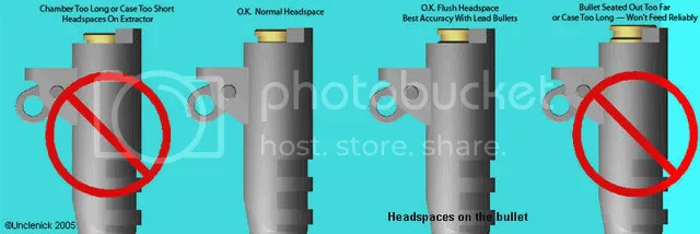

in this diagram, from the first posting in fact, all my 45's are at the #2 in the diagram....."ok, normal head space"
then there is this, which i have been told.....
which is why i had both the Canik 9mm barrel and the Tisas 1911 barrel near me for final "plunk" test.
yes too, i am also concerned about pressures inside the cartridge, which is why i chose the 3.0 gr over the 4.0 gr.
but still too, i do not know why, the Lyman book had both specs for the same bullet?

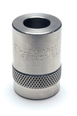

Honestly if you're going to reload I'd advice getting several of these in the calibers you're loading. Well worth the money, no guessing if that .001 sticking up is good or bad. If it doesn't fit or is not smooth across the top, pull it start over.

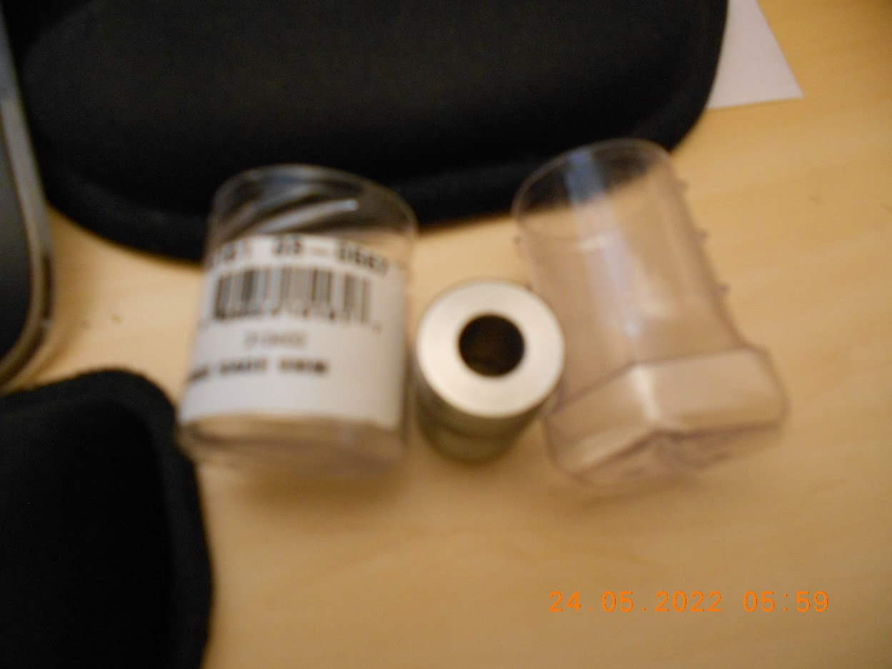

i have the Lyman gauge.
pretty much the same thing, they sit into the recess, or stick up.
Some of my friends use a cylinder of their revolver for a case gauge. I have Dillon case gauges, but load them at the loading table at matches, spin the cylinder and if all is well, close the loading gate. I can't do that with autos, but do check the first few with a caliper for OAL as I do any load.

i checked the Dillon shipping box, the RSO DID buy himself a Dillon size gauge, for 9MM, as 9mm was going to be his reloading plan.
