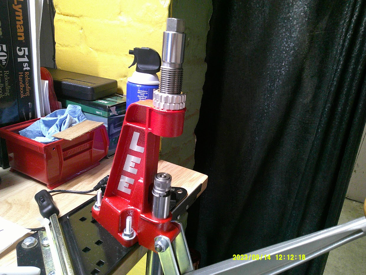

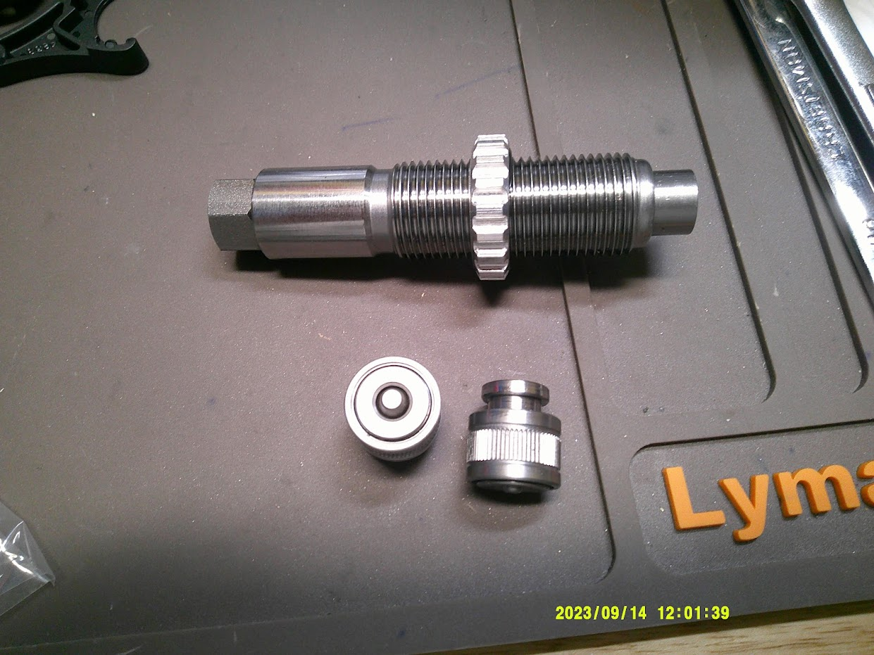

the new Lee breech lock press came as well as the swag set, also Lee, and the bench mount.
I git it adjusted, to just accept the primer, i may have to fine tune it a bit more or less.
i only swaged 3 shell casings, the rest (about 60) will be done at a later time.
i mounted it where the Lee Pro-4000 goes
the Lee swag set.
the Lee swag set.

so anyway, i set it up, and finished swaging 60, 9mm military casings.

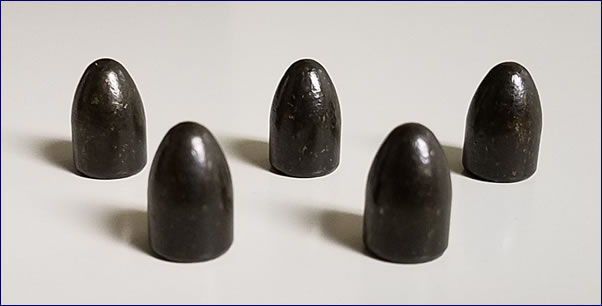

What I'm talking about are the "lipstick" bullets that are poly or hi-tec coated. I've not used Alox, which gives bullets a waxy coating and don't know if that gums up dies. Alox coated bullets will remove lead in barrels according to Lee.
Do your 9mm bullets look like these? (Mo Bullet Hi-Tek 2-Extreme Coating)
They also offer these also Hi Tek coated.
or like these normal lubed bullets- (also Mo Bullet company)
like these, in fact my 45 ACP, Colt LC, 38 specials, and 9's....
when i "seat" the bullet, i can see some of that "blue wax"..??? come out of the brass. so it stands to reason, that blue "wax" and maybe some shavings of lead, are the gunk..???
