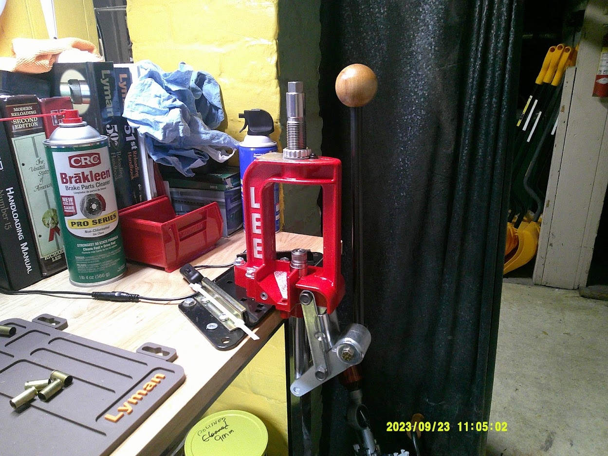

look at this picture..you should be able to see a black button on the top......that locks in the bushing for the dies.
it's SUPPOSED to keep the bushing from rotating.>!!
but, i cannot tighten the Forster lock nut, as it has to go past that button.....

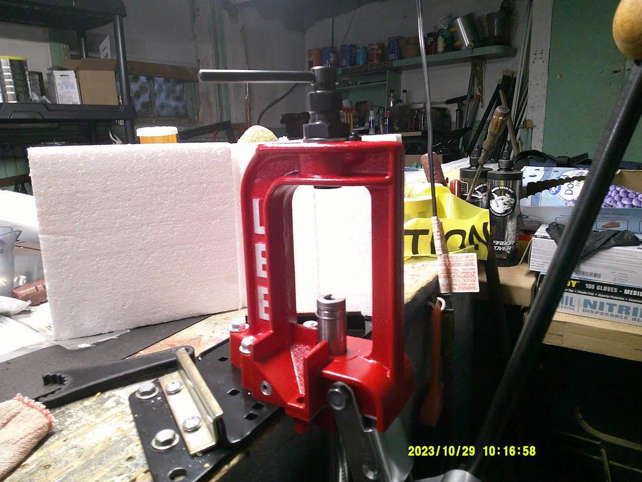

anyway, the next pics....
here is the Forster bullet puller, and the lock nut, jammed against the Lee bushing, the lock nut jams on that button, and if it goes past it..?? the dang bushing rotates as well..it ain't supposed to do that.>!!

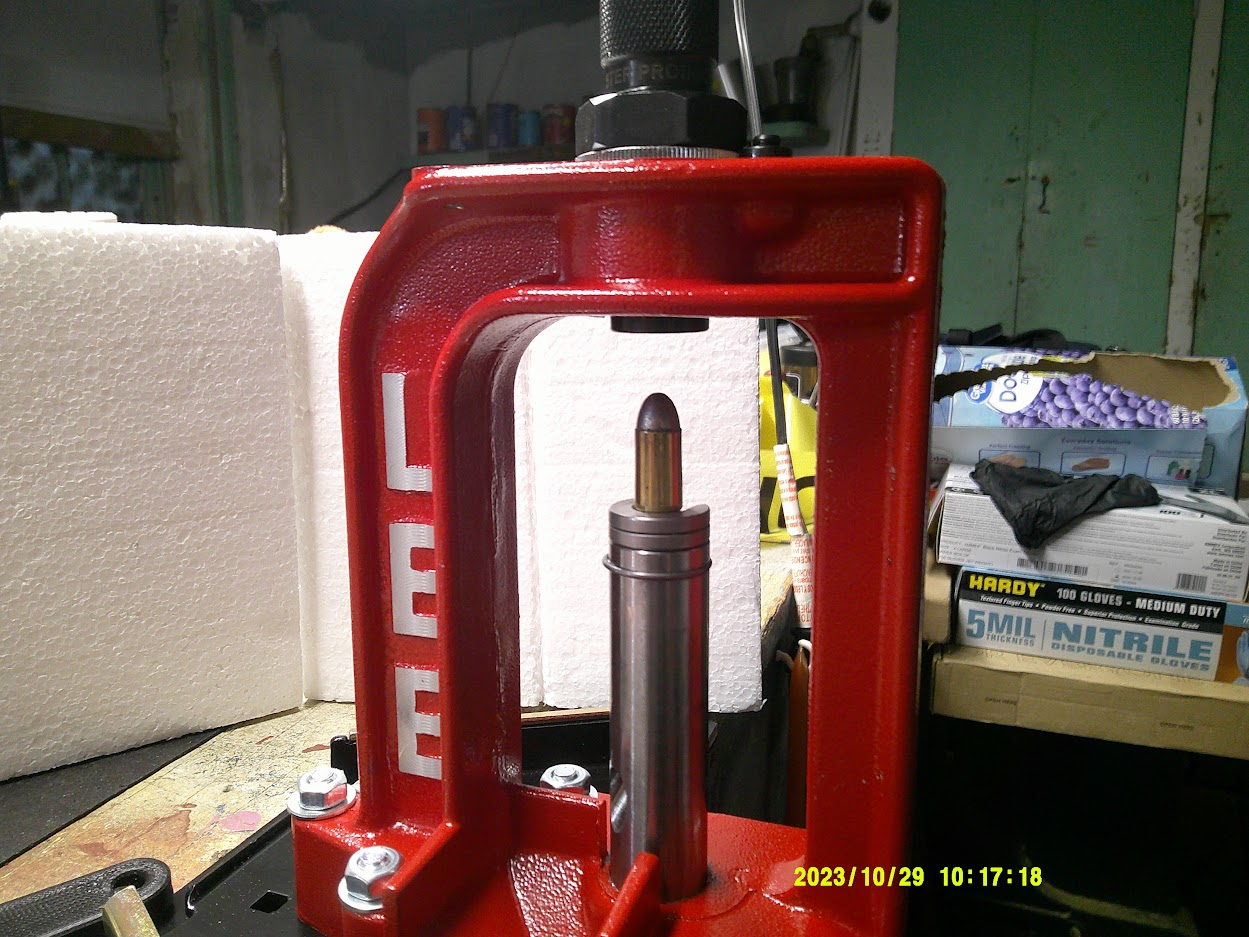

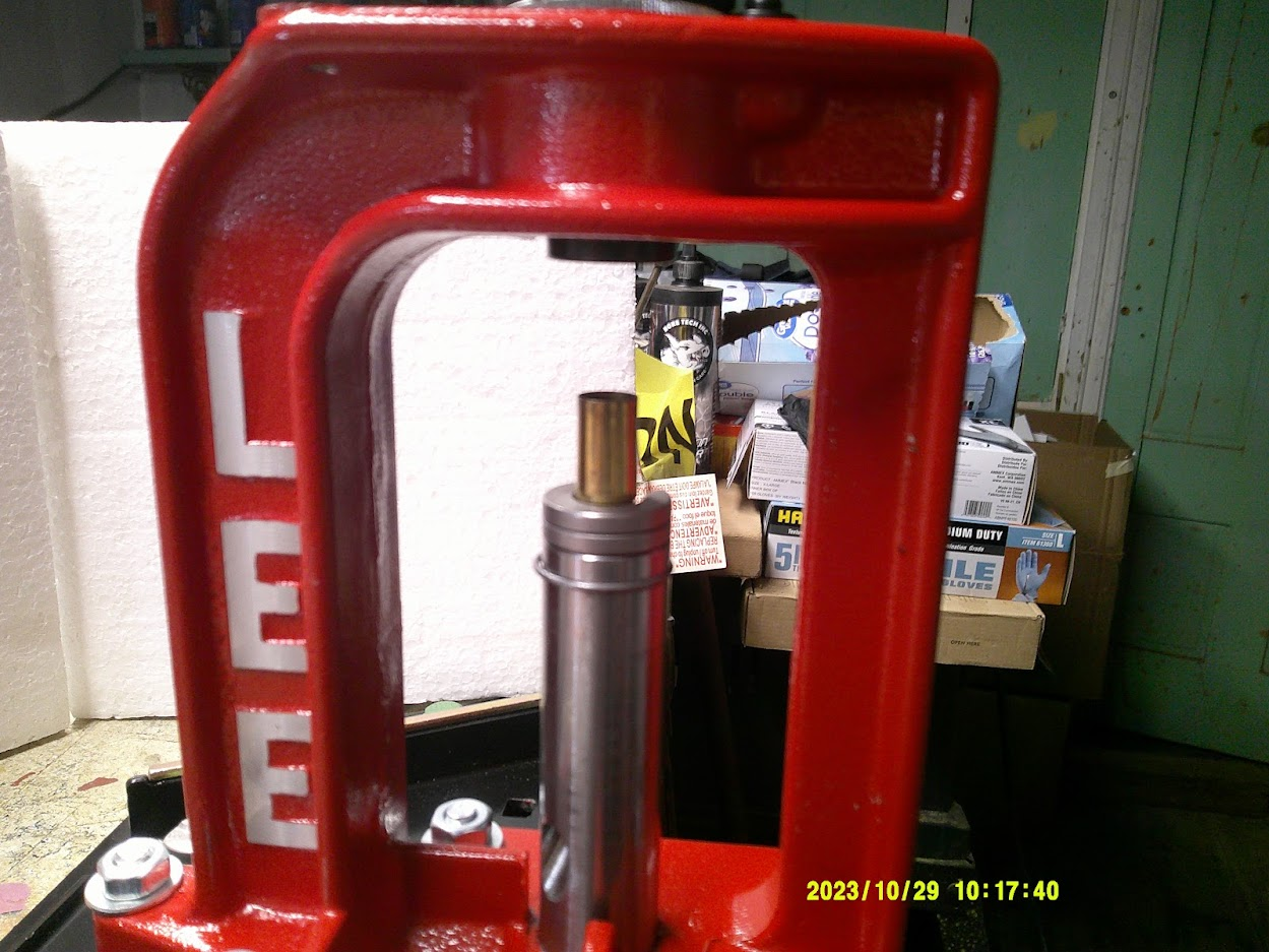

in this next pic, a round being raised to get the bullet pulled. AND you can get a better picture of the Lee locking bushing, jamming the Forster lock nut.
and bullet pulled....
as it was, i had to use "water pump pliers" to hold the Forster tool in place, otherwise, it would rotate in the POS Lee press.
Forster bullet puller works great.....
