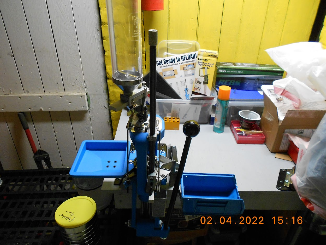

ok, that bullet tray arrived about an hour ago...got it mounted to the Inline Fabrication stand.
but now, frustration is settling in. i have taken web page copies, since the Dillon booklet is like crap to flies.
i am having a hard time, getting the powder drop die, to bell mouth the cases.
so far, i have done it Dillons way, making sure the "charge bar arm", goes up against the
powder body" like it should.
but also too, the "failsafe rod" is off center? if i set it straight up and down, there is a loud "clunking" at the powder drop area, where the "cams" clash with everything.
if the failsafe rod is "off center", or at an angle, things are quiet??
i dunno, the Dillon instruction manual has purtty pictures, but the online manual is better, but i gotta print out, go down to the basement, make adjustments, and still no flare or bell mouth of the cases.

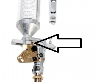

From Dillon's site about powder measure:
"The powder measure is case activated; it will only drop powder if a case is present. When a case is present the powder bar will travel it's full length until is flush with the body of the powder measure. This allows the powder bar to align with the powder funnel to drop the powder charge. The case activated feature saves you from messy spills while you setup your press or if for some reason a case is not present when you cycle the press."
There is a white plastic square piece attached beneath the powder measure linkage and it should travel as far right as possible when activated (see arrow). The bolt at the end of the charge bar changes the powder drop up or down. The Dillon powder drop funnel should be within the powder die and floats up and down. When the shell goes up into the powder die, the shell will get a flare from the funnel. If you do not get any or enough, you need to lower the die into the press tool head. You only want enough to start the bullet.
yes, i adjusted per Dillons instructions, getting that linkage as far right as possible, and to not over extend the linkage, possibly crushing it against the backstop..

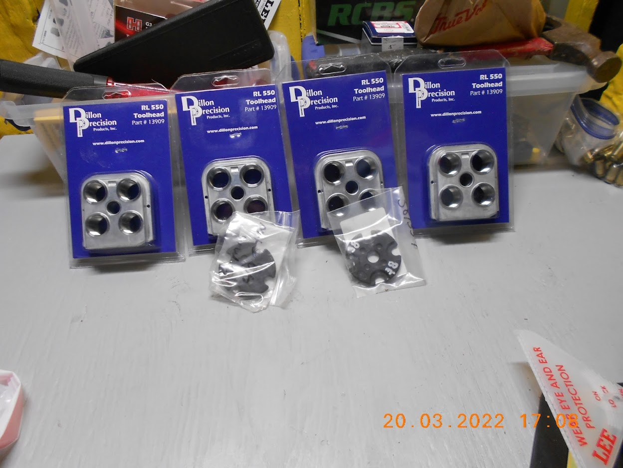

i have the original tool head that came with the press, then i bought 4 more, back in mid March.
as recently as this past saturday, i took delivery for the locator pins for the 9mm, 38/357 & 10mm/40 S&W plates. at this point and time, i'm "looking" at only loading the 9mm on the DIllon, and 45ACP on the Lee. that was my plan.
