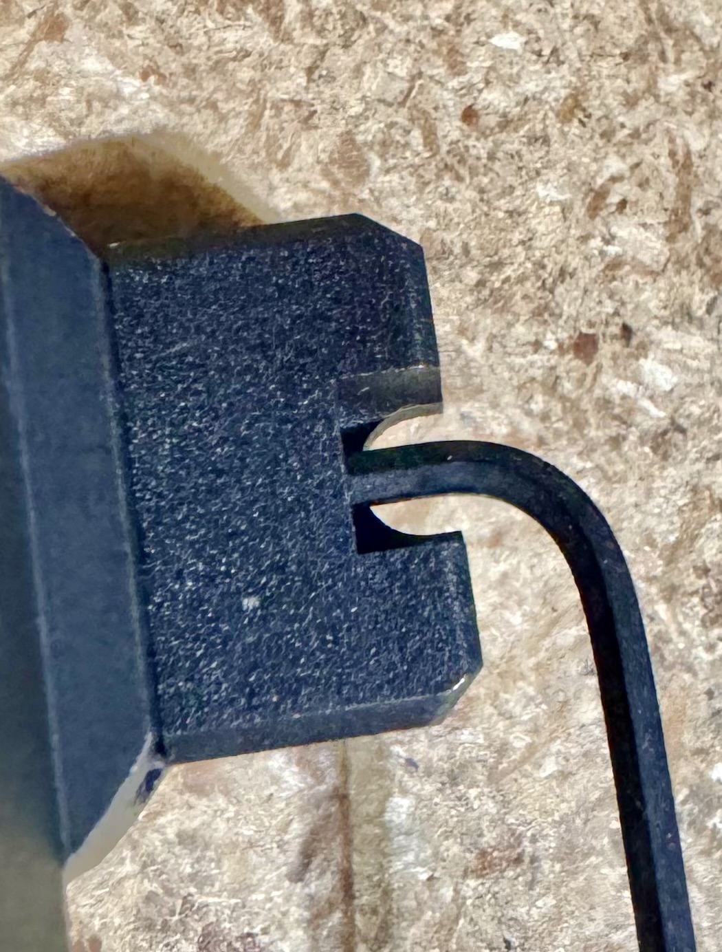

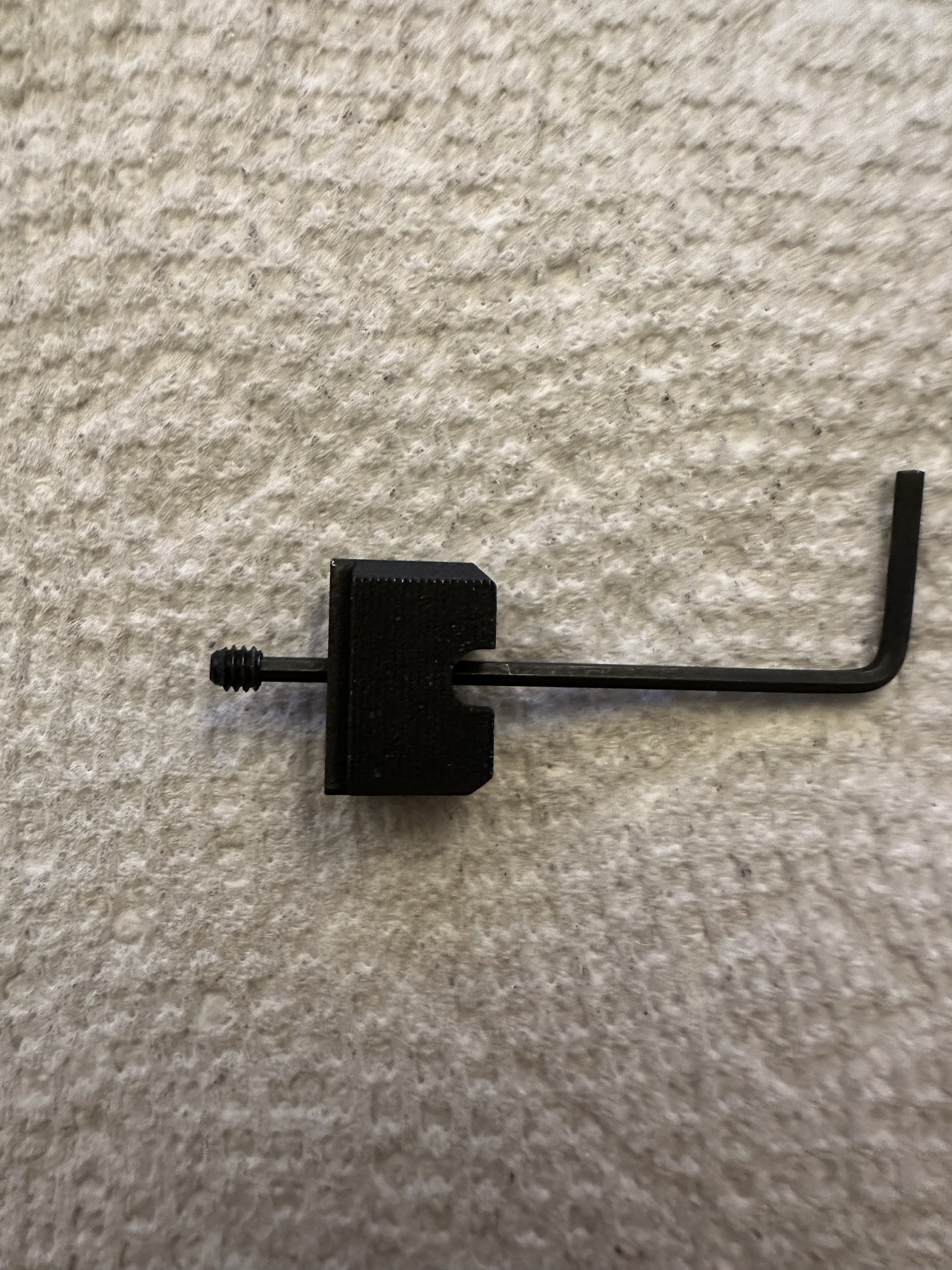

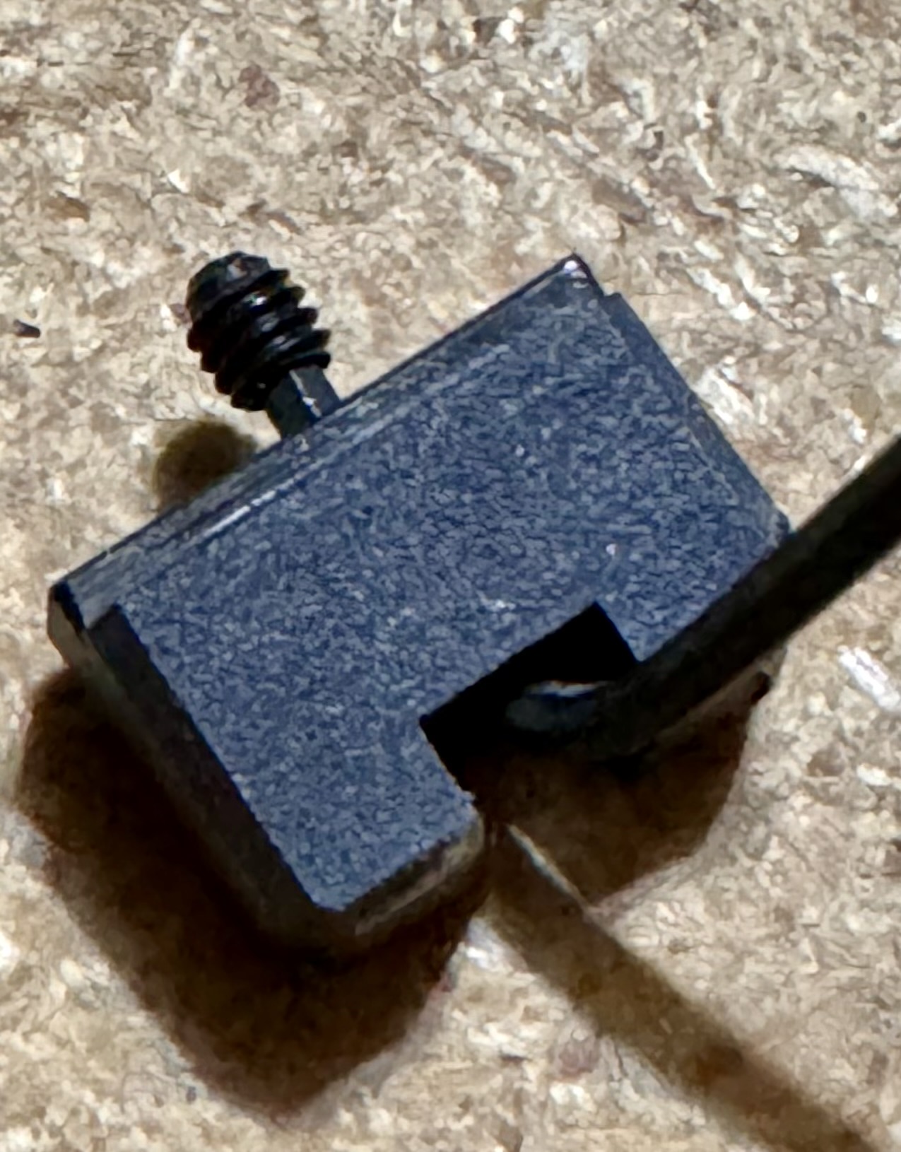

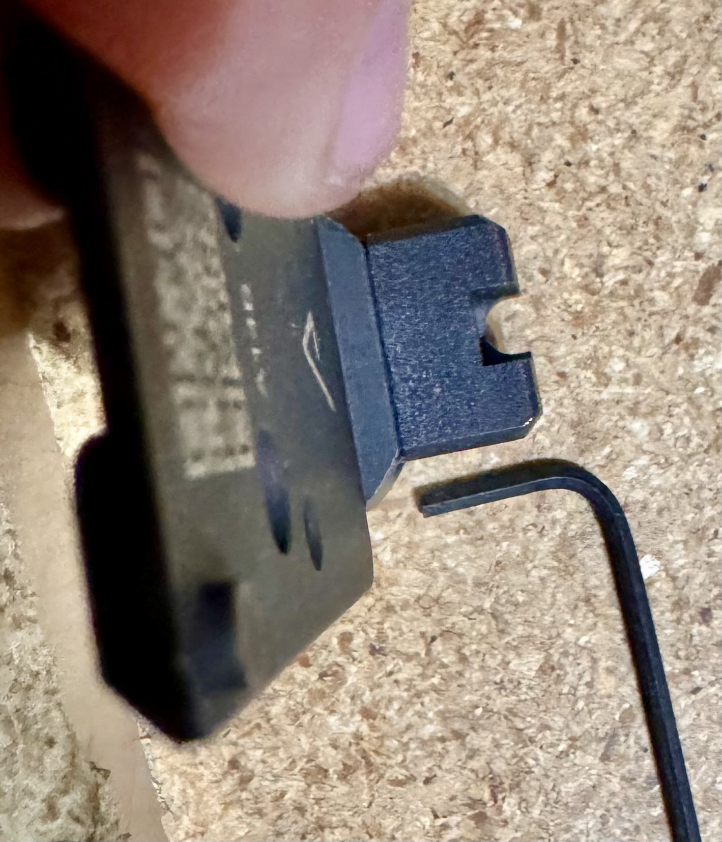

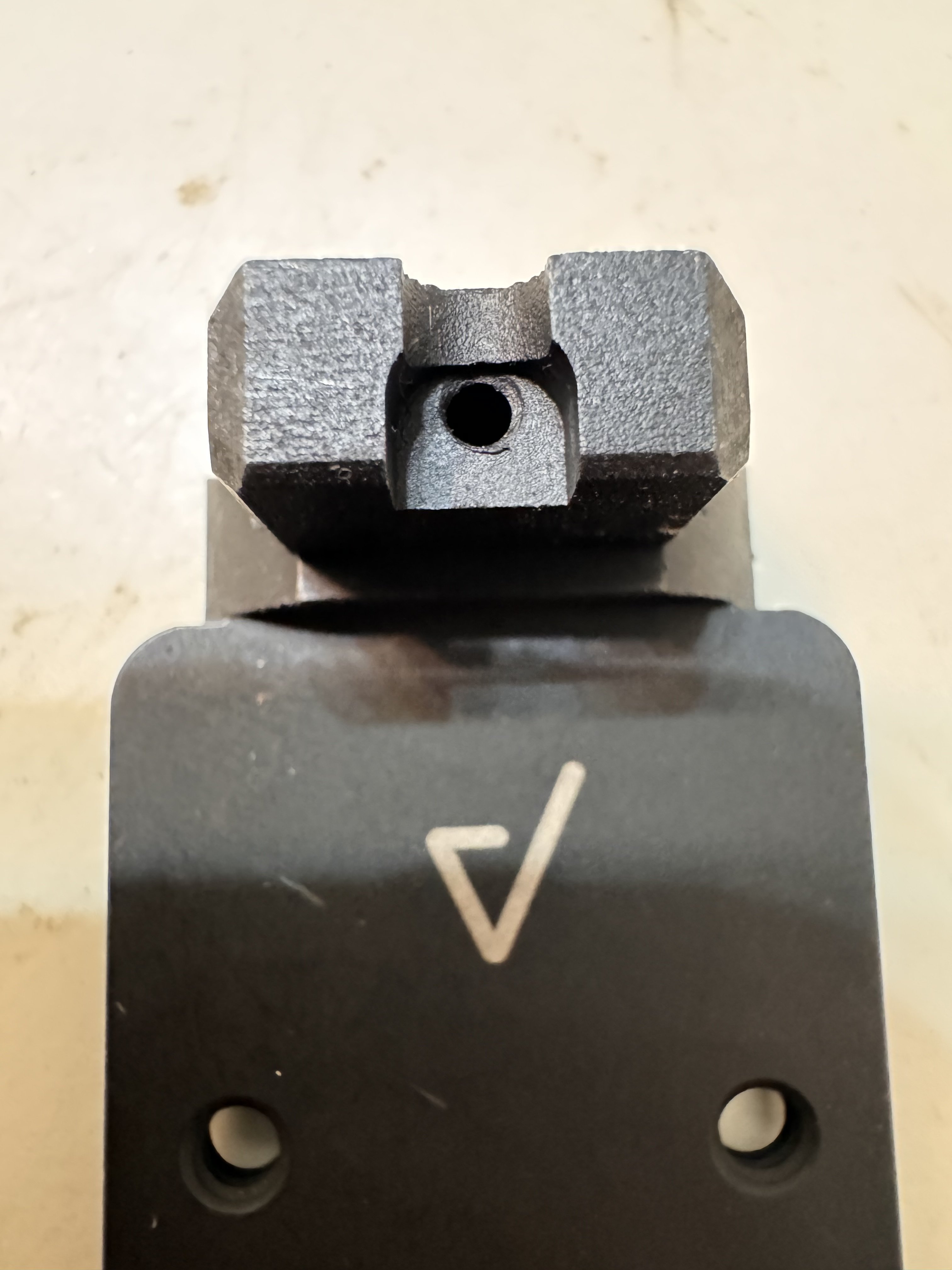

Upon further examination it seems that the screw had broken off the sight and some of the screw remains in the bottom of the sight, flush with the bottom making it impossible to grab with a pair of pliers. (see pics). Also, there isn't a screw hole on the A14B plate for the sight screw to screw into. Whats up with that? Anyone have a picture of the bottom of their A14B plate?
I don’t think that screw broke, thats how it’s supposed to look like. The set screw is a tiny hex head that you should be able to back it all the way out. You are probably not using the right size allen key.
In the pictures you can see two views. The top and bottom. The top shows the missing piece of the screw. The bottom one shows the remainder of the screw. Do you have the A14B plate? If so, can you send me a picture of the sight from the top view? Thanks
Its not broke the screw is small and deep in the sight, use a long 1/16th allen key shove it in the top of the sight. And turn the set screw like you are tightening and it will fall out. The only way to break it is by stripping the set screw.
The top of the sight, you will not see the set screw. The set screw has no head, unlike the screws used to attach the plate to the slide, and the optic to the plate. You will not see the set screw because it is buried deep in the tall sight blade.
You need a 1/16th allen key
Look how deep the set screw is in the sight and how far you have to reach in the sight blade
To remove the set screw you need to turn clockwise as if tightening and the screw will come out the bottom. The screw will not come out of the top since it is a blind hole (not threaded all the way through). It makes it impossible to loose the set screw unless you completely remove the rear sight.

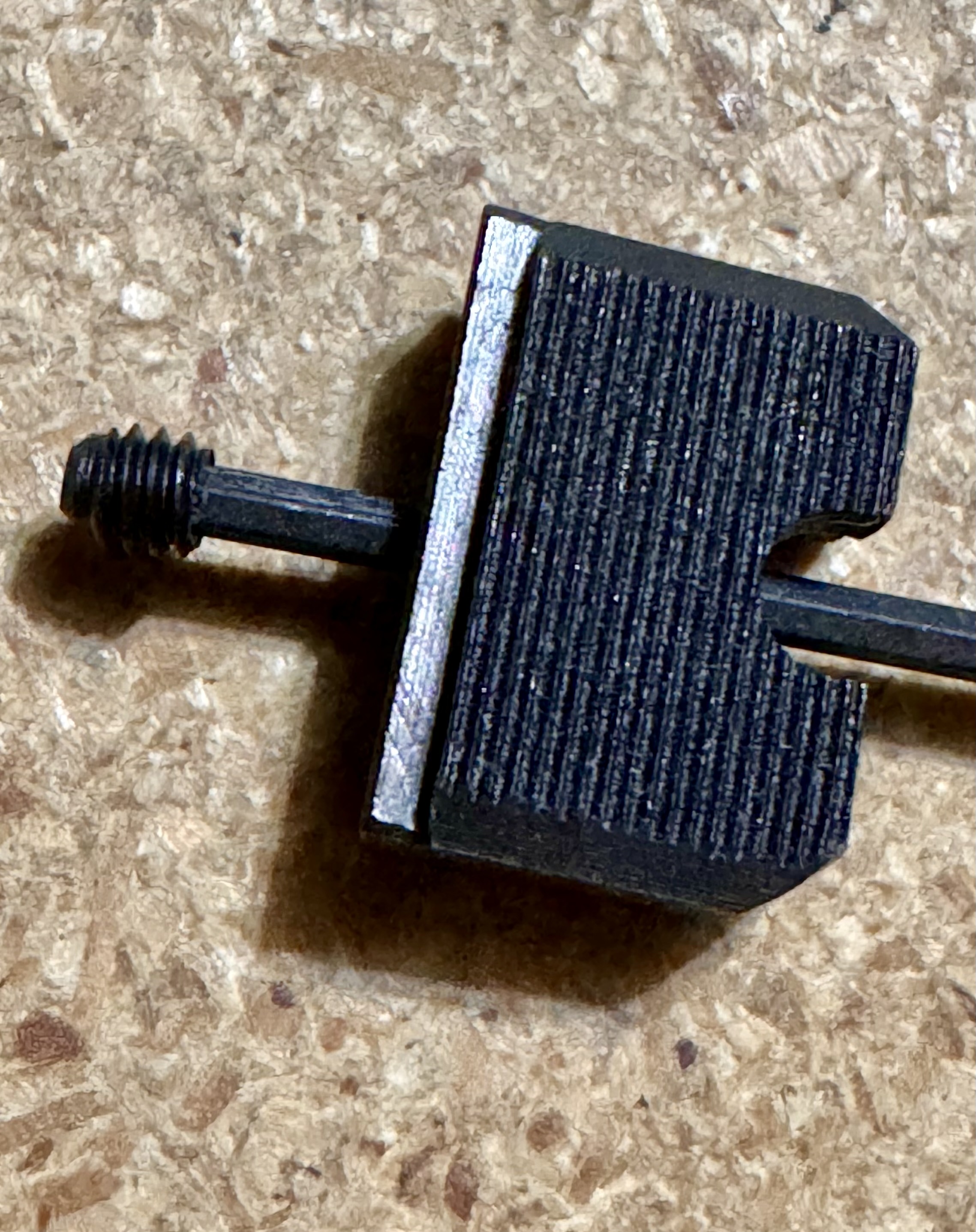

XDMan, Thank you so much for your info. As you can see from my picture I was able to remove the screw from the sight just as you instructed. Now my questions are how do I zero the sight and how much torque do I use to keep it in place, if torque is the right word. Hard to believe that this set screw doesn't screw into a hole on the plate only presses against it. Again, thank you so much.
The dovetail should do most of the work, the set screw is just an extra back up. If the sight is super loose in the dovetail, I use red locktite and spread it in the dovetail. Then push the sight centered, and cinch the set screw down. Wipe off the excess loctite. No locktite directly on the screw, just in the dovetail. Thats how we install sights at xdman and has worked for 20 something years. Red is non wicking and wont really work its way up the threads unless you put it in the sight blade hole first. Yes it will be removable.
