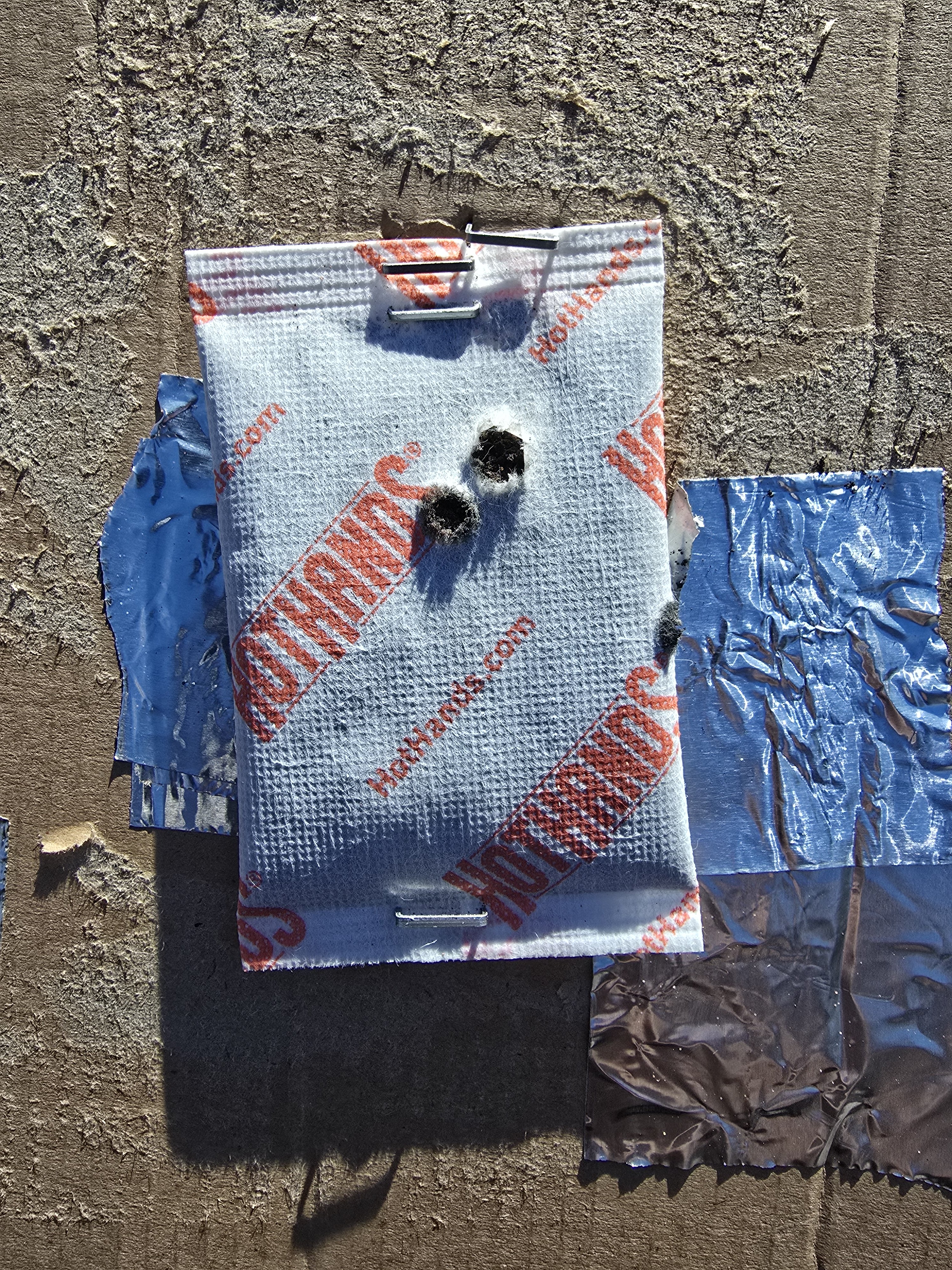

Hey there! Just following up! I tightened up the tensioning screw between the upper and lower, mounted my thermal scope for hog hunting and she's shooting great! 2 hogs down so far. Added a Dead Air Nomad suppressor and went to re-zero her in earlier today. She's dialed in and ready to go (pic below). I appreciate all of the feedback!
I hope you don't think that tensioning screw did it.
