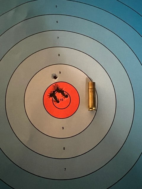

Just got back from the range. My .300 black seemed to work fine without any need for a gas block adjustment (not that I could do it anyway, I don't have an adjustable gas block). I probably shot 60 rounds of sub with it and had one FTF on my last round. Not sure what happened, but I wouldn't consider my .300 BLK totally broken in yet and this was the first time using the mag I have for .300 BLK subs. I'm pretty confident with it at this point. We'll see if I get any more FTF next time I go in.
AR Pistol shot well with both supers and subs. No POI shift with this suppressor, which was nice to see. I did have one issue where I noticed my shots spraying a little. Checked the suppressor and it had loosened up a little. I tightened it up and got very good groups. Below is my last group at 35 yards with an unmagnified RDS with a .300 BLK casing next to it. Looks like 1 flyer, which may have been the FTF round I fired on my last shot. I'll take this group any day...
