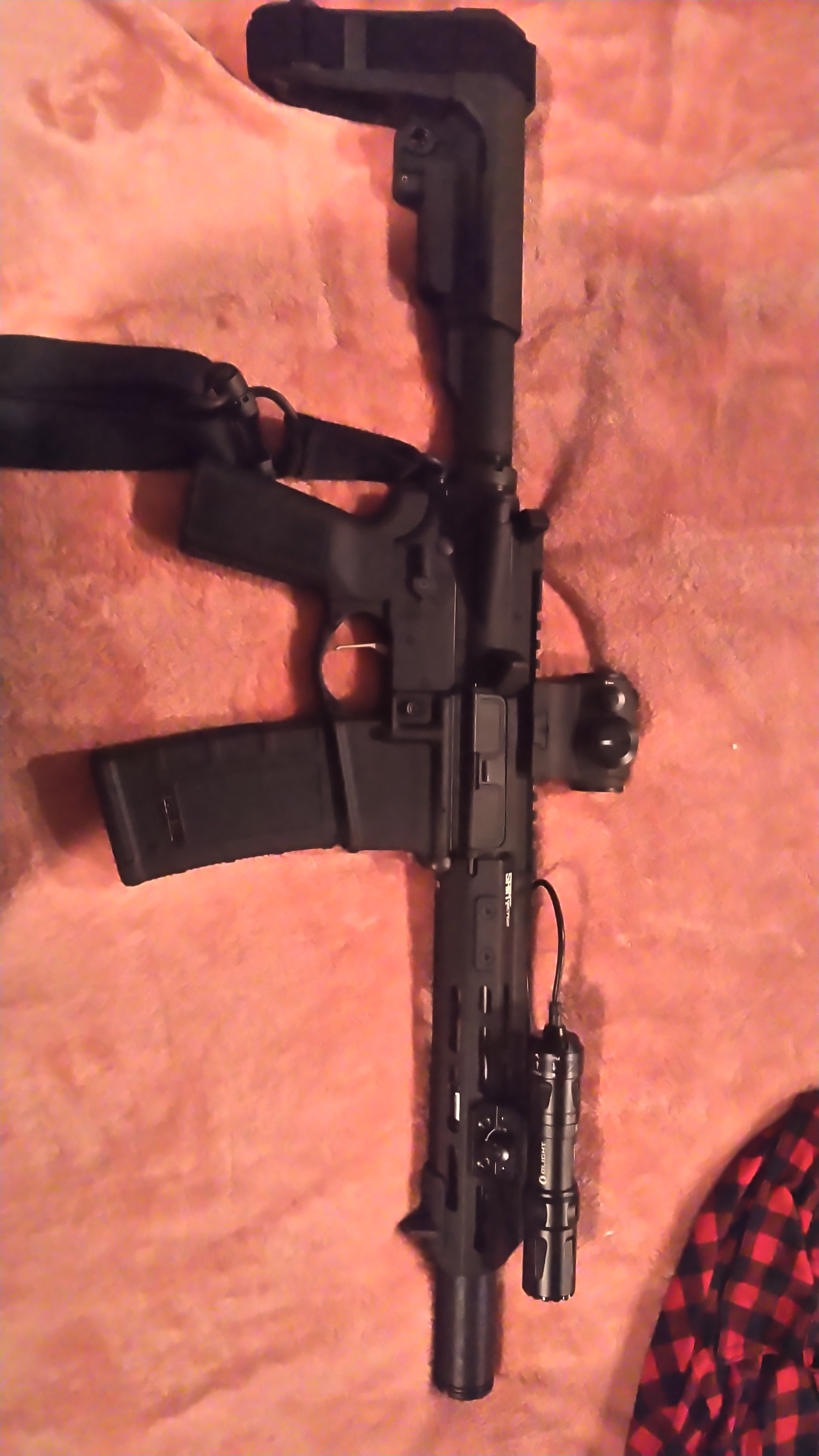

Ok thanks. I'm going to try and run a mag through it tomorrow. Just a note to anyone who looks at this thread down the line the pin will come out of the gas block just keep trying. I almost gave up but finally got it out. She looks good though

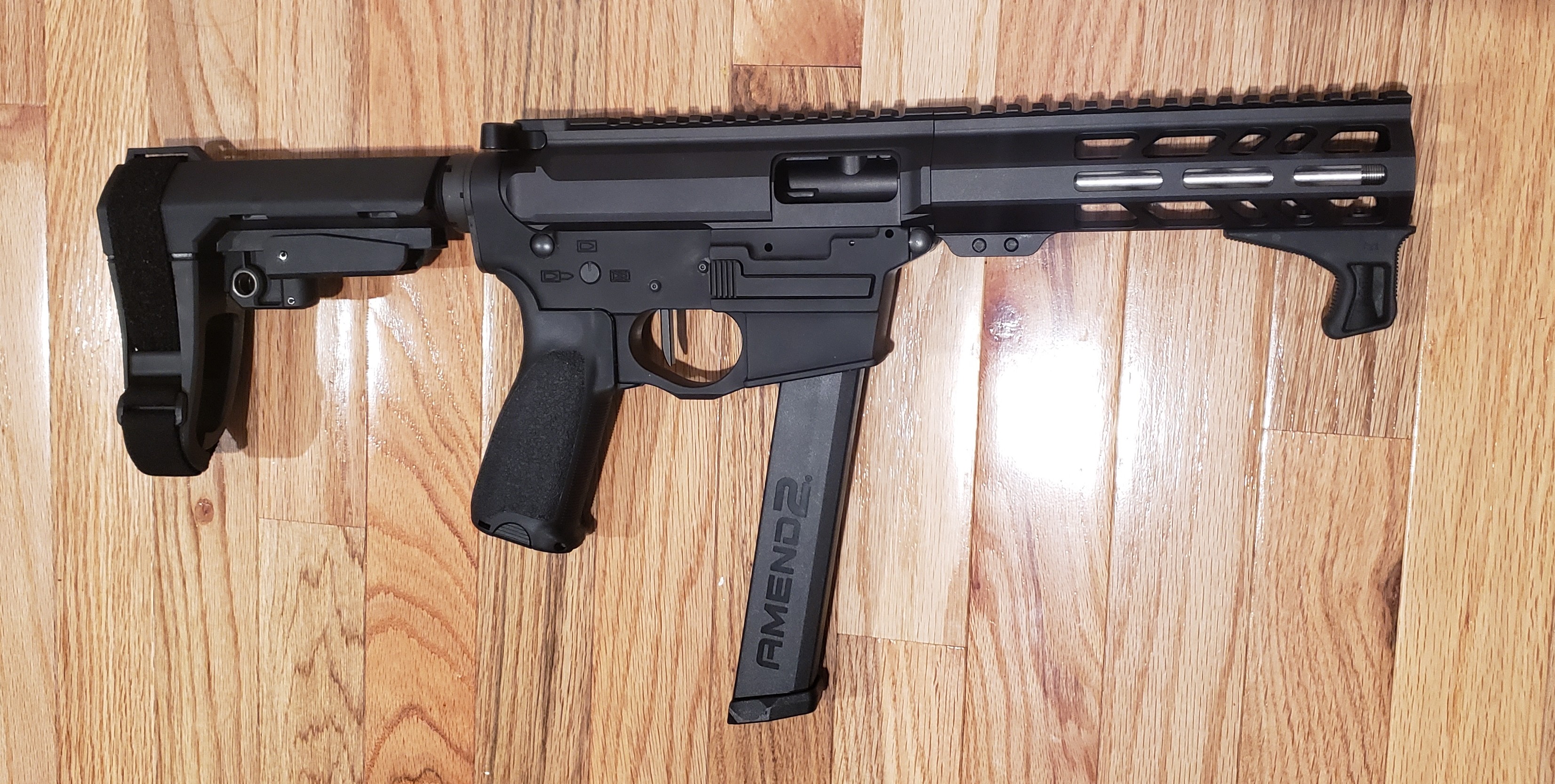

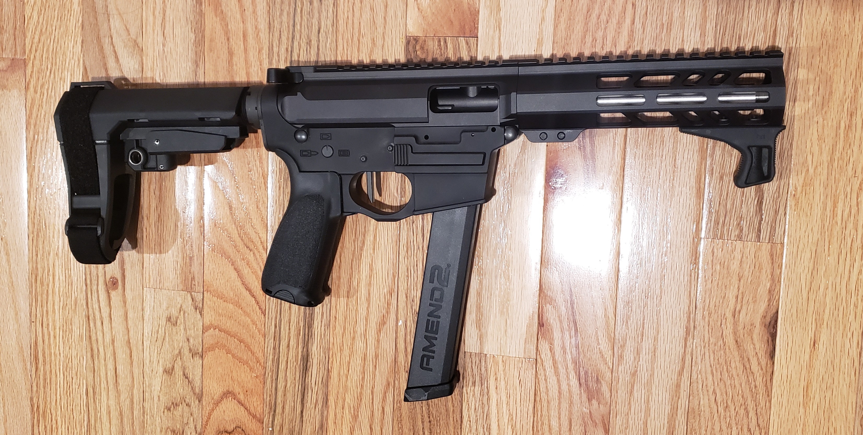

I just completed this AR-9 build using a Odin Works 7.5in 9mm barrel and I took it to the range tonight to test fire. I put the entire 34 rounds though it without a hiccup while firing slow and rapid.
This is a stout little gun and it's about 3in shorter then my Scorpion EVO with the Scorpion's brace extended.
