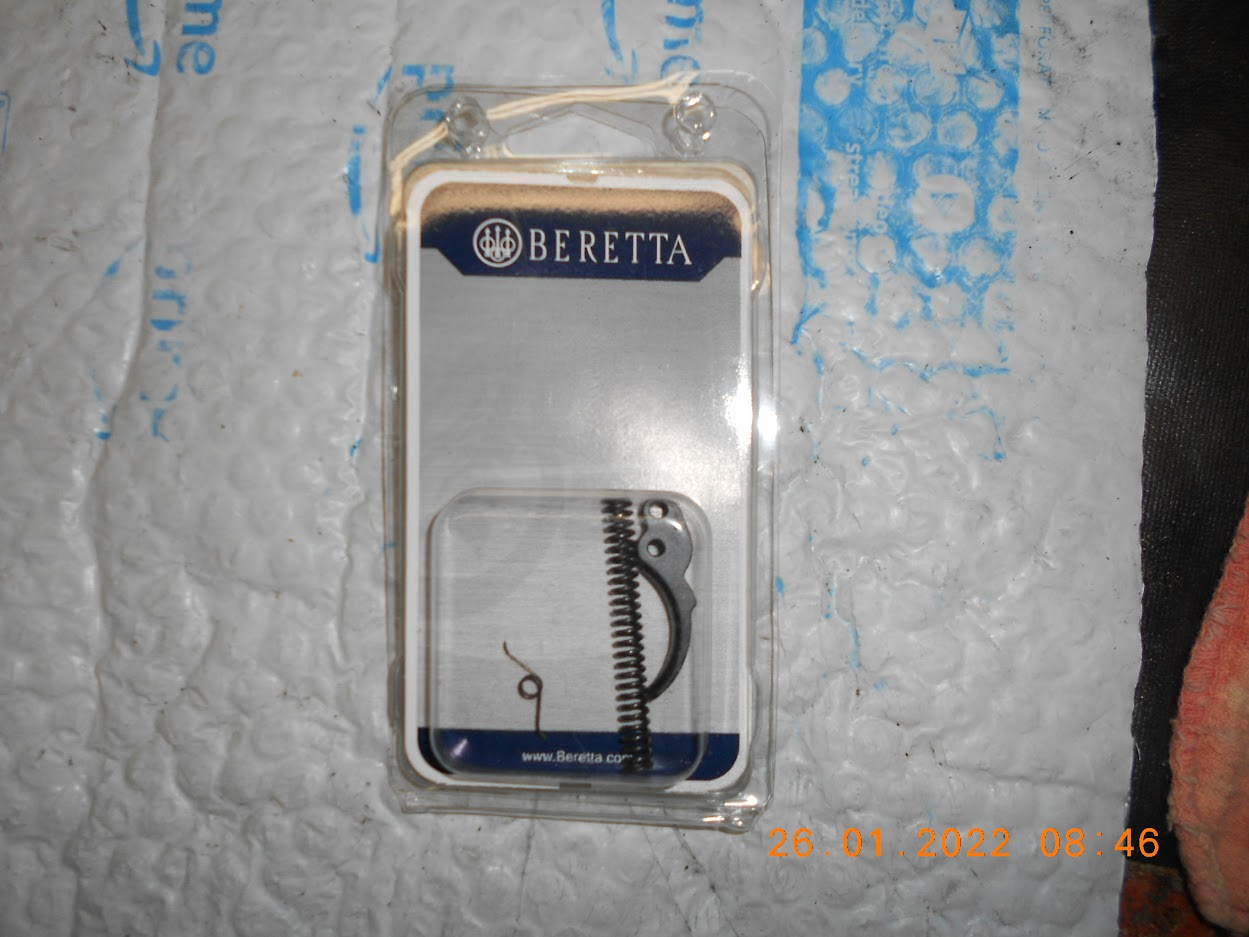

so here are some pics the before pics
the Beretta replacement hammer "D" spring, ss (black coated) trigger, and trigger spring

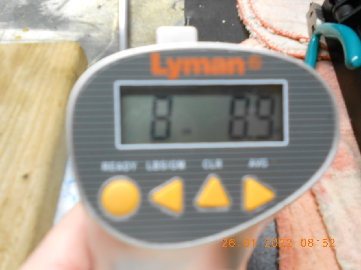

the trigger pull, in double action before the work

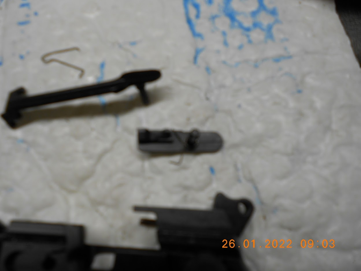

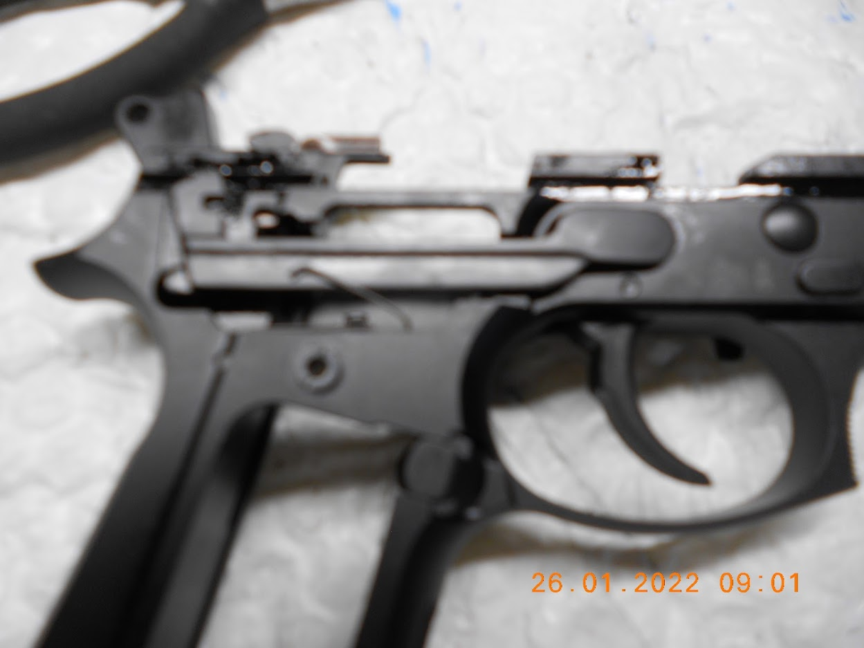

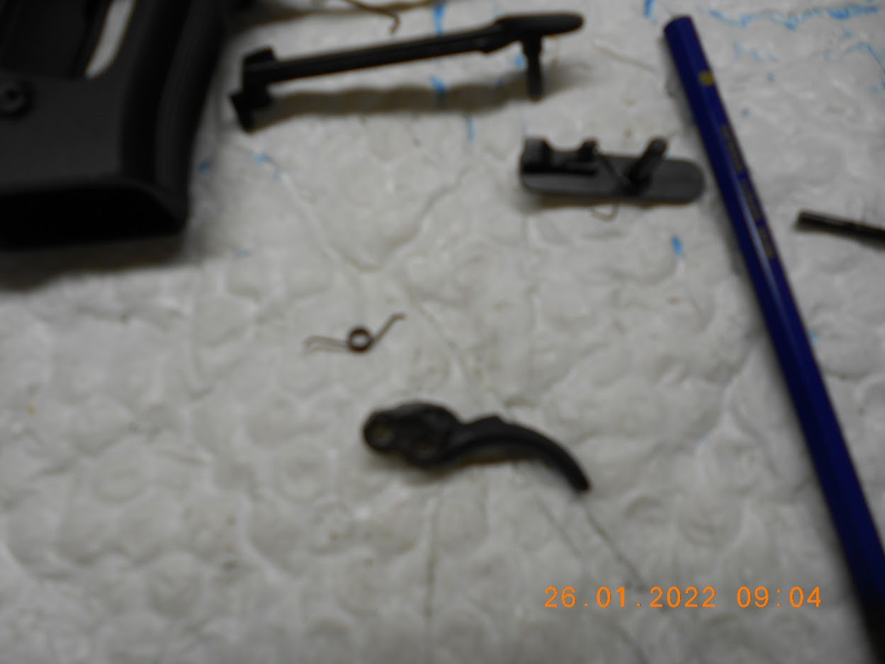

the trigger bar with it's spring partially removed
the slide release, it's spring, the trigger bar and it's spring (all the OEM parts)
the OEM and trigger spring, which the new trigger spring replaces

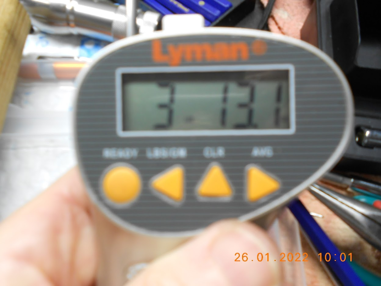

the new trigger pull reading with the Hammer "D" spring installed, the trigger did not improve the pull, i do not like a "plastic" trigger, that's why i replaced it with the SS one.

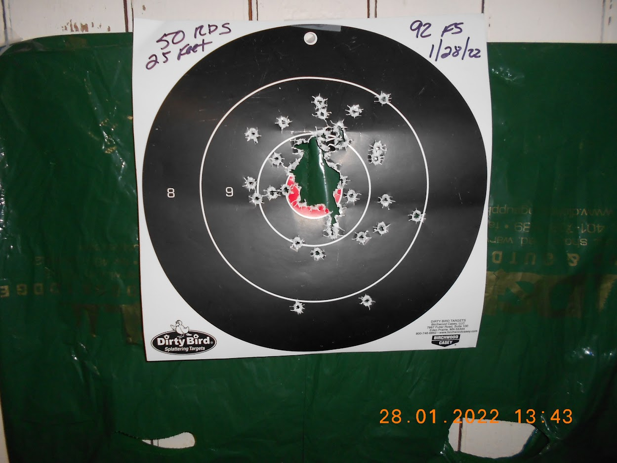

ok, took the re-worked Beretta to the club this morning, shot 1 target, 25 feet away, and 50 rds of factory ammo.
this target is the before one, a couple of weeks ago...
this one is todays...
much better job of destroying the center, yes, a couple of low hits too.
gun ran fantastically, with that hammer D spring, SS guide rod,
the trigger made no difference, other than it was steel rather than plastic.

Nice shootin there dead-eye, that kit made a hell of a difference
the hammer "D" spring takes up the slack and lessens the trigger pull, and it's great.
as i posted the pics of the before pull weight at slightly over 8 lbs. to an after pull weight of slightly over 3 lbs.

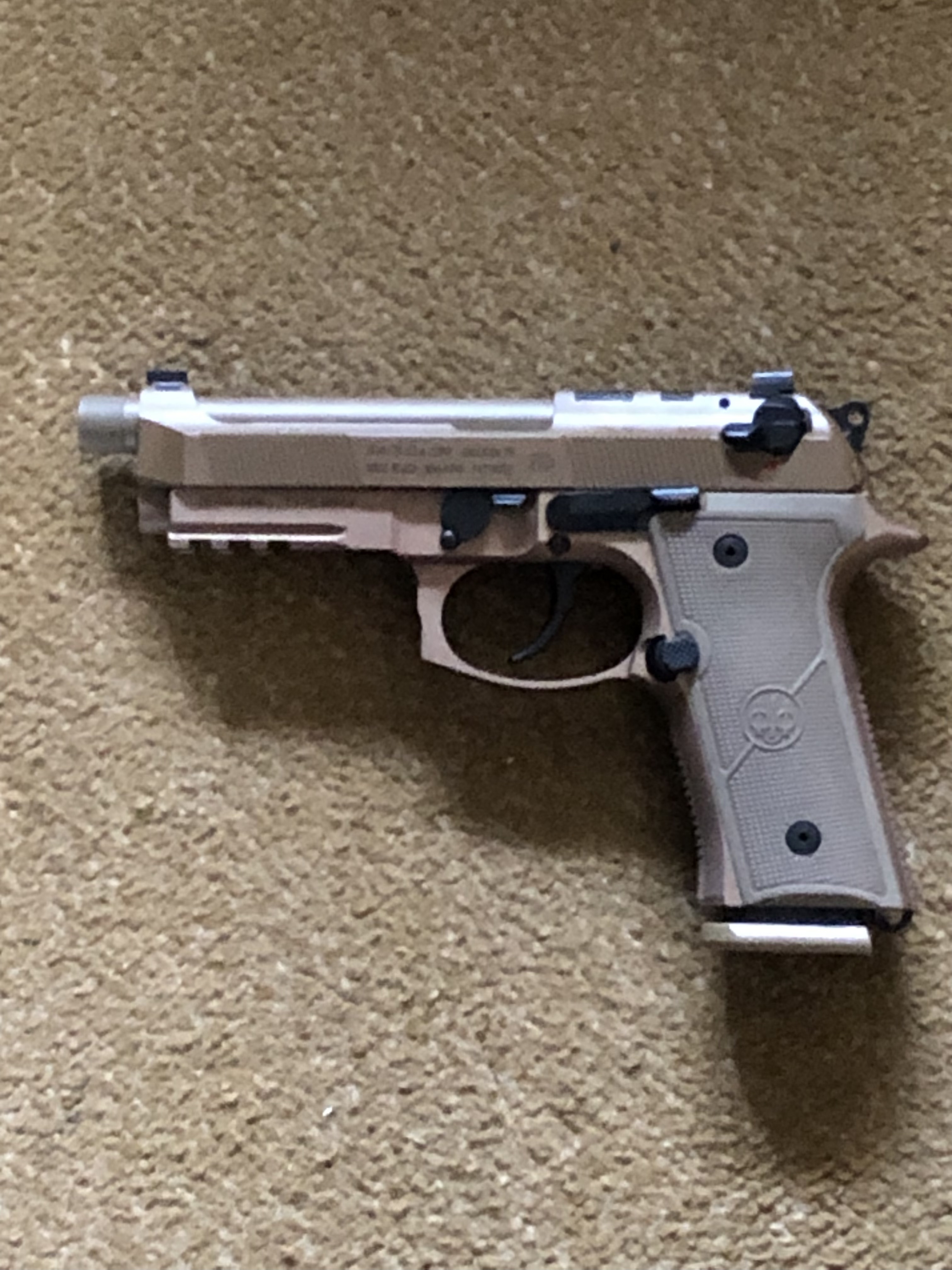

Nice get @Old_Me, I'm sure you'll like it. Well I didn't get a Turkish gun (I have 2 SARs and 2 Caniks), but I did get an actually Beretta yesterday at LGS. In fact it's Beretta’s new recently announced M9A4 Centurion (4.75" barrel) model that came with 3 - 18 round Magazines (due to supply issues, it came with 1 Mec-Gar FDE mag plate and 2 Black plated 18 round mags). I also came with an additional different style grip if one likes the original M9 style. Upon registration (and another Beretta website), you can request codes for 2 free FDE mags & 1 optics plate, when they become available).
