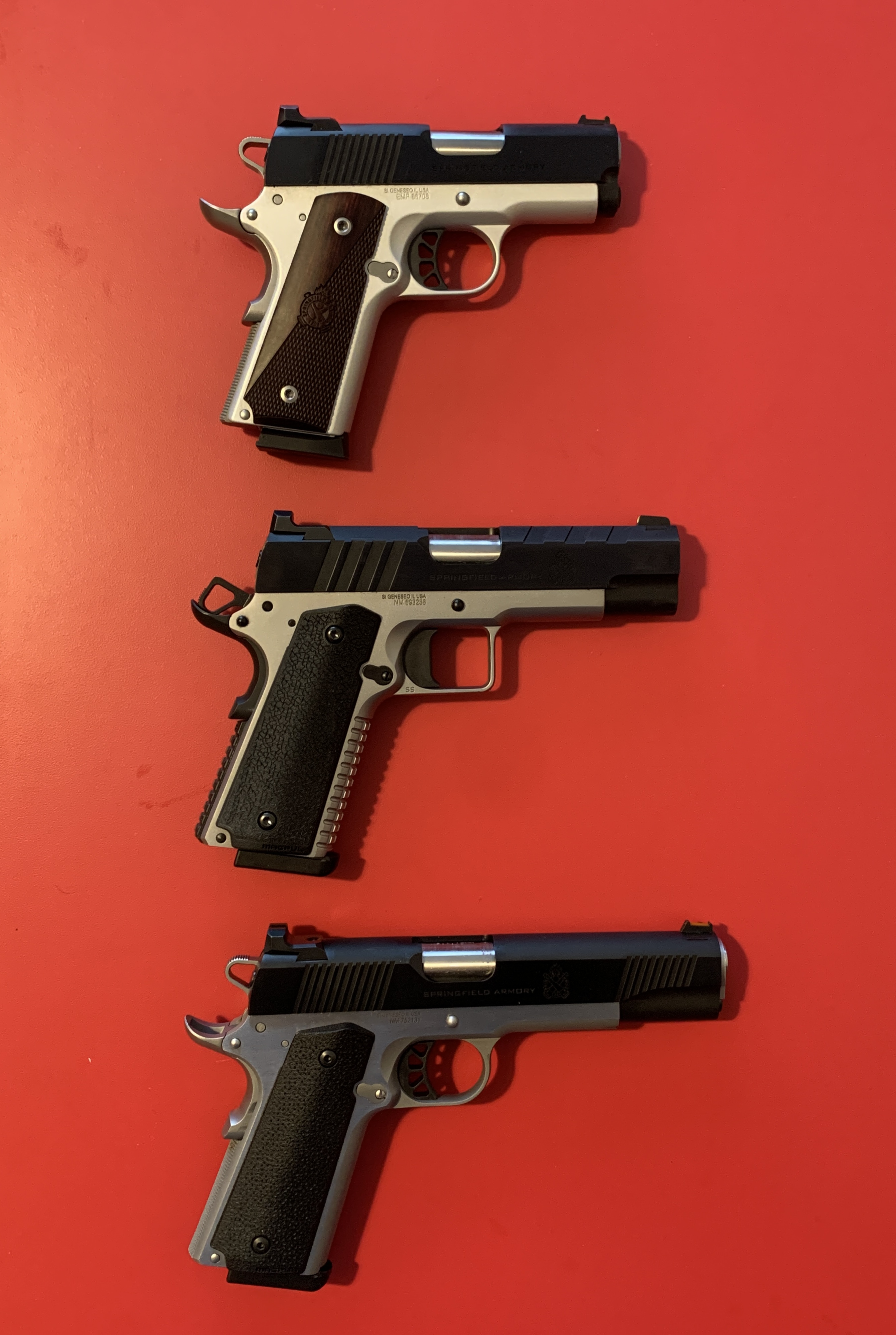

I picked up a new Ronin EMP 3" last night as a retirement gift to myself. I already have an Emissary .45 ACP 4.25" and a Ronin 10mm.
Went to the range today and fired off 100 rounds of MagTech FMJ, worked perfectly. Tried a box of Hornady Critical Defense next and the problems started. Not a grip issue, I have a good grip on things.
9 rounds in the mag, released the slide and it did not fully seat the round. After that, the rounds started diving nose down into the feed ramp almost every round. Didn't matter if it was the first or 9th round in the mag. Sometimes it would feed a second round, but then the 3rd would do it again. Finished the box of 25 and called it a day.
I know 125 rounds is not a break-in and could be part of the problem with the Critical Defense, but with the high price of ammo, both range and defense ammo, I'm not going to keep shooting if there are issues with this and SA CS needs to get involved. I am going to fire off another 150 rounds of the FMJ MagTech and then try the Critical Defense again.
Anyone have any comments or suggestions? Thanks!

The issue is quite likely the Critical Defects.
The rubber “brake pad” in the nose is known to cause failures to feed in several different pistols.
Additionally, handguns have their idiosyncrasies; just because one handgun will feed it, even if it’s the consecutive serial number to yours, is no guarantee yours will…there’s nothing wrong with your pistol.
I’d try a different JHP. Bet it feeds just fine.
