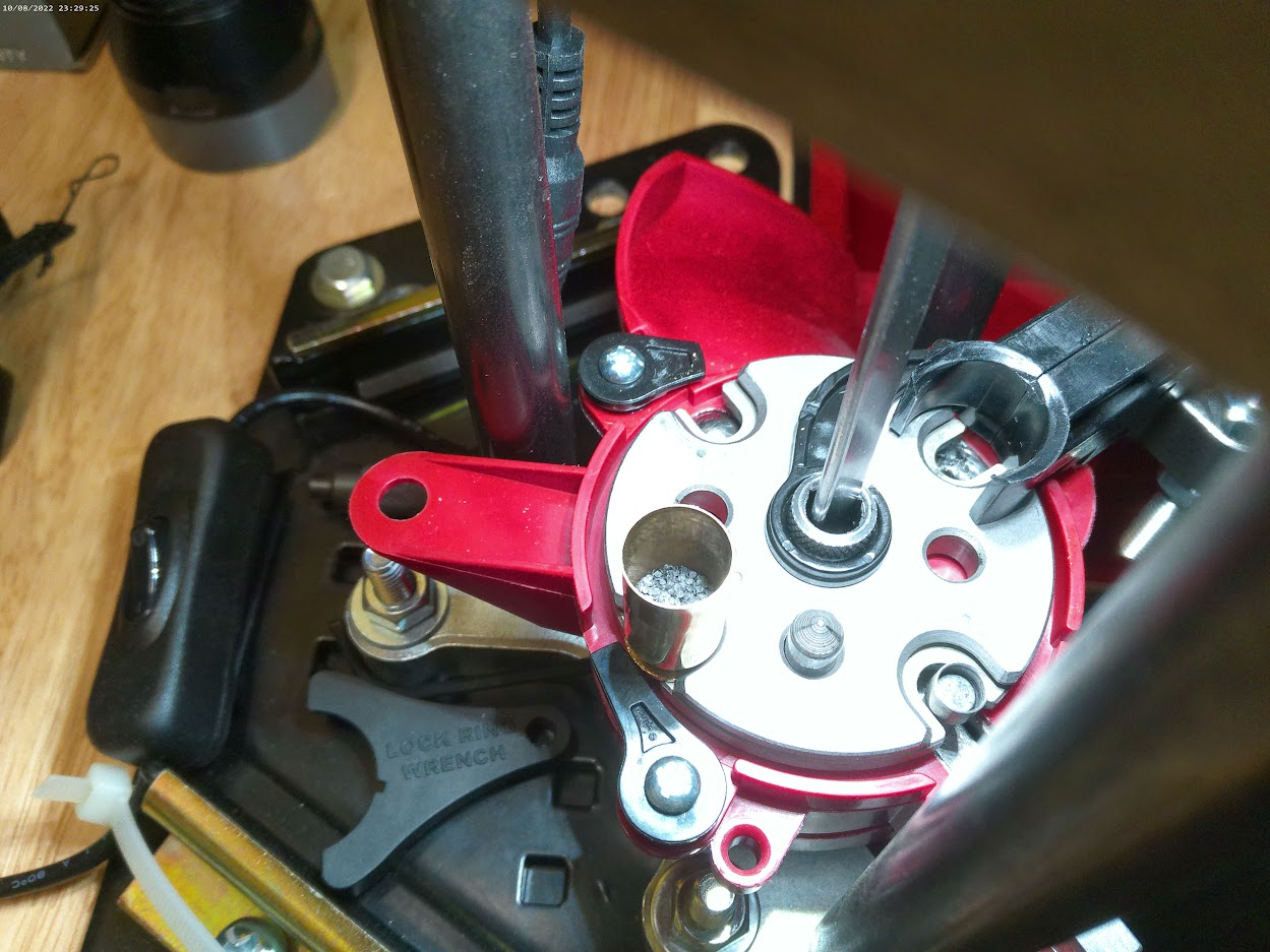

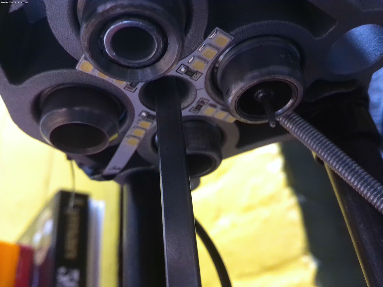

ok, those 2 light kits came in the mail this morning.
i was going to hold off installing them until tomorrow, cuz i am in some serious pain from repairing a window, that is like an SOB to access let alone repair.
but then, i had already seen the installation videos, and thought, "well when in pain, install"....
so i did.
didn't take too much time, the only time killer was clearing off the bench, installing the power strip, and cleaning up.
i got them from... https://kmssquared.com/index.html
and each kit is "about $30 each, and i paid for priority shipping, rather than, "it'll get there when it gets there" shipping.
here are some pics of both presses

also too, i love that light kit.
made checking for the powder a breeze..
