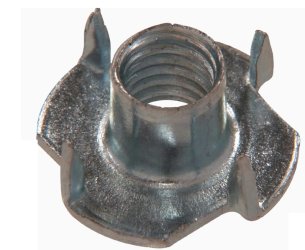

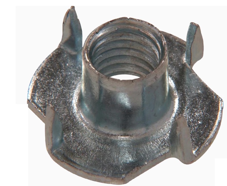

If you want space on your bench for doing other things, you can fasten the press to a piece of plywood and mount it to the bench with one bolt. My 650 is permanently mounted, but I have 3 others that are attached to plywood. I have a t nut attached under the top that I can fasten any press with one bolt.
I can't believe it took me decades to buy an electric heater for reloading. :rolleyes: I also have a pedestal fan for when the seasons change. If you have room, you can get a metal shelving unit to store your reloading stuff. The particle board shelf on one broke under bullet weight, so I replaced that shelve with real wood. No messes so far.

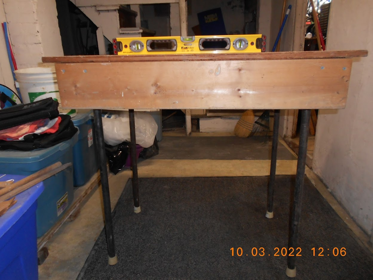

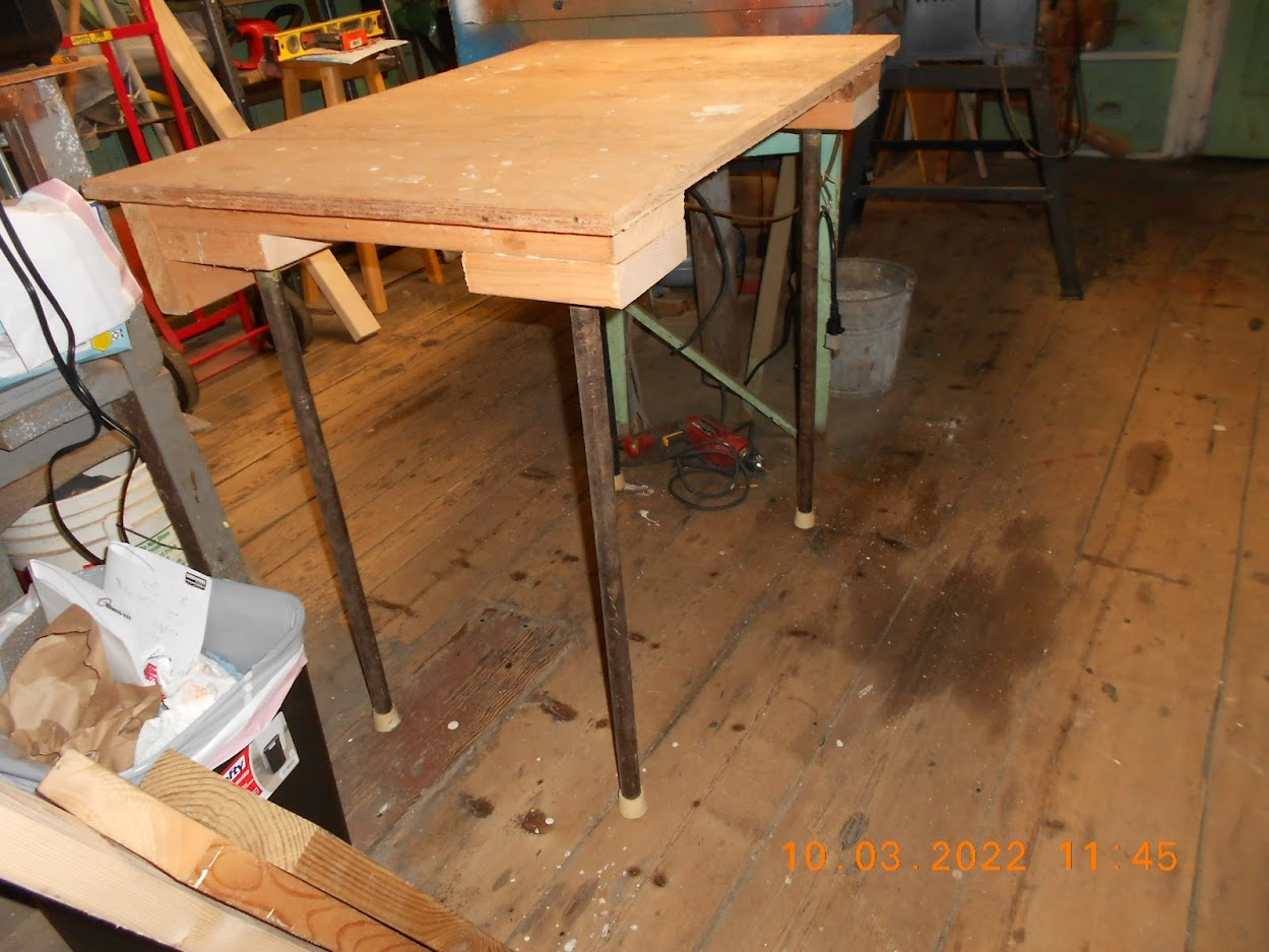

funny you posted about a work bench.
i have a bench in my shop, but i wanted one for reloading only, so i just minutes ago, finished the build stage of one.
in my house, i keep a LOT of scrap wood, metal, nuts, bolts, washers, well you name it, i must have it in a coffee can somewhere..lol
so here are some pics of my uncomplete reloading bench..
#1, this was actually a longer piece, that i had made up, with supports and bracings for our washer/.drier to sit on top of, but then i never used it, and cut it up years ago, for other things, these 2 piece are what was left. (the blue you see is my "work bench", it's really a very old wooden box.
#2, this is the lay out of the stiffeners, and in the middle, you see 2 boards. later, when the press arrives, i will then bolt them down, and then the press plate will be bolted to those.
#3, the orientation of the legs, which i had, from an old 8 foot long wooden table i built for family gatherings, for the holidays.
#4, standing on it's own, no front cover yet
#5, scrap of wood, for the front....i musta done something right, the dang thing IS level..>!!!!
#6,
the backside, (what was already attached when i started this)
i had to lightly sand the top of the table/bench to be rid of large paint splatter. then i had to do some caulking of the holes from previous screws, and when that drives, another quick sanding, then i got like 42,000 gallons of Battleship gray paint..........
this is "normal sitting height", for the time being, if i need to raise it higher, i might just make riser blocks outta the 27,000 pieces of scrap wood i got.
now, seriously.......i don;t know where it's gonna go.......it measures 24" deep, X 36" wide......
i may have to get rid of my 2 snow throwers to make room......:eek:....:LOL:...:rolleyes:

I didn't like the t-nut being on top, so I drilled threw and put the t-nut on the bottom. Made it more sturdy.

Old Me, looks like you're well on your way...keep up the good work! If you find your bench wobbles from the force of operating a press, you might consider triangular braces on the bench legs, as well as a bracket for bolting the bench to a stud wall behind its eventual placement position. It might be sturdy enough as is, but if it's not, pretty simple fix...if you have concrete walls in the basement, anchors are cheap and easy to install with a hammer drill (heck, a regular drill would be plenty for only 3 or 4 anchor holes...). Sorry if you already addressed this in an earlier post...
actually i do believe i will have to do some sort of "bracing". but my situation is this, one one wall, i have a brick support column, and very little actual wooden area to support bracing, that's one area.
in another room, i have a 20 amp electrical wall socket, (for a portable heater, fan, coffee maker, etc) but NO room to put the bench up against that wall, or even near by.
in another room, it faces the city street, ground level, and only one overhead light bulb, and limited wall spacing.
living in an old Victorian home, limits what and where i can do this, and i simply cannot take this equipment up into the house, as the only real "spare room" is reserved for when the grand kids do a "sleep over"........
so even though the equipment is "due" to arrive this saturday, i have way more things to figure out.
