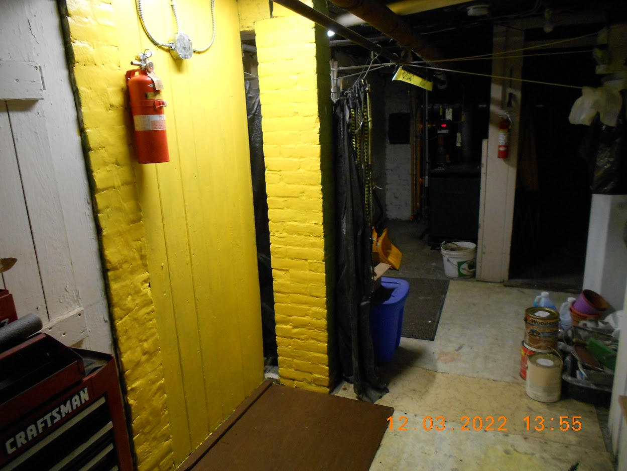

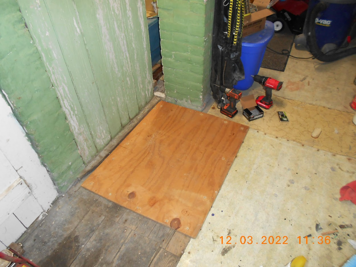

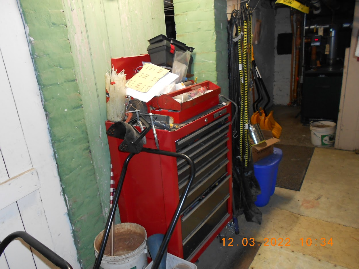

ok, so the Lee press and what else i ordered were due to arrive "sometime" today, via UPS.
in the meantime, i had to make ready the location of where to put the bench.
there are still many things to do, and i only have so much time to do it all in.
but here is a start
1) this is where (now was) my tool box sat for like umpteen years
2) the basement flooring is uneven, so i put down a board, and that green paint? been there i believe since 1860
3) like i said in an earlier posting, i'm a saver, this paint color, we used for a room, and i had a LOT left over....and last summer, i had a boatload of electrical work done, and i had the electricians install a light in the area, specifically for my tool box.....good thing i did, cuz frankly, i never gave it any thought then, that this would be where the reloading would be done!
4) while doing this work, and finishing up the painting of the floor board, the UPS guy arrived.
i just did not want to unbox the press...that's for like maybe a few days away, i still have to drill holes for the mounting plate, (in this bench pictured) and hope that there will still be room for the "new to me" Dillon i'm picking up Monday.

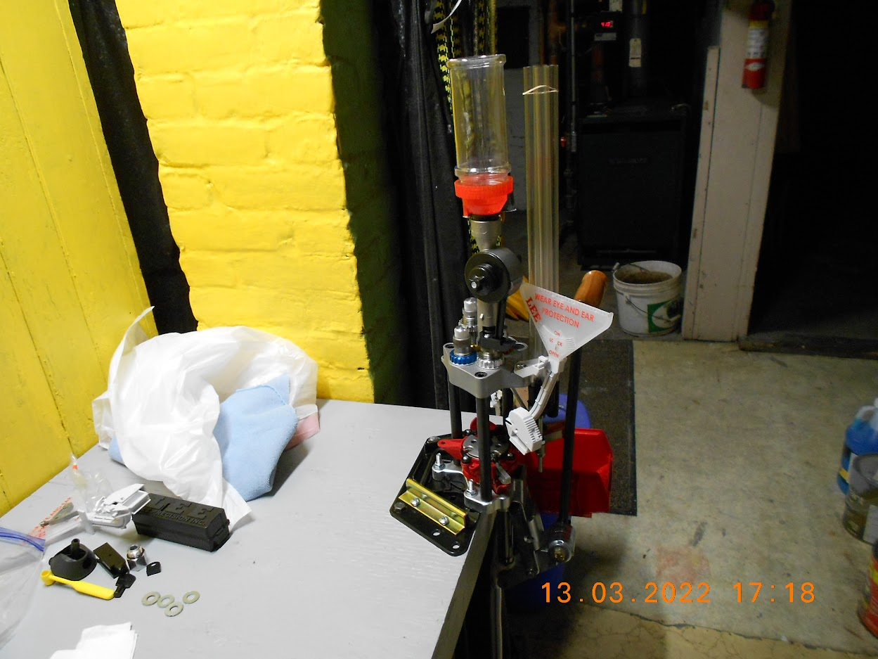

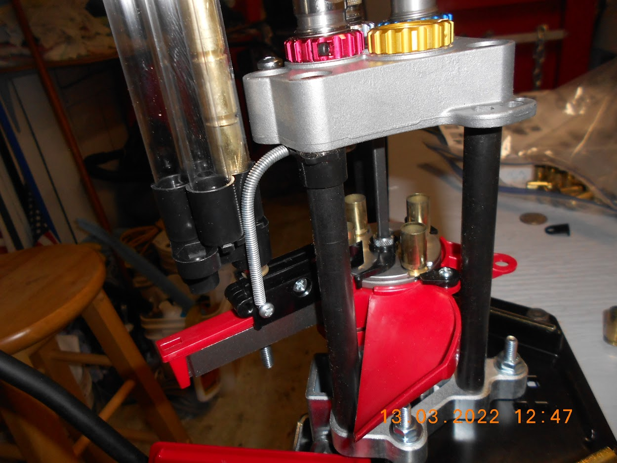

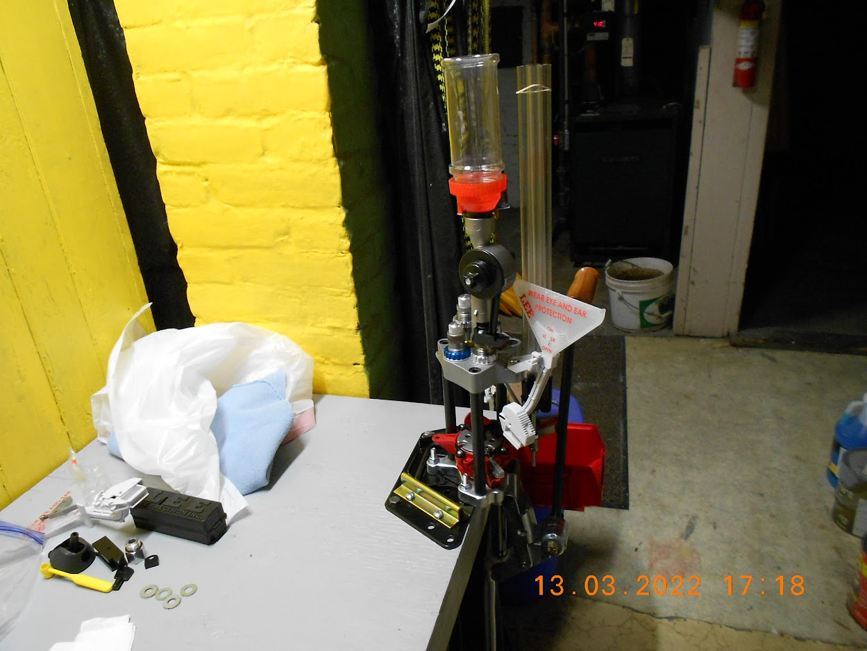

well, i found that to set up a press, even though it was "pre-set up" from Midway with the dies, it is still time consuming to do the finishing touches.
here is the base plate and the press on the bench. frankly, i thought the bottom plate was supposed to go under the bench for support.
the "gold" locking nut, is for the crimping die i still have in install, on another day
here in this pic, the spring would bend every so often
it would almost always be much better, like this
i also noticed that every so often, the plate would not advance, if at all, and then sometimes, the plate would not line up with the stations.
so what i did was, put a couple of drops of Hoppes on the shell casing pusher(?) and the bending spring stopped, and the shell plate advanced like no tomorrow.

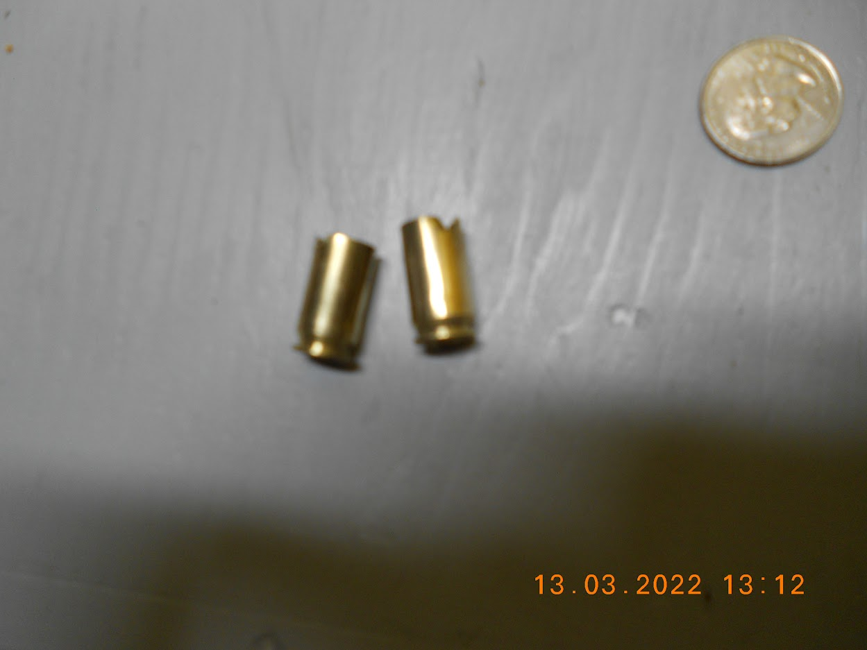

this is what happened as i was practicing de-capping..
so this happened to only 2 casings out of 60
i did have to do quite a few all over again, as i guess i just did not go fully up the the decapping die.
i had a heck of a time, setting up the case feeder, i had to stop, go up 2 flights of stairs, watch a video, go back down, try again. (that pic is in the same one as the bent spring)
and honestly, i had to do that more than once.

I would highly encourage you to read the instructions completely and carefully. They were written by the people who designed and built the machine so they probably know the little quirks ............ you'll find several tips that will make life better. Voice of experience talking here! (y)(y)(y)
Old_Me
Hellcat
i have gone thru the instructions, can't recall anything about that piece not sliding smoothly, but i'll go back
Old_Me
Hellcat
well, went thru the instructions, and only from the overall picture of the press, they point out "lube points", which i did take care of. i used Hoppes oil. as for the ram, they recommend STP oil, but no specific viscosity, so i hit the ram with some Hoppes as well, until i can fill up my small hand pump oiler with some motor oil.
