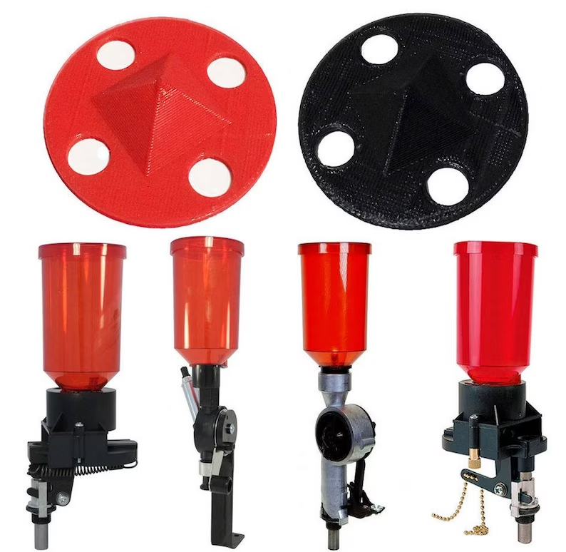

ok, the dies were all properly set and adjusted. Lee carbide dies, like all my other dies in the Dillon or in the storage container...

got maybe all of about 60 done and KA-BAM.....the powder drop went for a consistent 3.4 (starting charge per Lyman book for Bullseye powder), down to like 1.2....2.3....1.4.....

i went to my pc desk, went to Dillons website, and ordered up another powder drop, then the stand as well, so that i can put that onto the DIllon tool head that i have set up for 9mm, and ran flawlessly about 200 rounds....PERFECTO.....job well done Dillon.

took out the baffle i had bought for the powder drop.....nope, still not dropping 3.4 grains.....like WTF...

the powder drop die just did not do it's job.
