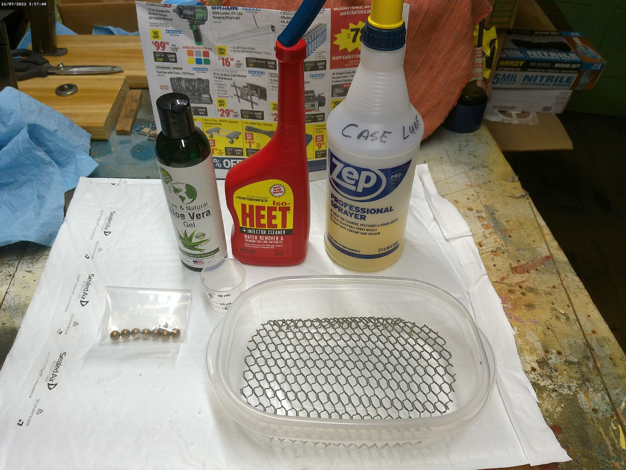

the owner/reloader of the bait shop, gave me his "recipe" for his gun lube, and i made up a bottle's worth.
1 bottle of HEET gasoline anti-freeze...(red bottle) and it is a 12 ounce bottle
1 ounce of aloe
spray 2-3 shots into a plastic bag, dump in shell casings, in this instance i only dumped in 100 of the new Starline
shake, empty out, let dry.
seems to have worked, i used the Dillon again.
reason why i say "seems to have worked".......it seemed like i didn't need to use too much pressure on the ram handle.
very loose grip.
i'll try it more, especially when the Lee 9mm parts come in.
but i think too, that maybe i could have lubed many more casings, as there is residue in the plastic bag
another thing i did later was to cut up a hard metal screening material, bend it, fit it into the plastic container.
as there was residue in the bottom of it, resulting in some of the casings to sit in a "puddle"
this will now allow the mix to fall to the bottom, allowing the cases to dry faster, without sitting in puddles.
the owner gave me a bunch of small metal balls, to put into the spray bottle to "agitate" the mix..
and to measure 1 ounce, one of those medicine bottle caps, works great, 30mL comes super close to 1 ounce.
