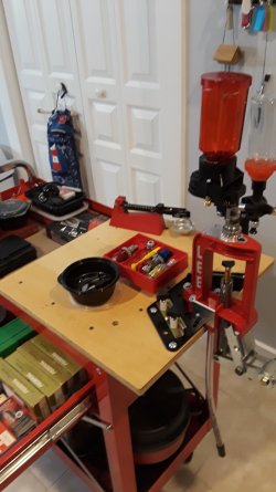

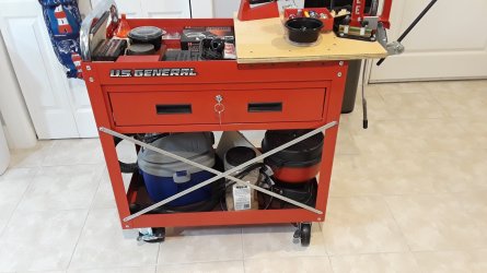

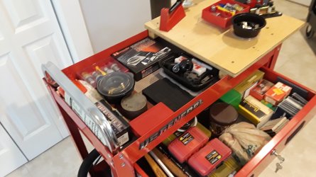

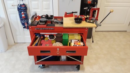

And for the table ..... I don't know about 45 lbs. I don't think I've ever used or known of a loading bench that lightweight, but I can see how it would be easy to lift with the leverage of some of this loading equipment. Here living in this apartment, I don't have room for a very large bench so I set up a 16" X 32" roll around tool cart that doesn't weigh but about 10-12 pounds. Even after adding all my presses, dies, bullets, powder, and all other necessary things, it still doesn't weight but maybe 30 ponds. To make it work for me I have to sit at one end while I'm working the press and put my foot on the edge of the lower shelf to keep it from lifting. Or, I'll use my left hand to hold back on the press while I'm lowering the ram with the right hand. I'll try to attach a few pictures to show you what I work with.

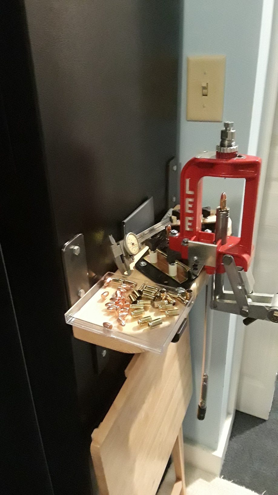

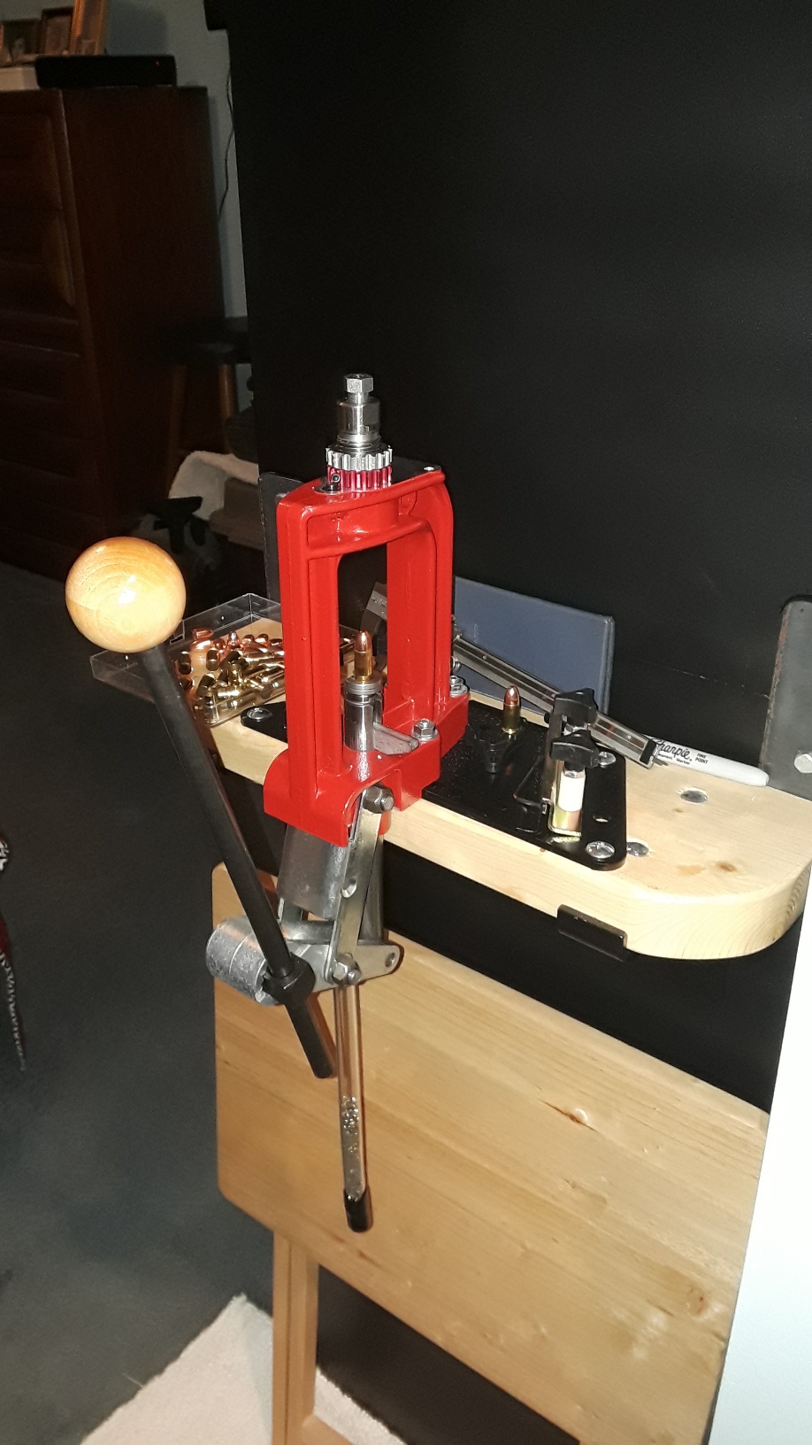

The first two are from when I simply bolted a small shelf to the side of my gun safe and mounted my single stage press on that. I sat on a bar stool in my bedroom loading, and had to put all my tools and components on my bed. The wife wasn't real crazy about that so I bought the cart and added a table to it to mount my presses, etc. But like I said, it's pretty lightweight so I just step on the lower shelf to hold it down. As an aside, even without stepping on it, it doesn't lift when using any die except the #1 sizer die.
