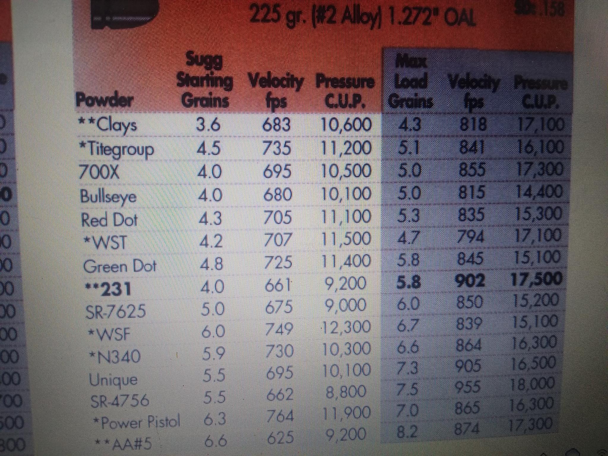

so i then poured in the titegroup, dialed in the charge (i am still doing starting charge specs), i dialed it in at 4.5 grains.
2 of my books, the Lyman says 4.5, the Lee says 4.4....
the Hodgdon site calls for 4.0 starting, and 4.8 max. so both books are with-in specs, but just above the hodgdon specs, regarding "starting charge"

i thought "magnum" primers were supposed to be used for magnum rounds..???
the Hodgdon site says that 4.8 is the starting charge, where the Lyman says 4.5 and the Lee say 4.4.....
so i went with the 4.5, i suppose i could "bump up" future reloads to 4.6 maybe the 4.8....
all my books are current editions, but yes, i do know that things change, regarding charge.
i "kinda like" using starting charge specs, still for a while longer.
i wanna say that "i feel comfortable now" reloading, as long as i follow the book(s), but.......i still want to use caution.
