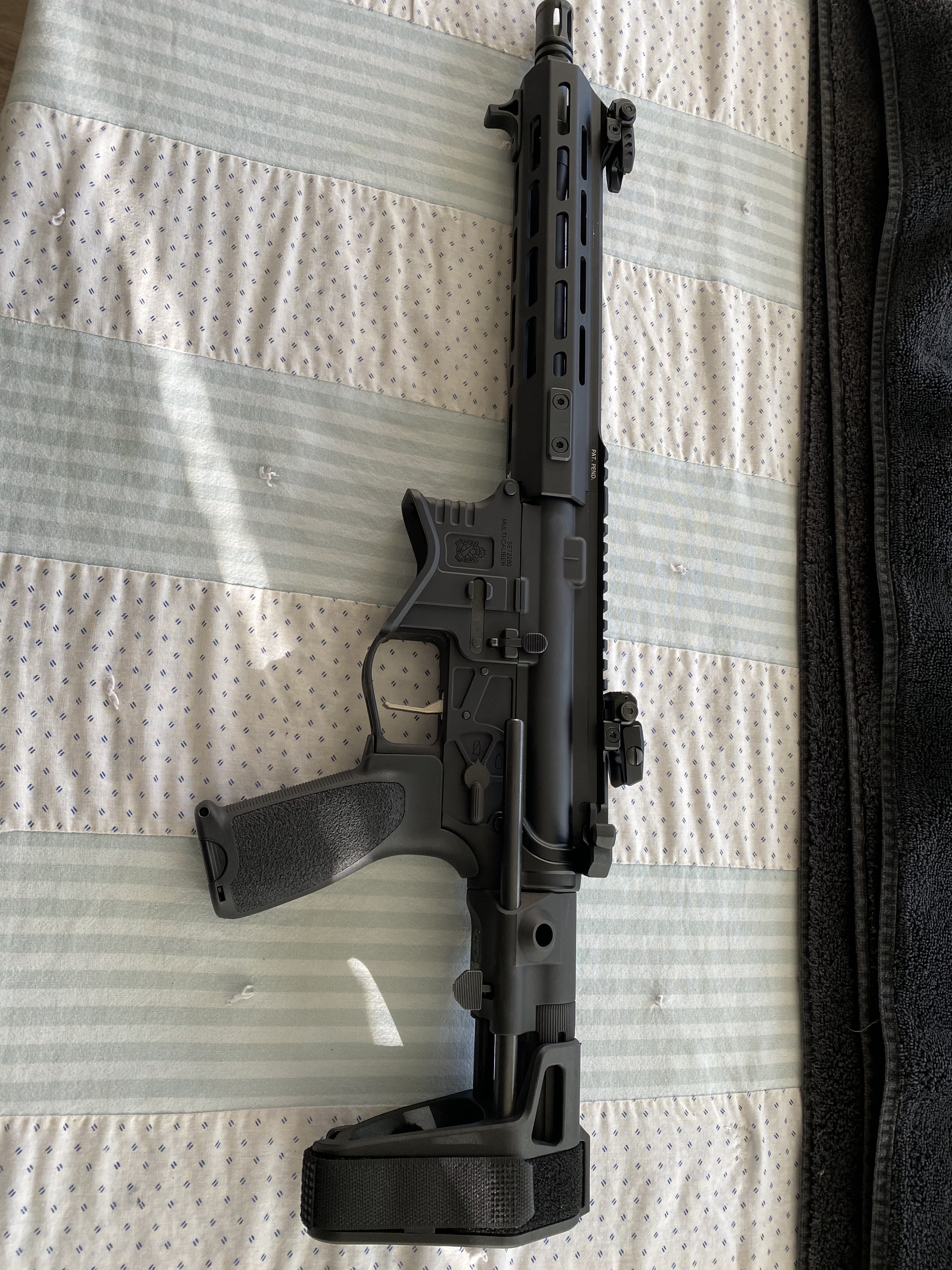

Saint AR Pistol Failure

What brand of ammo? I have had an issue like this with my mossberg jm pro 12 gauge. The extractor was ripping through shell after the shot. Got better shells and never had an issue again.
Not sure if it can happen with rifle ammo though.
I'm using match grade 75 grain from Hornady, which I use in about 6 different AR platforms with no issue. Definitely not the ammo.
Is that the only ammo you have used so far? I had a 1 that the extractor was too tight! Do this with an unloaded gun!!!! Try putting the spent case back in the chamber, close the bolt and then pull the charge handle. Try the 1st 2 steps again and this time stand the gun pointing up hold it about 6-8" above the table and bounce the buttstock on the table. By doing this it will use the bcg, buffer spring and the buffer for cycling. Hold it too where if it extracts the case wont hit you in the face! Bounce just hard enough to get the bolt too move 1/2-3/4 of the way out of charged, so you can see if the case is being extracted! Have you taken a bcg apart before?
This may come as surprise, but not all ammo will work in every firearm.
Some guns don’t like certain manufacturers/bullet weights/styles, loads, etc.
Before you blame the gun, you need to see if it cycles other ammunition without problem.
So?
Could be Hornady had some soft brass go through; it’s happened before.
Try different ammo from a different manufacturer.
I'm awaiting the same response about other ammo. Seems like that was the only 1? I had a to tight extractor problem. There was 3 shims and I remover 1. Now it functions perfectly! In this case any way! Hornady ammo was used when problem started and fixed.
