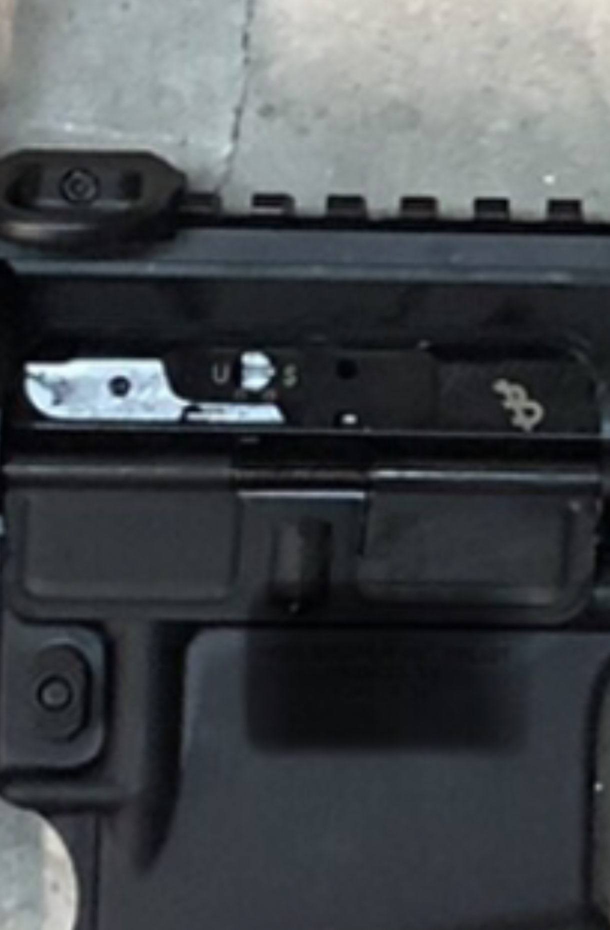

You’ll probably need an adjustable BCG for the suppressed gas blowback.
i used a Bootleg Adjustable BCG for my 10.5” SBR suppressed. Worked flawless.
Can adjust without taking BcG out. Flat head Screw notch on side of bolt at ejection port side. Switch from unsuppressed to suppressed with a screwdriver on one turn and away you go.
edit: here is a pic. Notice the S & U on the side of the bolt and the flat head notch to adjust. Super simple

Thanks. This is necessary because a suppressor could damage this part and somehow this piece mitigates that risk? (obviously Im in the learning phase...)
Lastly would the same one fit on my Victor 5.56 pistol which is 7.5 inch, I know you stated yours was 10.5 inch. This one here?
https://bootleginc.com/product/full-auto-adjustable-carrier/
Failure to function, not risk of breakage.
an adjustable gas block or adjustable bolt carrier are usually needed for shorter barrels due to back pressure of the gases not burned off resulting in the bolt not cycling for the next round.
my 16” barrel Saint AR15 runs a suppressor with no modifications. Straight as is from SA. Runs perfect.
my 10.5” barrel AR15 needed the adjustable bolt carrier as it cycled one round and failed to feed successive rounds due to the gas blowback on the bcg.
Every rifle is different, but majority of the time it is easier to fix the bcg (plug n play) rather than tinker with an adjustable gas block as still have cycling issues.
