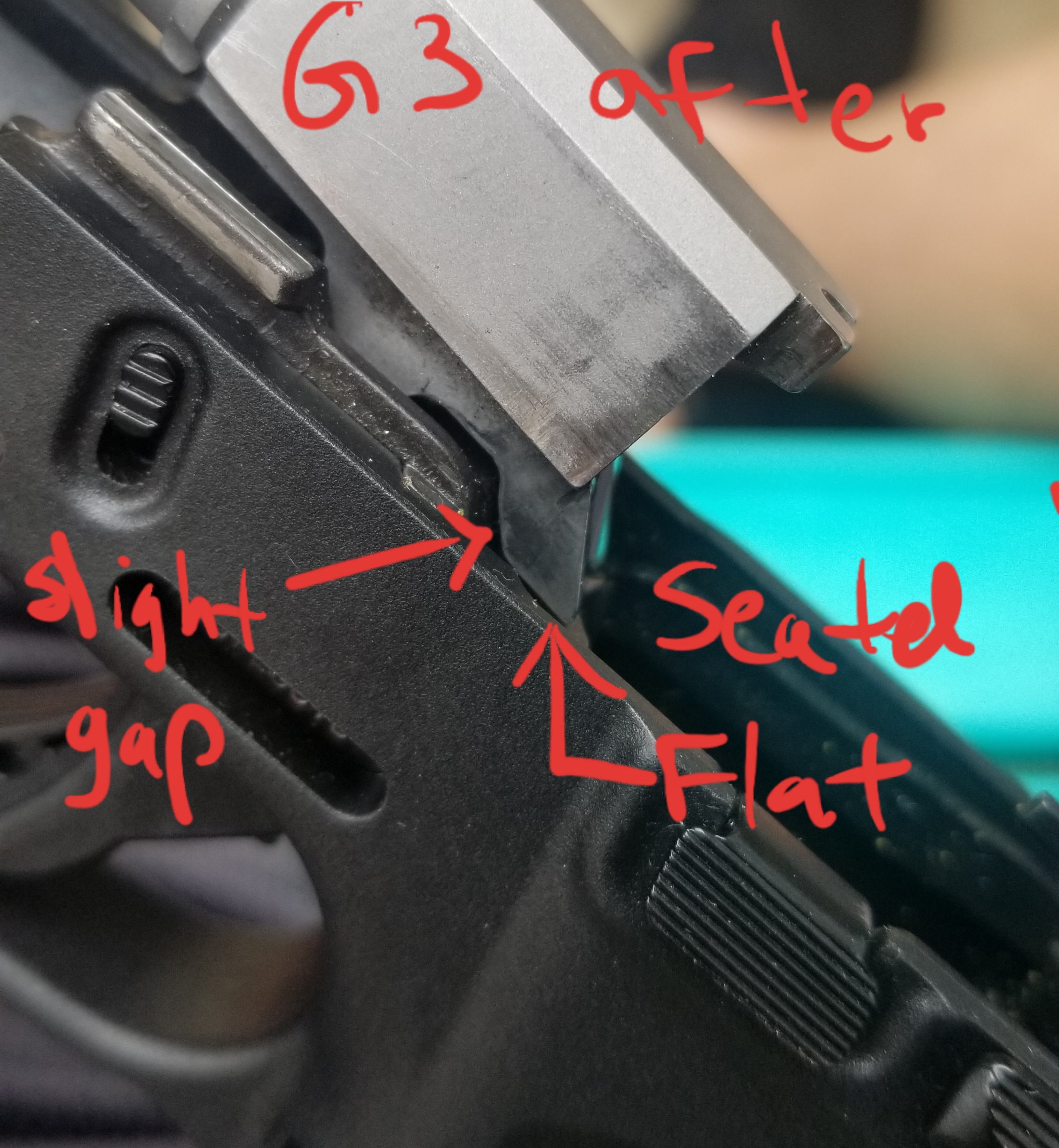

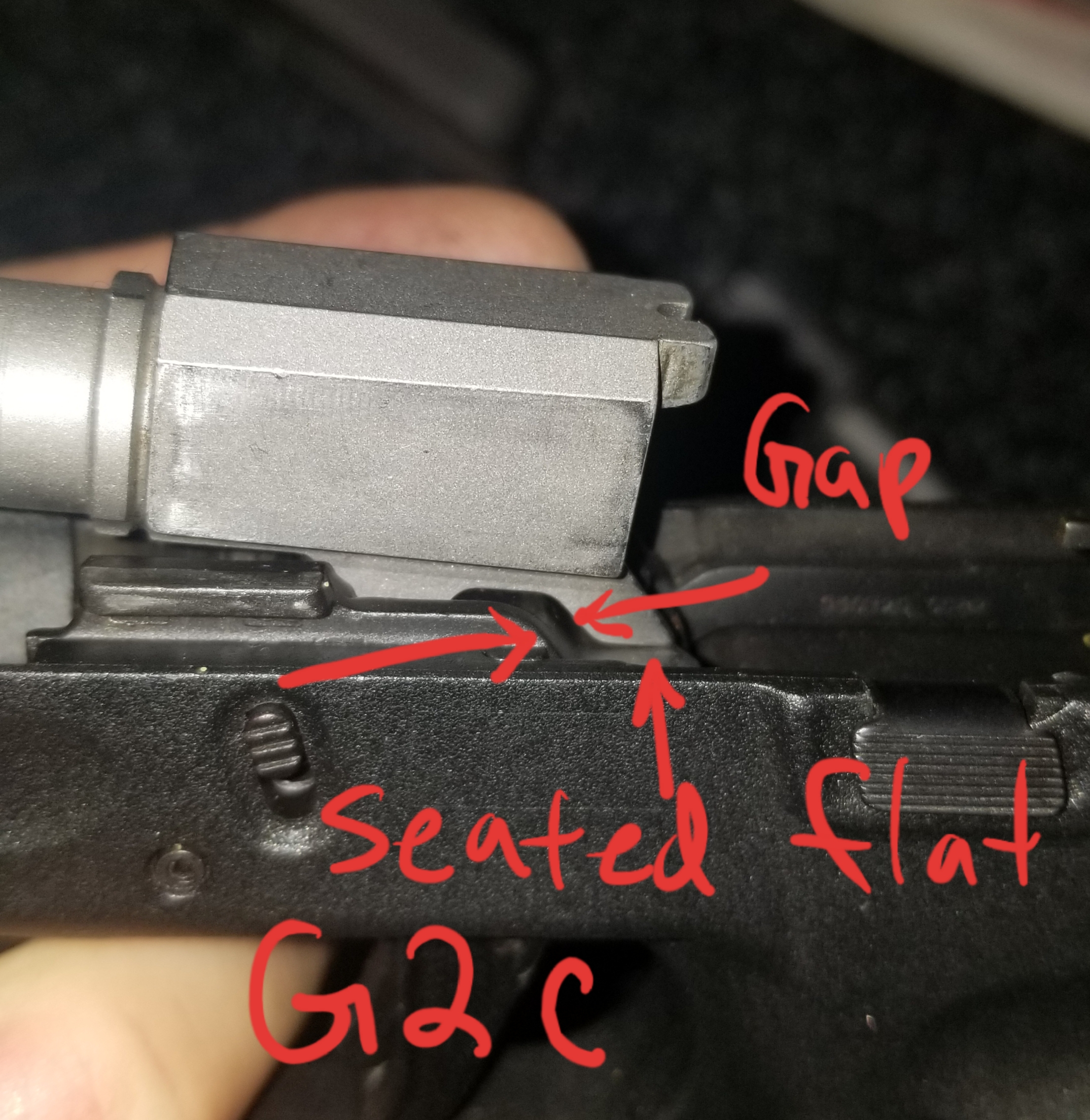

I attached a pic for anyone that hasn’t seen the issue yet.

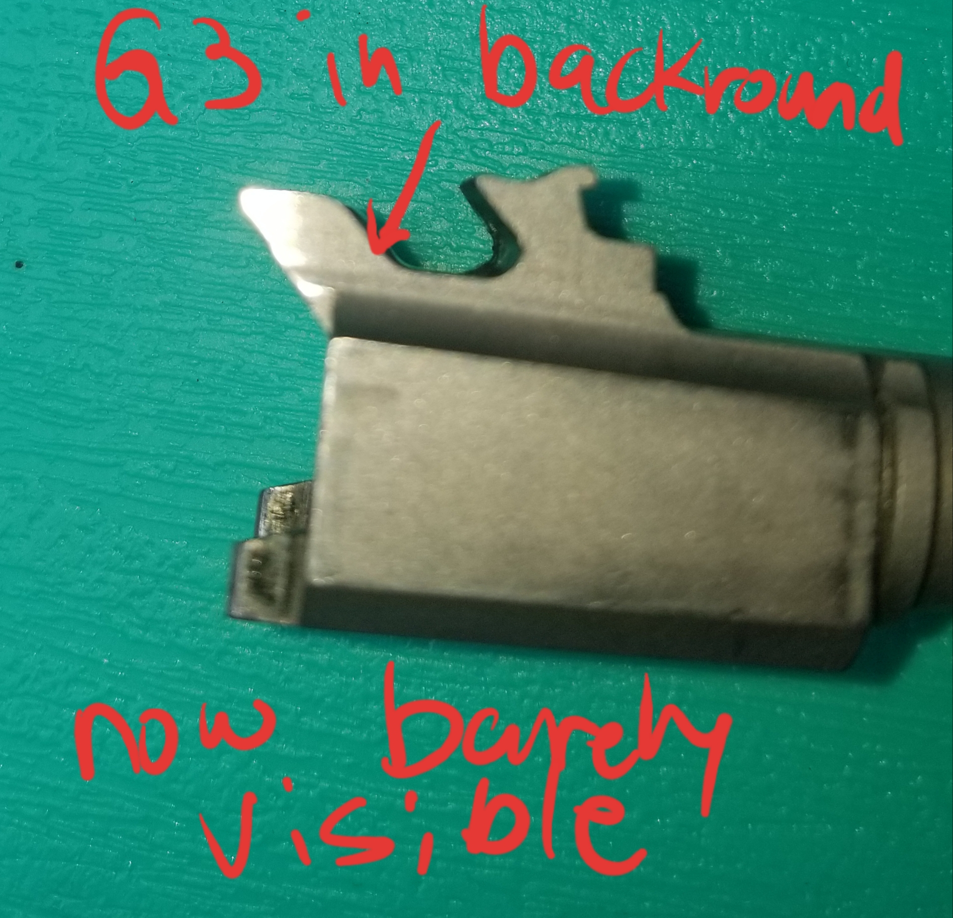

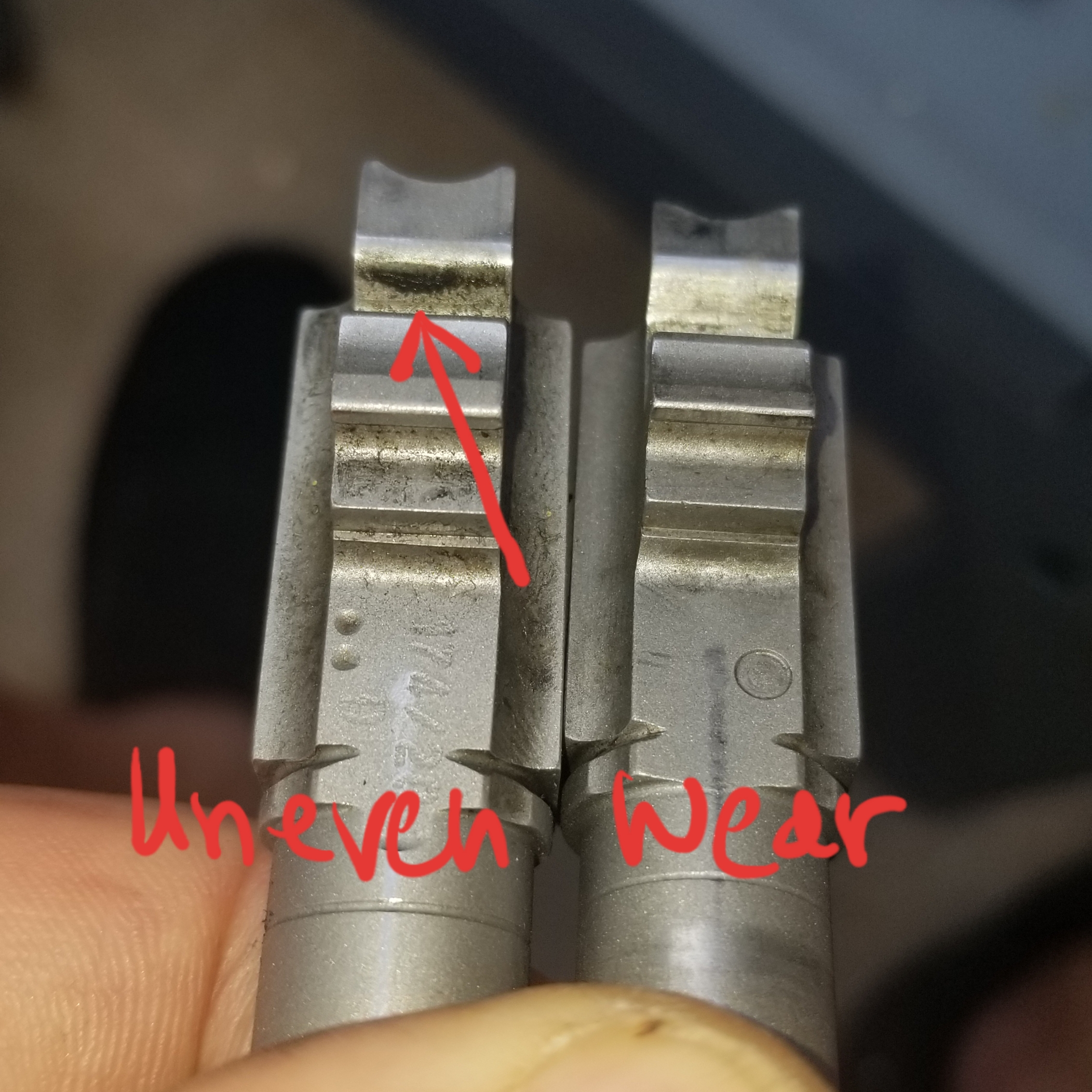

Hey thanks for the post, good to know I'm not crazy...well, not crazier anyway. Your pic nails it perfectly. A little updated information, I started searching around for a G2C barrel to replace the G3C barrel since my G2C barrel seems to be interchangeable with the G3C barrel and the G2C barrel runs the HST rounds flawlessly. I'm attaching a pic, centering on the cut of the feed ramp of the barrel of the G2C and the G3C. The barrel on the right is my G3C and the barrel on the left if the G2C. As you can see, the cut on the G2C, on the left, is much more even and precise. The barrel on the right looks like a much narrower cut and does not look exact like the barrel on the left. I think that may be the issue on why it will not feed the HST rounds. This was just a theory, but I went online and ordered a G2C barrel off of Ebay to test my theory. Here's where it gets weird. The G2C barrel came in last weekend and looked exactly like the barrel on the right as far as the feed ramp cut.....so, predictably, when I installed the bought G2C barrel into my G3C, the first round of HST I ran thru it did the nosedive jam first thing, and subsequent rounds did the same thing, about 5/10 HST rounds jammed. I installed the barrel on the left back into the G3C and there were no jams whatsoever with any kind of hollow point. So, just to summarize, newly bought G2C barrels are not necessarily going to work, I think it all depends on how the barrel itself is machined. I'm no machinist, and I didn't stay at a Holiday Inn Express last night, but I think the machining on these barrels may need some quality control. My G3 barrel feed ramp looks very similar to the G2C machining and it runs HST ammo flawlessly. At this point, I'm going to just not run HST in my Taurus G3C, but it really does make me question it's reliability no matter what kind of ammo I run. I would carry my G2C concealed with no issue whatsoever and I do, but I find myself skipping over the G3C because of the barrel issue. I think if I took the two barrels to a machinist or a gunsmith, that person may be able to machine the G3C barrel to look more like the G2C, and I'm considering doing just that, but I'm also considering just selling it at this point and putting the money toward a Springfield compact 9mm. I have to say, this is the only problem I've ever encountered with Taurus firearms so I don't want to come off as I'm beating up on them or anything, it's just worrisome when you don't trust your firearm, ya' know?

I took out my barrel and inspected the lower edge of the feed ramp. The ramp itself was polished to perfection and the bottom was smooth and very flat. I placed the barrel with the flat bottom down on a flat marble surface and tried to push it from the barrel end towards the feed ramp. The edge instantly stuck/bit into the marble. I got out a microscope and looked at the leading edge of the lower feed ramp, sharp as could be with what looked like a burr across the C shape. I took some 320 grit paper and lightly wet sanded the edge, I had to do it lightly or it would cut the paper. After a couple minutes the burr and sharp edge was gone and it would no longer bite into the marble. Reassembled the gun and it fed round after round of the HST in all of the magazine. Switched back and forth from HST to FMJ until I got tired of racking, not one FTF.
Could this just be a need to lightly deburr that edge? Not sure but this appeared to work for me. I am an engineer but not a gunsmith so who knows. I seriously doubt if the light sanding I did to that edge could change the function of the gun, but I would warn everyone to proceed at their own risk. I just wasn't going to send a brand new gun back to Taurus. Like someone else said, they would probably return it and say nothing was wrong or change ammo.
