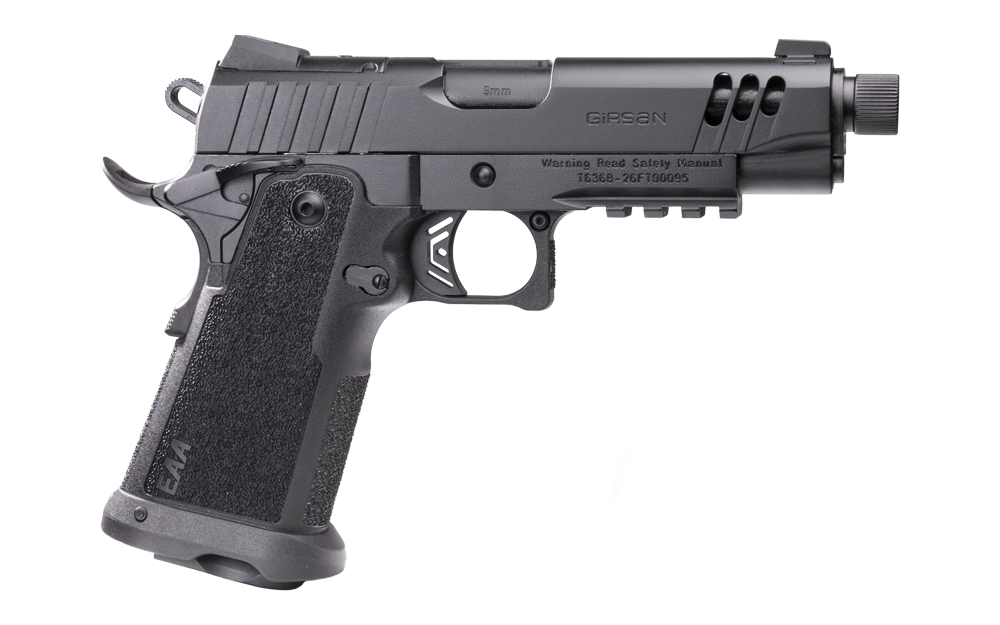

I’m waiting to see that Girsan 2311 as well, shot show video said 999 price tag. Optic ready.
I believe it will take the common 2011 mags, I hope so.

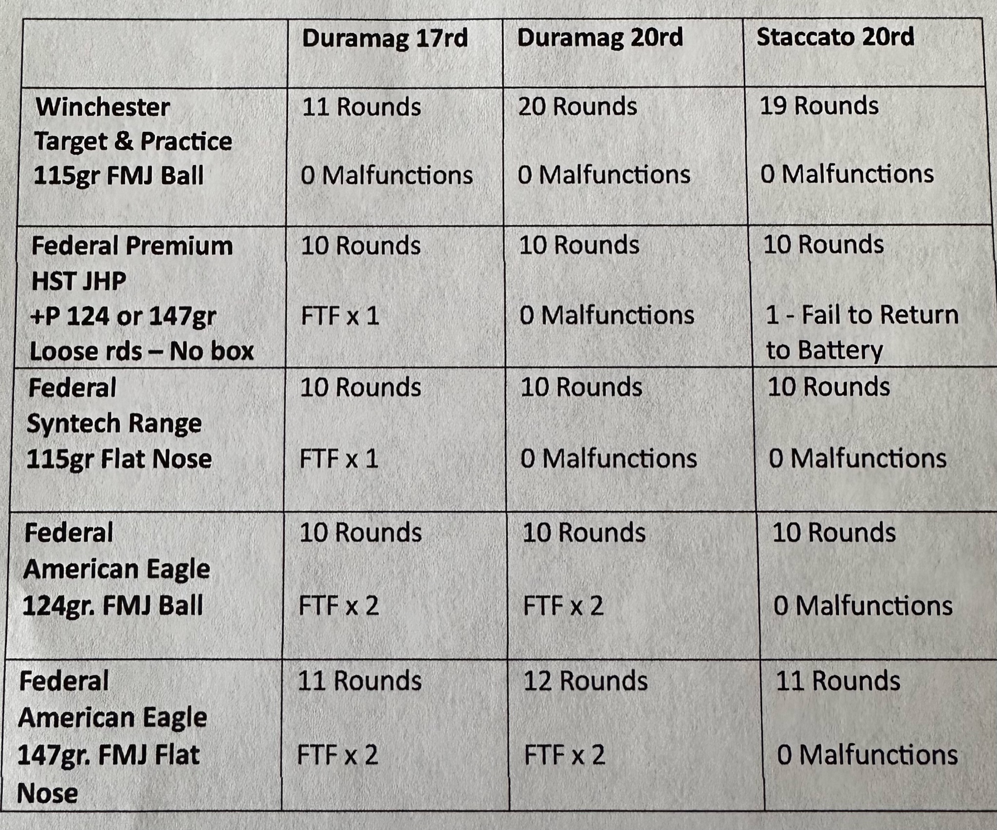

Picked up a 4.25” last week and took it to the range this weekend. I shot 174 rounds of winchester and Federal ranging from 115gr to 147gr. most interesting takeaway for me was that I was significantly more accurate with the prodigy than with my Sig P320. As far as functioning, I have 11 malfunctions. Mostly FTF with a single failure to return to battery. All the FTF’s were with factory mags. I also had a Staccato 20rd mag. It ran well with no FTF. It was with the Staccato mag and Federal HST 124gr. +P JHP that I had my failure to return to battery. The only other issues I noticed is that out of the box the Mag release worked only intermittently and was constantly getting stuck. I also experienced the slide hanging up on the disconnector. Before I shot the gun I field stripped it and cleaned/ lubed it. I had no issues with the mag release at the range. I’ve sent an email to Springfield’s warranty dept. Just waiting on a response.
Mgar, as someone who went through the SA warranty process… call them.
I sent an email that to this day, never got answered.
I called them Monday morning and had an RMA label within 10 minutes.
