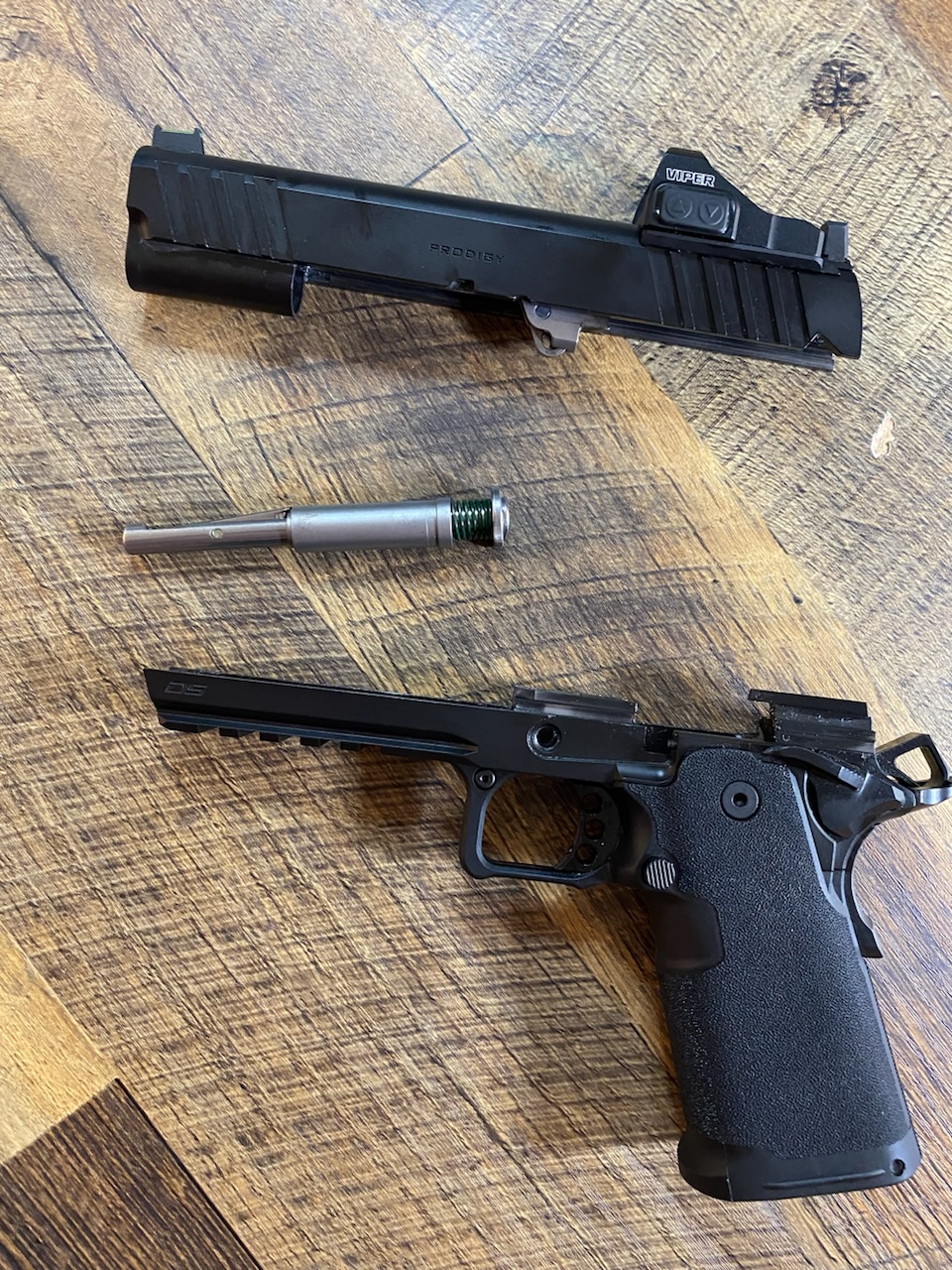

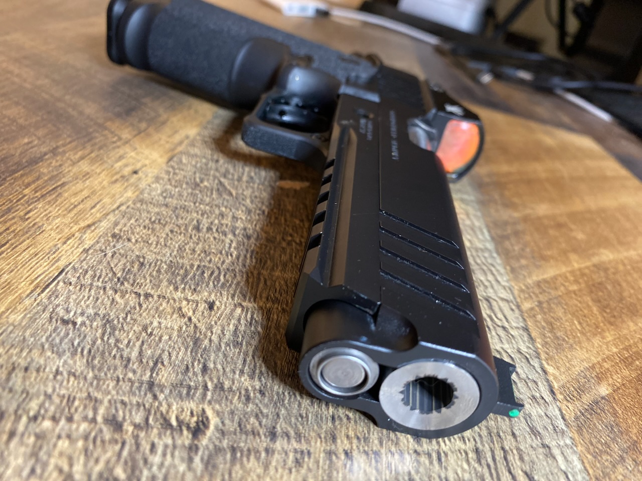

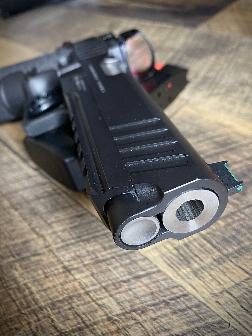

I think I'm going to ditch the two-piece guide rod in the Prodigy Commander, and go with the spring plug and GI guide rod from 10-8 Performance.
For anyone who has already done this - any issues with it?
SimonRL
I ran the 10-8 plug and rod and it looked great, but disassembling the gun can get a bit hairy if you don’t have the spring captured and you definitely have to have good technique and keep the spring from bowing as you put the gun back together. I now run the Dawson Precion one piece guide rod that keeps the whole thing captive and makes field stripping the Prodigy a breeze. I didn’t notice any difference in performance between either.
Dawson Precision.
10-8

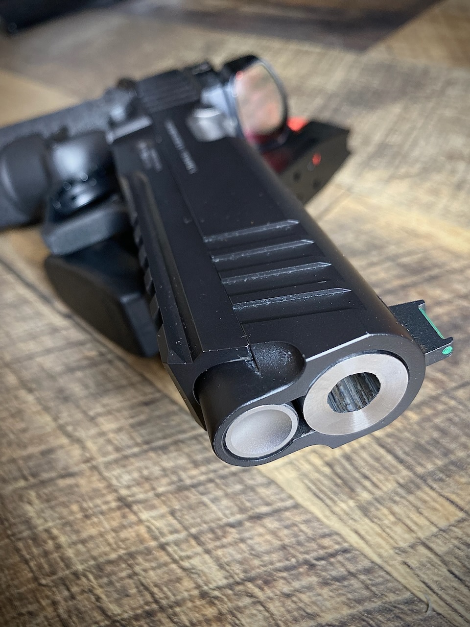

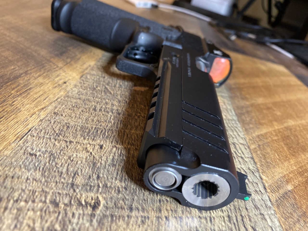

WOW....look at all that fouling in your barrel.......
