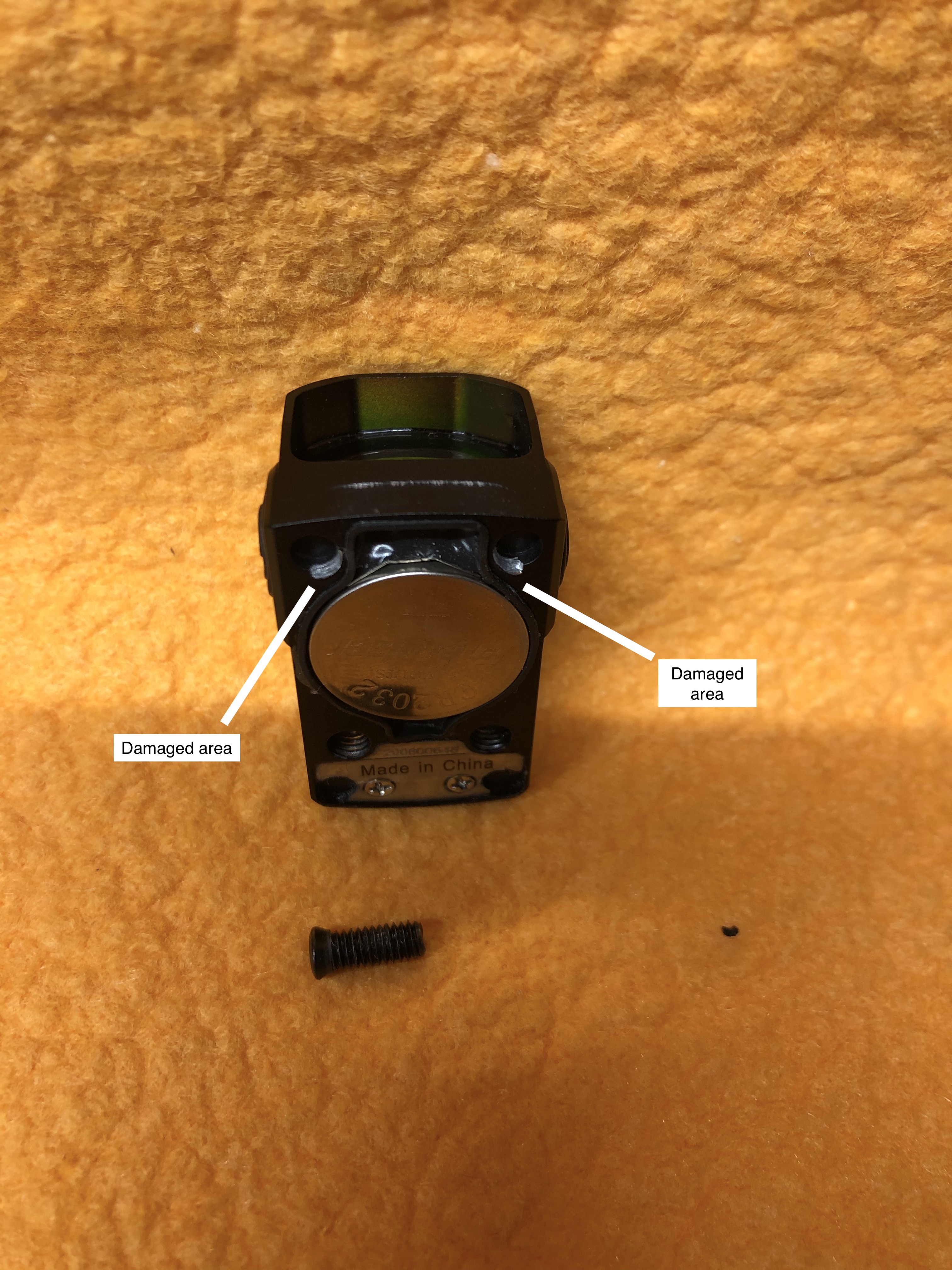

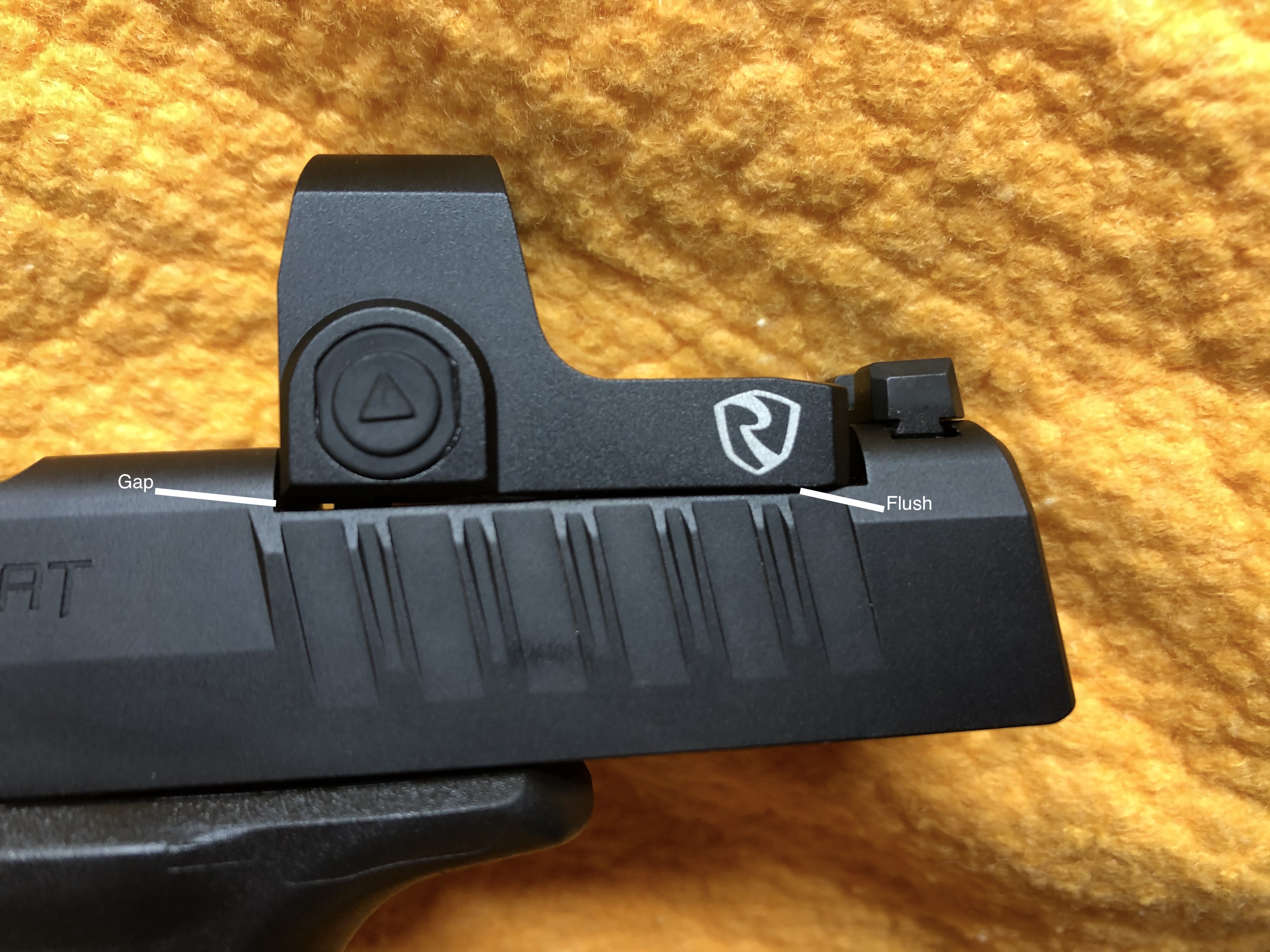

Really like my Hellcat but the optic is giving me some issues. I originally ordered an RMSc from Optics Planet but when I saw the email come back that said it would be backordered for well over a month I cancelled it and looked for other options. I came across the Riton and ordered. I have to say I really like the optic overall, but I'm having some issues. When you use the included screws to secure it to the gun it seems to have a very small gap/upward cant to it such that the front of the optic is not flush with the slide the way the back of the optic (where the screws are locking it down) are. As a result, when the slide cycles, the optic tends to jump up and sometimes doesn't sit back down where it was. It is raising up and the lugs on the slide meant to secure the front of the optic are actually damaging the bottom of the optic itself. I reached out to Riton and to their credit they were very attentive and ultimately replaced the optic. Guess what...it is happening again.
Is anyone else having this issue with the Riton or any of the other options? Based on this forum I looked at the Swampfox and can't find one in stock at the moment but I asked Steel City to email me when back in stock. I don't mind paying for a quality optic, but when I do I expect it to freaking work...not smash itself to pieces.

Roach...you might check for one of my earlier comments (page 10). I had a stuck screw holding the OSP plate in place and had to take it to a gunsmith. After he removed the stuck screw he asked if I'd like him to mount the optic...of course, I said yes. He immediately found that the included screws with the Riton were too long, he ground them down and the optic sits flush throughout. Going to the range on Sunday and we'll see how it functions.

I usually find that I need to set the front of the sight down first until it snaps in place. Then it sits flush and the screws are tightened to 15"/lbs. The screws cannot protrude more than 0.95" on the Hellcat or you risk having problems. Properly mounted there should be no way for the sight to move as yours appears to do. I have mounters Romeo Zero's, RMSc and 507K with no issues but I dear to the screw length stated in the manual on page 21 and torque requirements as stated with the optic (varies from 9"/lbs to 15"/lbs depending on manufacture).
