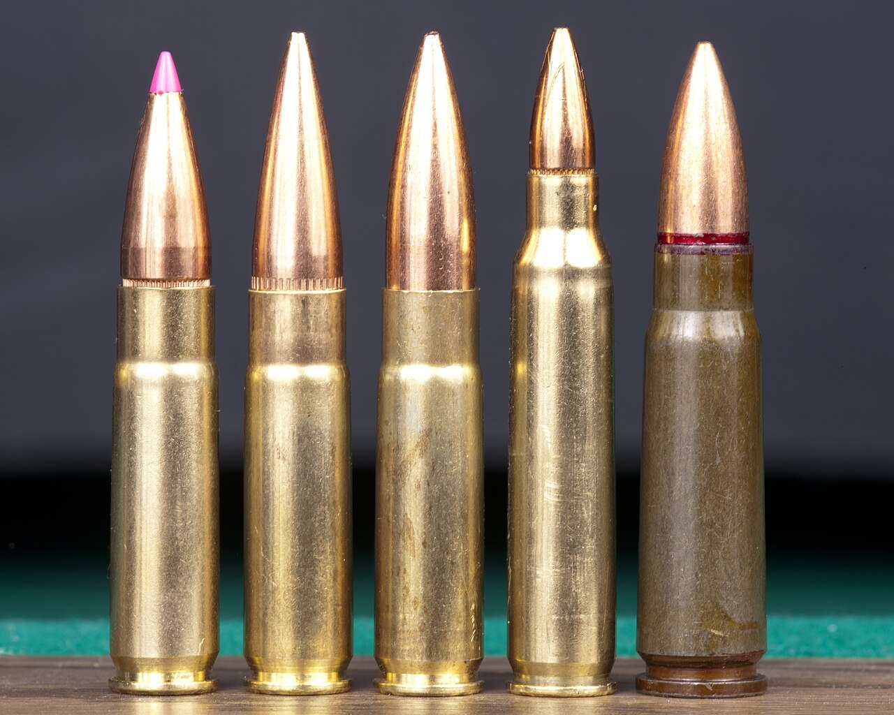

.308 ammo ? I thought you said 300BLK. You know those aren't interchangeable either right?
By 308 I was referring to the diameter of the bullet not the cartridge.
300 Blackout also known as as 7.62X35 has a bullet diameter of .308. While 308 is commonly associated with the 308 Winchester cartridge, numerous other cartridges utilize a 30 caliber bullet diameter such as 7.62, 30-06, 30-30, etc.
Bullet diameter is typically the diameter of the grooves in a barrel, while the barrel/weapon is often identified by the diameter of the lands in the barrel. So a 30 caliber weapon is .300 diameter between the lands, and the bullet is .308. The slight oversizing allows for excellent gripping in order to impart rotation to the bullet and minimize gasses from escaping around the bullet.

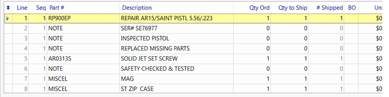

Looks like the jet set screw was missing...
The gun is shipping from Springfield today...
