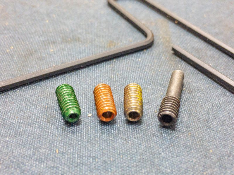

Do you have an adjustable gas block ? If so all it takes is a hex bit. In fact Lowes has a 40 piece bit set made by Cobalt that costs less than $15 and has most of the tips you will ever need for anything. Or you can by a metric/standard set of T handle hex wrenches for about the same price. You should have that stuff around anyhow if you own an AR-15.

That is how it is supposed to look when the jet screw is not missing...
Haven't tried it out yet but I expect it will work fine...

Thanks for all the help guys. I ordered the tool and the screws from springfield today and will see if I can get it to eject correct with that. I have built a few ar's in the past and have only had one that was over gassed and it had a gas port that was drilled to large. I have always understood that if it is ejecting like this it will wear the parts alot faster as they tend to slam parts more when over gassed...

I don't understand about the screws and the tool. Are you changing the gas block ? If not I think all you need is a hex wrench. The screw is in the gas block. Unless I'm misunderstanding something.
So, let me say that I put a 40 round clip in the gun and pumped 20 rounds through it rather quickly. It worked fine. I have one more question to ask in order to learn more about the AR. So, my understanding is that with the jet screw missing, the gun was operating in the beginning with the least amount of pressure possible with that particular gas block. Is that correct? Keep in mind that it has not been shot much at all. I am surprised that it worked at all with nothing there to control gas pressure except the hole.

My guess is that it was in there to start, then worked itself out as you shot. Once it fell out, the firearm stopped working altogether.
Got the screws and wrench from springfield and installed option 3. Went all the way in and backed out 1-1/2 turns to get it right. Still wish springfield would own this issue.
