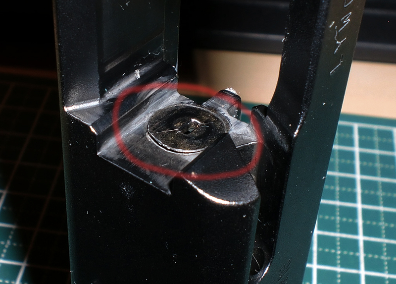

you can post all the pics and all the videos you want. i posted a pic of the back of the breech that got slammed too many times from dry firing.
here it is again
breach-face-jpg.14617
and this one, with the back story about DRY FIRING....
you're not about to change anyone's mind or opinions on dry firing.
you do you, many of us will do what we normally will or will not do.
That's what I've been saying thru the whole thread . Please don't turn it around like I'm the bad guy , When it was all the other way around . I never said people were doing things wrong . It was all accusations I was wrong . I am a professional Smith . I've worked on thousands of guns . This picture you loaded shows that is a lot more then just simple dry firing . Plus it looks like someone scrubbed it with a brush or something trying to clean out an area that had been let go quite some time . It also appears they used something with a pointed edge to scrape things off . Breach faces don't crack from dry firing . That would have happened under load . Firing live ammo . Wrong spring or slamming the slide home on an empty chamber . Not to mention what's the round count or other background . Might just be and old gun with several thousand rounds of hot reloads . I also looked thru 3 different companies owners manuals for modern guns . While none said it's ok to drive fire . None warned not to .
I've seen enough guns damaged over the years . Nobody that brought a used gun in ever said I've miss-used the crap out of my gun and it caught up to me . They come in thinking they can convince me it's been gently treated and I'll confirm they have a claim against the maker . They all always claimed they treated them gently and golly gee wiz . It just broke for no reason . Very few people say they have been rough on a gun . The ones that do are usually active shooters wondering if it can be fixed to keep using .
A breech would never crack from a spring throwing a Striker pin . That breech would only be subjected to slamming by someone allowing the slide to slam every time they racked it or under live fire . That's a whole different set of circumstances then press check and practice firing on an empty chamber . Lets not add to circumstances . Anyone doing a full lock back rack and letting go of the slide to dry fire shouldn't be using a gun in the first place .
Plus nobody I know who practices dry firing is doing what you suggest . A simple press check engages the trigger .
You seem to be suggesting that pulling a trigger caused the damage in the picture?? Not hardly You seem to be confusing letting a locked slide go on an empty magazine . With press checking and click . 2 totally different things . No professional suggesting dry fire is safe is suggesting what I just mentioned are the same event. In fact letting a locked slide go on an empty mag is always warned against doing :) In probably every Semi Auto Owner's manual. That isn't what anyone dry firing should be doing . It's misleading to imply that's what I or anyone else promoting it's ok to dry fire is saying THanks
