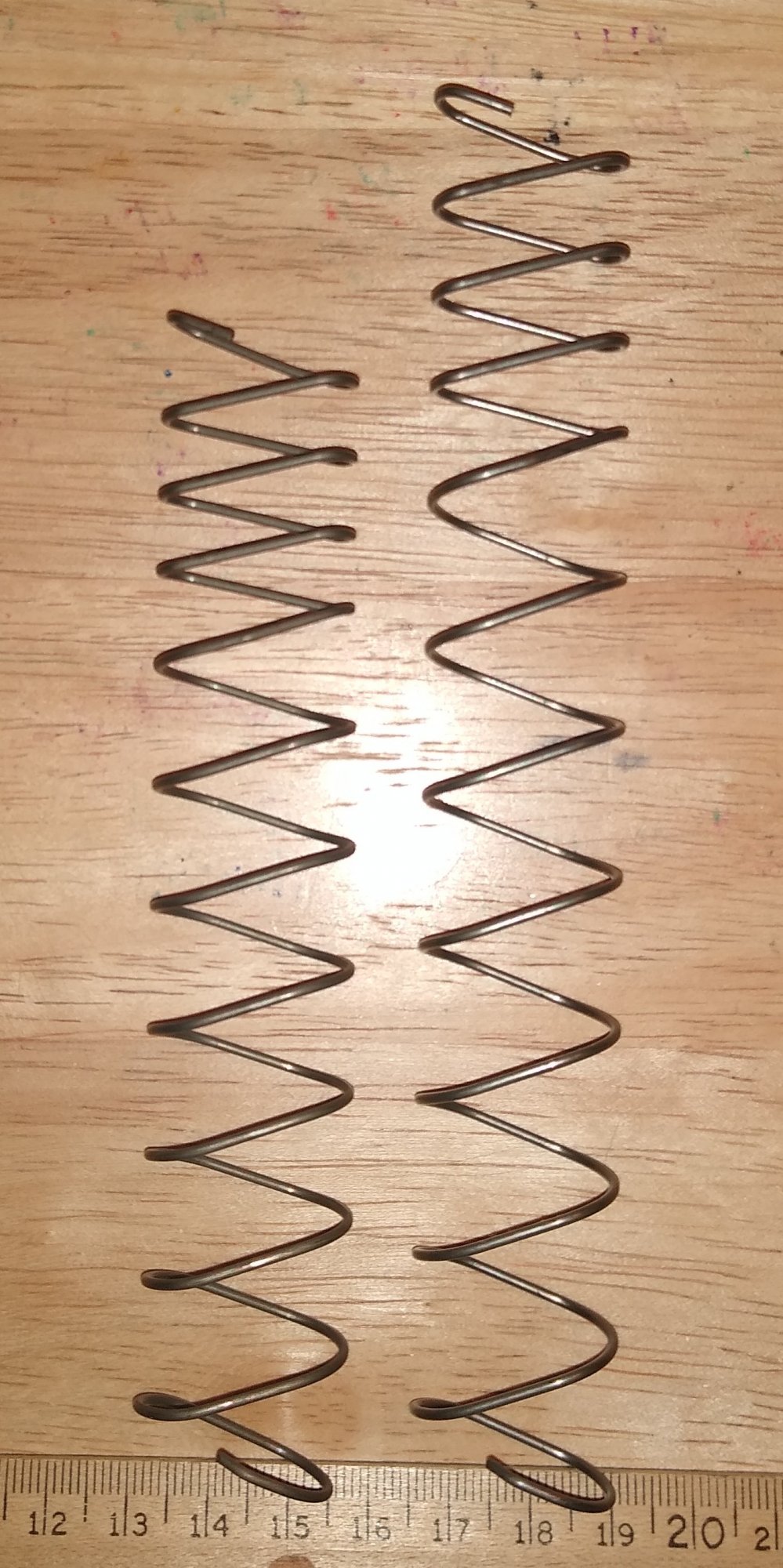

Here is the proof that supports my post and what I believe to be true. These are the mag springs I personally swapped. The shorter one is the mag spring that was compressed for a long period. The longer one was the new mag spring. Hard to argue that the shorter mag spring was not causing the misfeed issues, when the longer mag spring once installed made the pistol run like a champ.
Again I believe that the use of any spring being compressed for a long period of time or being used in cycling will weaken the spring. I don't think there is just one way to exhaust the life of a mag spring. In this case, keeping it compressed for a long period was the issue. Proof is in the photo.
Definitely possible.
To make it completely scientific you would have to compare two factory mag springs, one that was stored for a while loaded versus one that wasn't. To compare a replacement spring versus a used spring would introduce other factors.
Also remember I did say quality was possibly the most important factor. Quality springs are less likely to have issues like that and we all know quality is very subjective.
Great information thank you.
Mags dont lose their strength from being stored loaded or unloaded, they get weaker from being used.

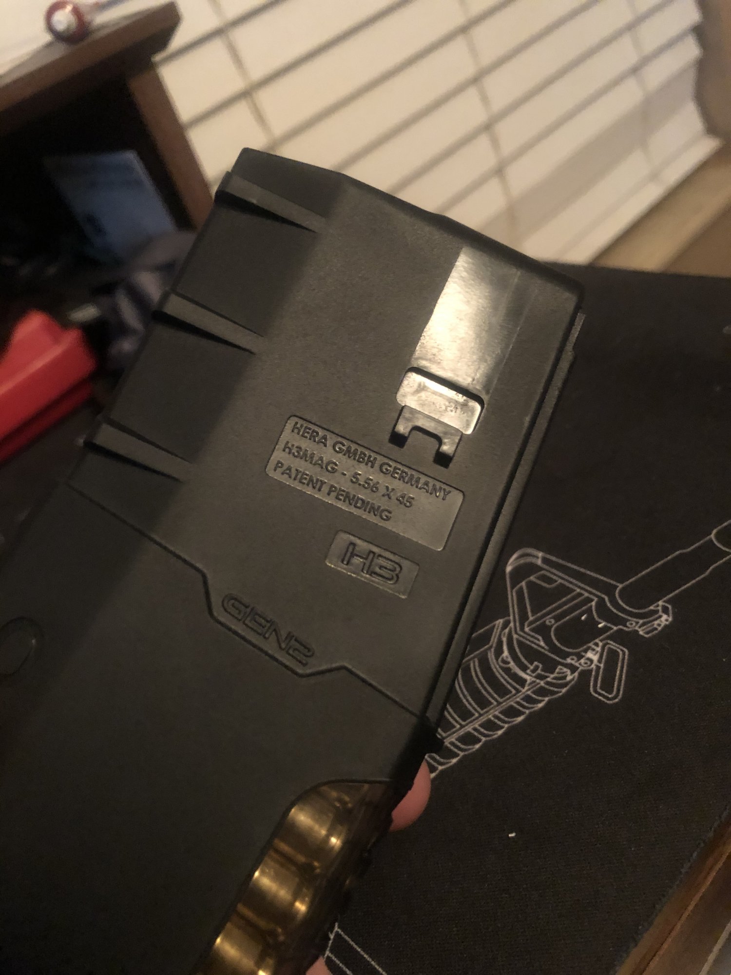

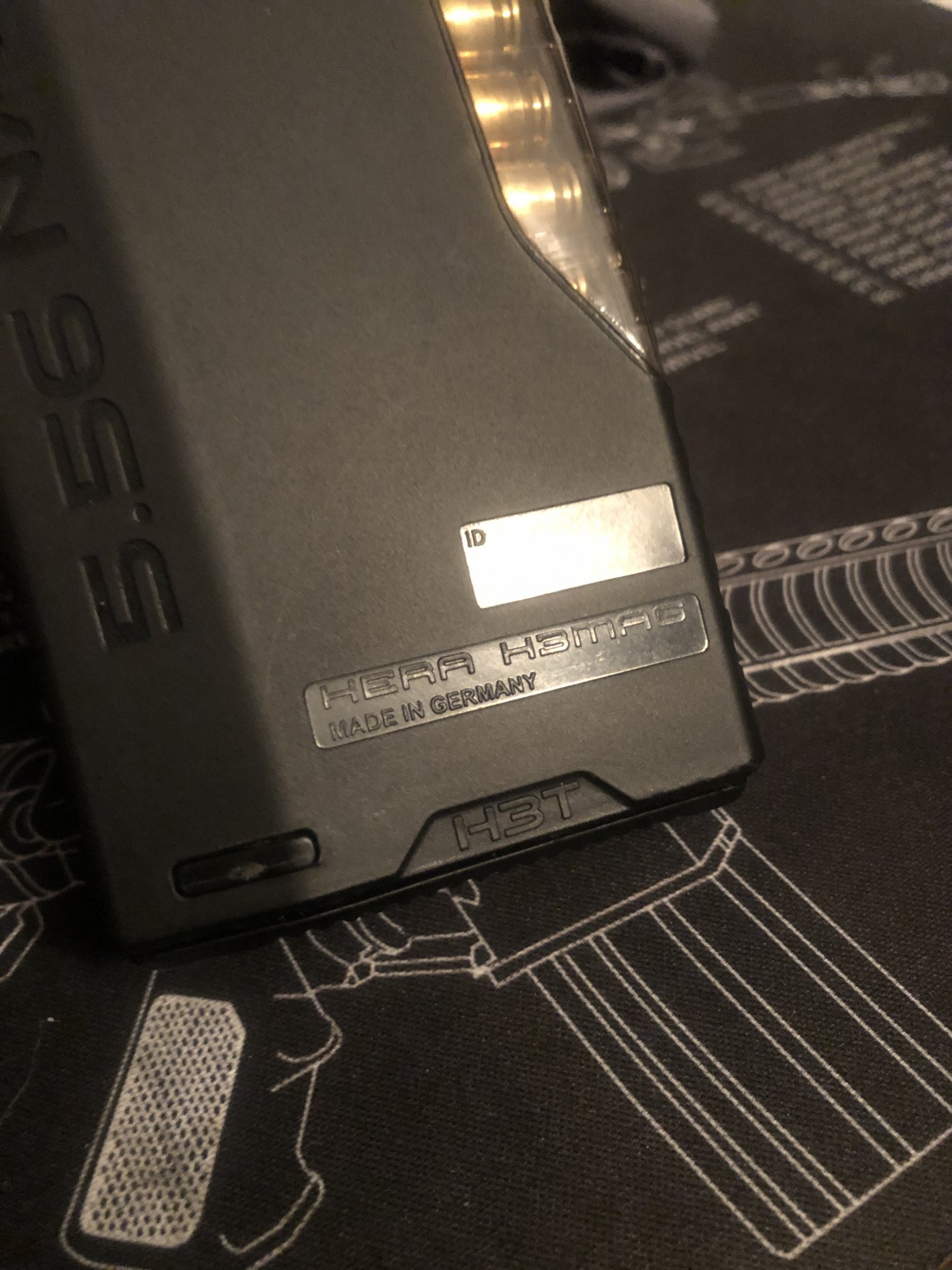

I use Pmags with and without the window, Aluminum GI, Lancer AWM and Hera Arms H3T gen 2.
Im digging these Herra mags though. The gen 1 was complete garbage. Whatever they did worked. These feed great in all my rifles, and are slim in the pouch.
