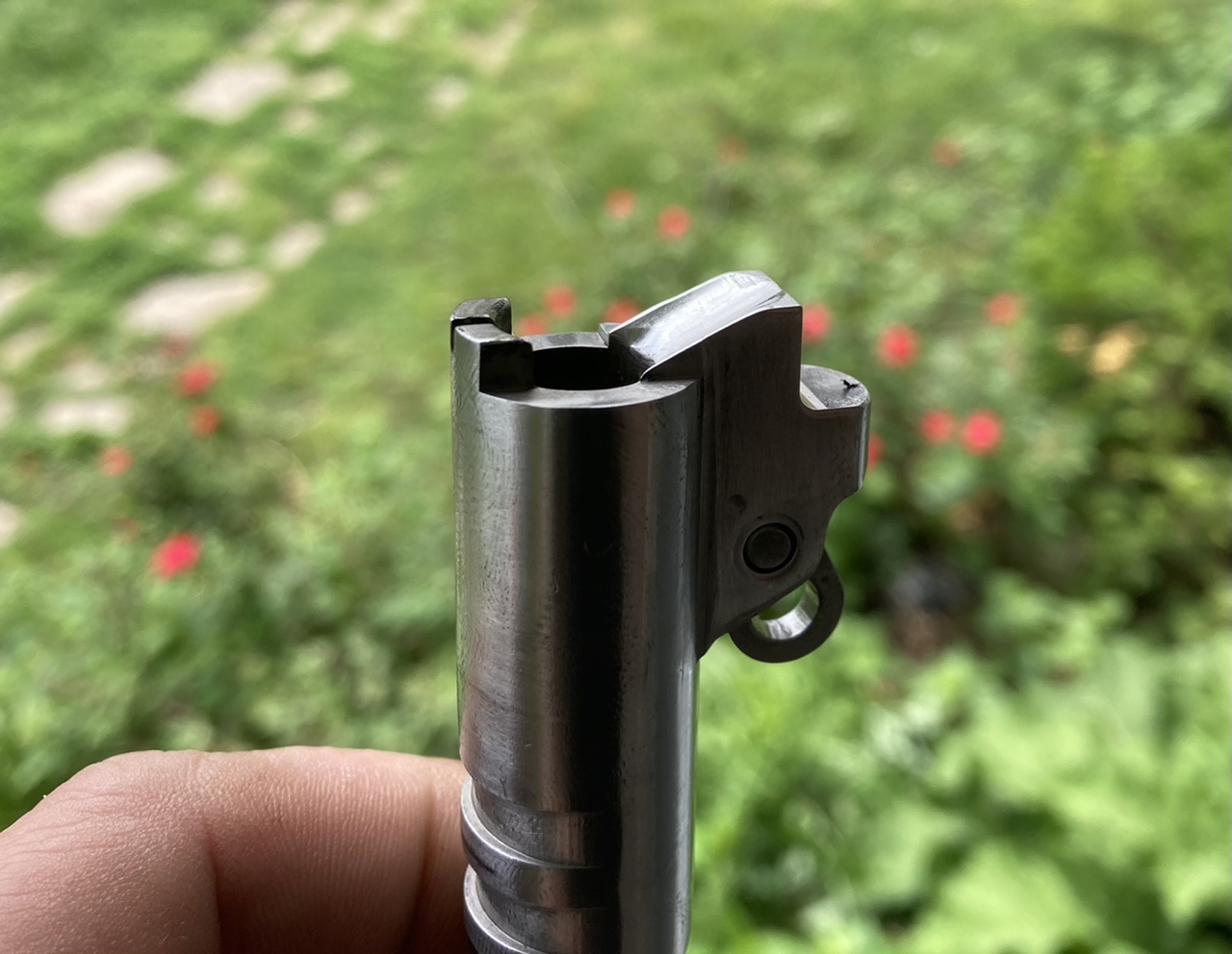

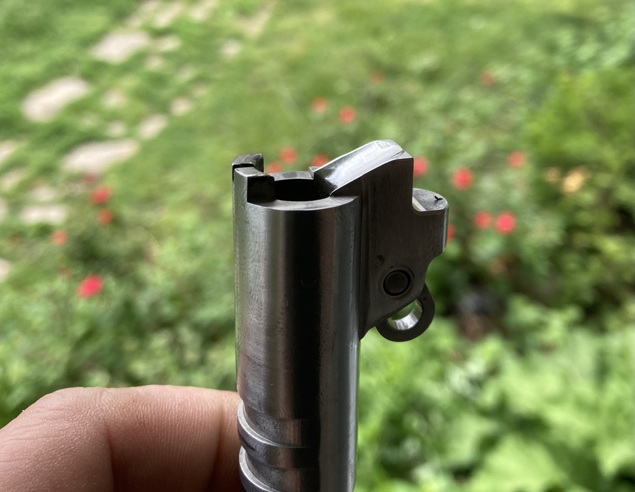

I opened the Kimber 10mm again to look for obvious issues.
The only thing that jumped out right away was that to be a chunk of the feed ramp missing.
Here is the barrel next to the other 10mm barrel. The other side of that feed ramp doesn’t look so hot either.
I don’t know that this is the problem but it did seem like the rounds were favoring that upper left corner to get hung up. I’m sure this doesn’t help.

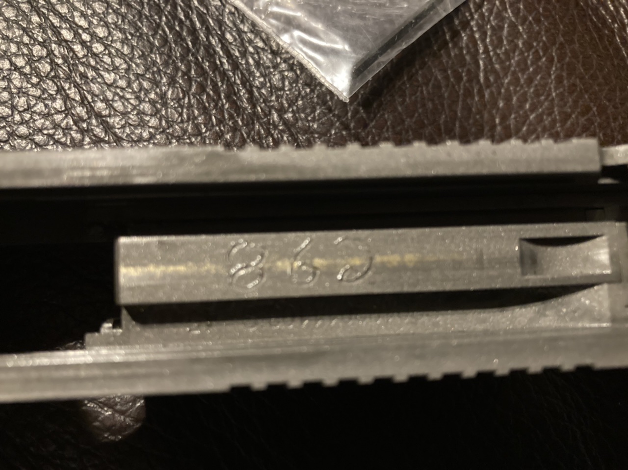

The new Loaded was tight, like, super tight. I expect after breakin, it should be a solid shooter. We only got to shoot one mag each due to the rain. Not really aiming at anything special just function testing. The Kimber, despite only having just half a box of ammo through it, ram fine. The Springfield had 3 FTF and didn’t lock the slide on the last round. That prompted me to disassemble it and look deeper.

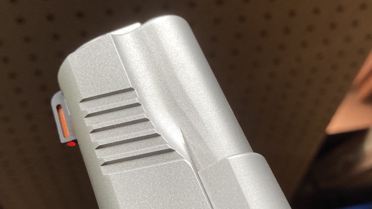

Turns out, there are numbers hand engraved on the bottom of the slide. Those numbers have raised edges, which have to pass right over the disconnector. It’s causing enough drag that the slide doesn’t have enough umph to strip a round about half the time. That’s got to be fixed before it ruins the top of the disconnector. It’s got constant upward pressure on it and those engravings a chewing away at it. I think it may be going back to Springfield as well but the jury is still deliberating on that. I’d like to at least do a quick accuracy test before I call them.
Picture of the stupidness…
That area should be pretty smooth given what it does.

The malfunctioning 10mm Kimber Stainless II is back. I wish I had good things to say, but unfortunately, there isn’t going to be much of that.
Here is the detailed description of the service that was performed.
So, instead of replacing the barrel with the chunks missing out of it, the ground it down further and attempted to make it work.
The barrel after service.

Attempting to “fix” a defective barrel instead of replacing it on a $900 gun automatically gets you a “C” grade. That’s assuming it actually works.

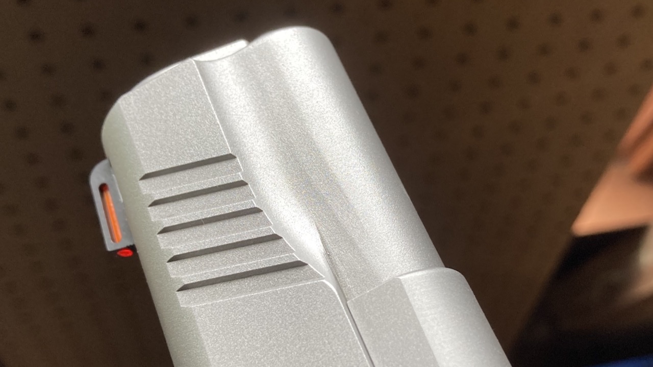

The issues with the filing marks in the slide were not addressed at all.
The slide when returned.
That gets us down to a “D” grade on the warranty work for failing to correct manufacturing defects that were clearly pointed out.
How did it perform?
In short, I didn’t get through a single magazine without a failure. First failure was a failure to feed. Second failure was that the slide locked back mid magazine.
Failing to function with off the shelf factory ball ammo after warranty service, you get an “F” for warranty service.
