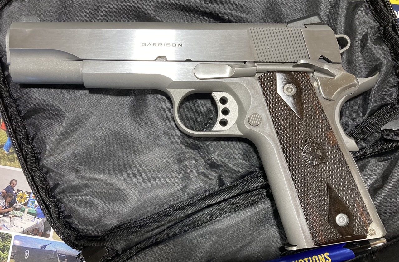

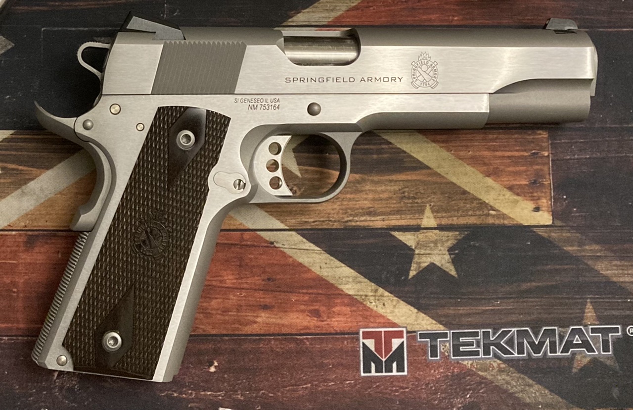

In person, it does have a more traditional look, despite having modern features like improved sights, oversized beaver tail grip safety, skeletonized hammer and adjustable trigger. Like having a milspec with basic upgrades. Despite not owning one, I do very much like Springfield milspec. I have tried to talk my neighbor out of his once or twice 😁.
I believe I understand what they were going for and I do think they nailed it. I will likely swap the grips for a brighter set at some point. I’d like to get it home and clean the preservatives off the surface so I can see what it really looks like under the haze.
My previous 9mm 1911s weighed in at about 1.5oz less than this one. Those were soft shooters. I expect no less from this. Once I have it here, I’ll be able to give a better description of how it stacks up in the fit, finish and performance. I have another one of these coming in the near future also in 9mm.

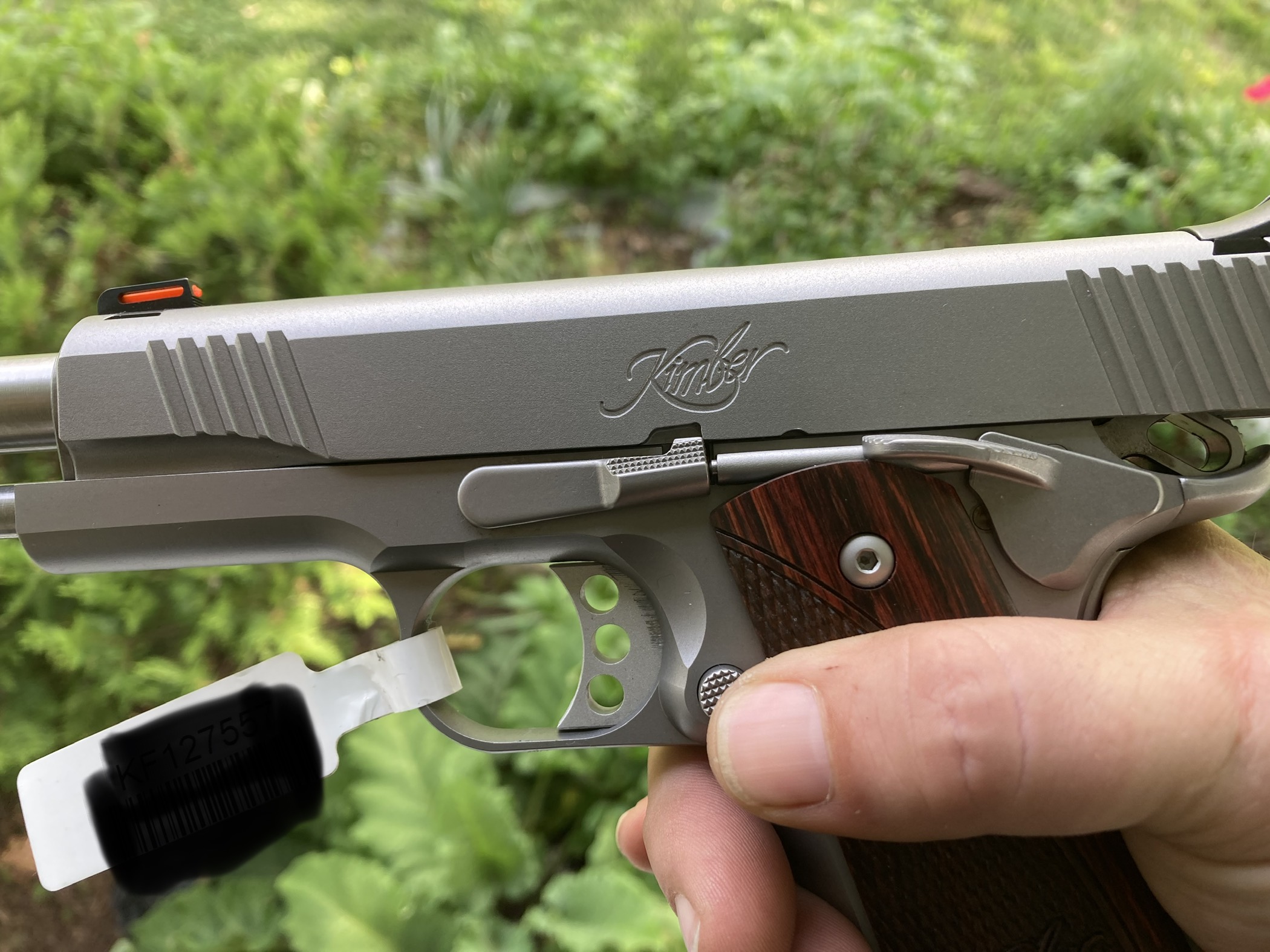

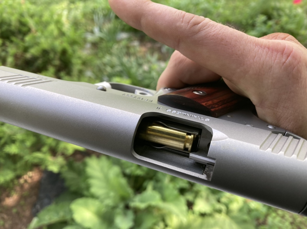

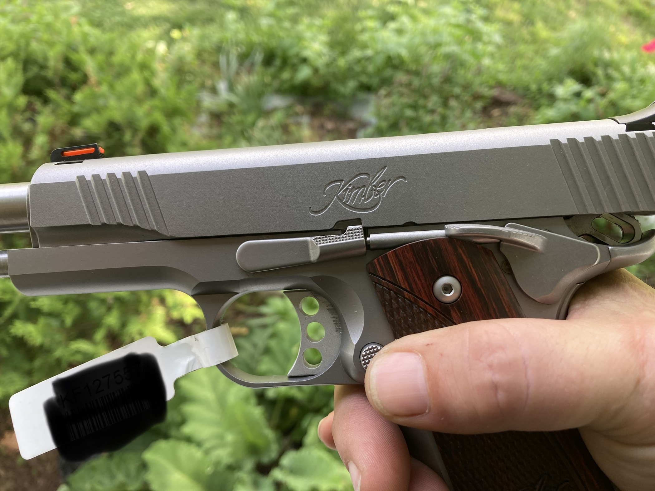

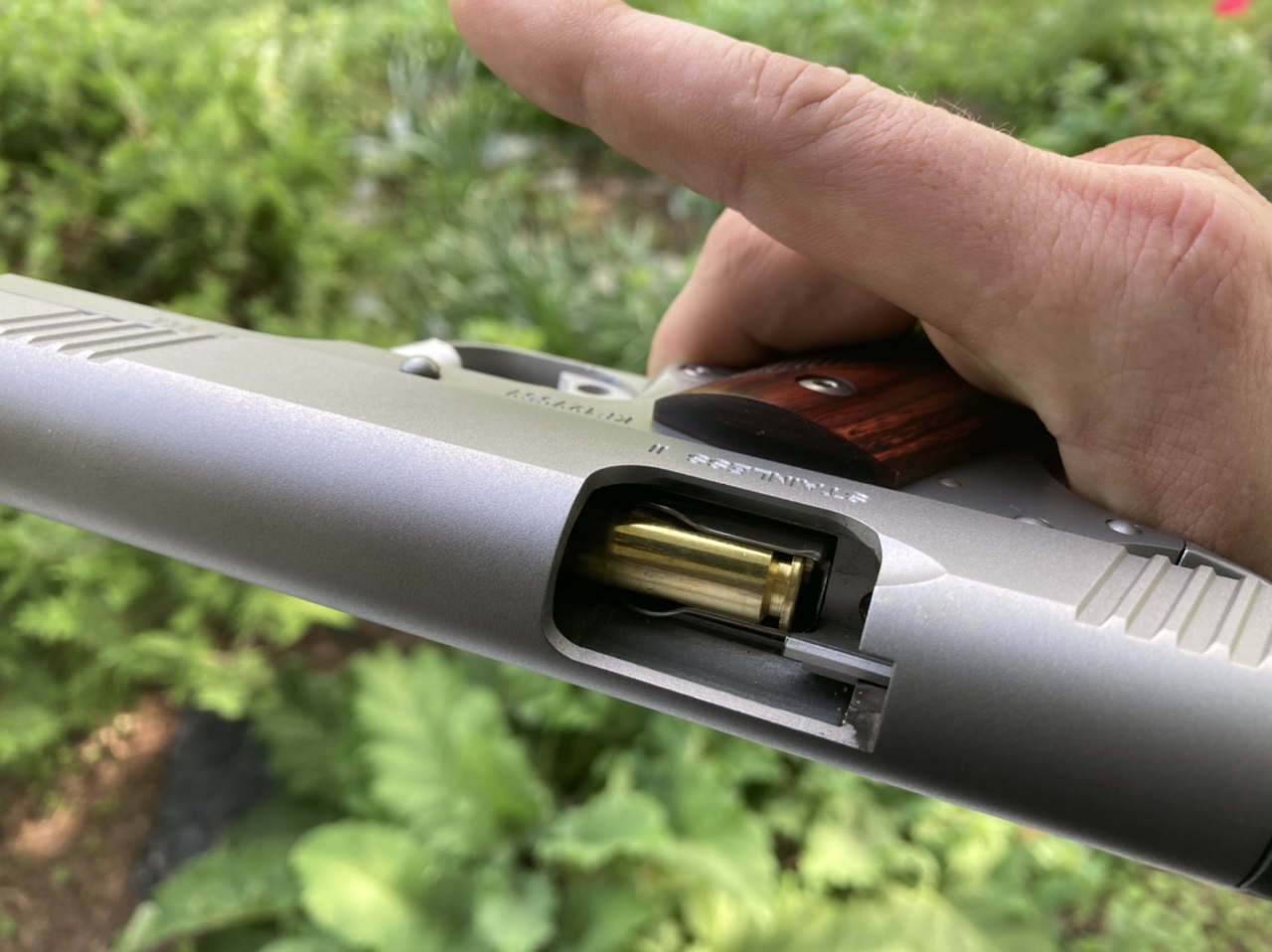

Well that was short lived. Good news is, the JHP rounds fed fine. The bad news, the slide locked back again. It’s not going into a full lock, the stop is only partially engaged. This was the same last time.

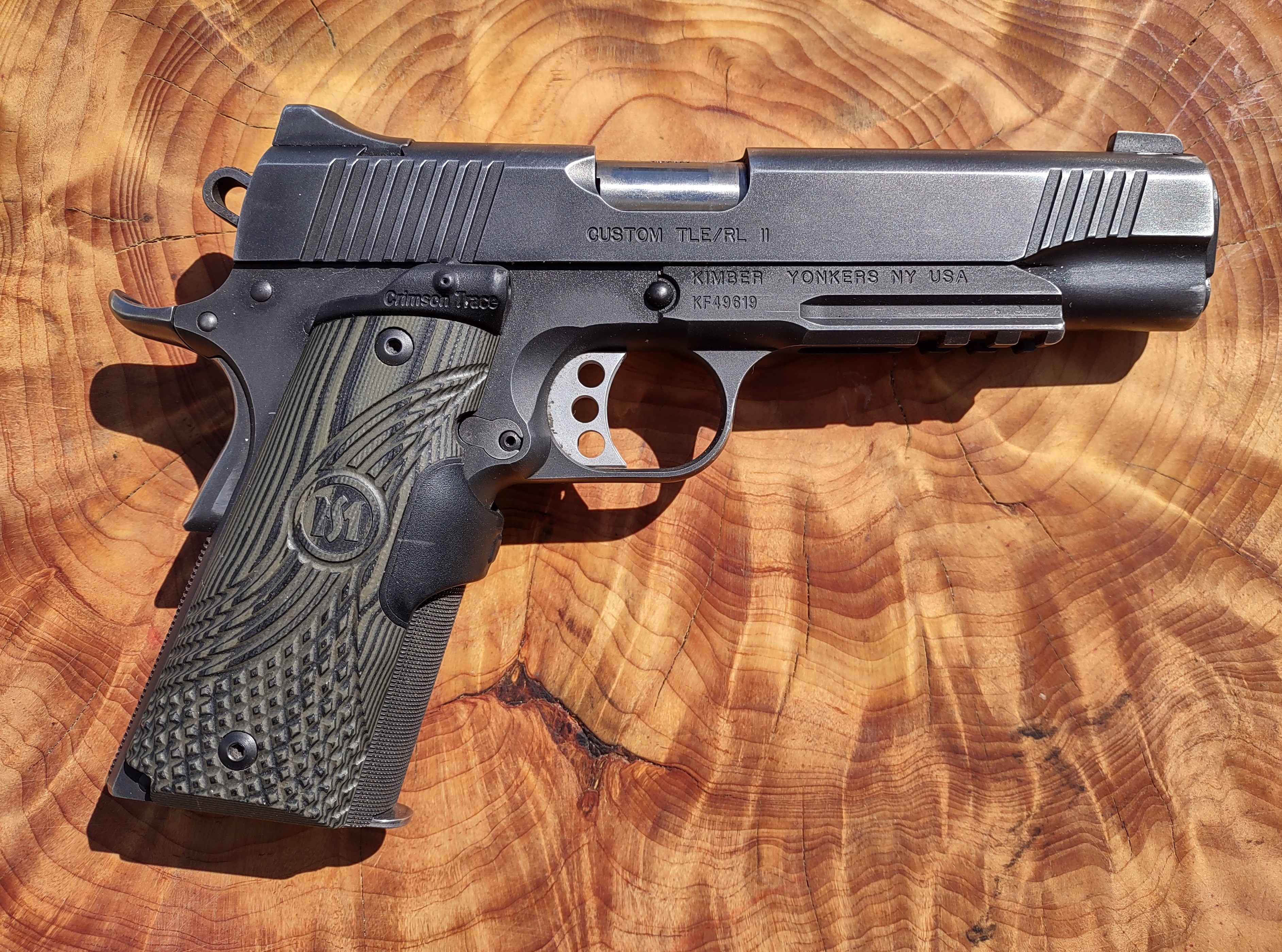

I've put approximately 100 rounds through my Kimber Custom TLE RL since I got it back from the factory. Not one FTF and it also definitely fells like it operates smoother when cycling. The slide now goes back to full battery with more athority and less resistance. It is functioning much better now no doubt. Although I received no maintenance report from Kimber when I got it back, or from the dealer at my LGS when I picked it up. The man behind the gun counter I usually most always deal with, talked to about and gave my 1911 to personally to ship back to Kimber. Was not at the LGS when I picked up the pistol after the factory repair. I did see him a few days later. He told me Kimber replaced the slide lock, polished the slide rails, polished the feed ramp and replaced the extractor. I never looked closely at the extractor myself, but I'm assuming it got damaged by the two and only two cases that got stuck in the chamber. Both 220gr hard cast from both Grizzly and Buffalo Bore Ammo companies. Both cases had the primers blown completely out of the casings. I'm not sure Grizzly nor Buffalo Bore can even be called Ammo manufacturers! More like Pure Crap Manufacturers, but that's another topic for another day for sure! 👍
It has always been a very accurate pistol and is extremely fun to fire when operating and functioning properly. "If" the pistol continues to operate with no malfunctions for another 400 rounds l'll be satisfied and confident in it's reliability, and It will always have a place on my hip and in my gun safe. If not? I see a Springfield in my future! All depending on how and when I get my M1-A SOCOM CQB back from the SA factory! 🤔 If that firearm becomes an issue? As far as 1911's go, Les Baer will be getting my business sooner than I anticipated! ☝️ I'll also add the only three firearms I've ever had to send back to the factory for repairs and/or finer tuning. Was a Kimber 1911 and two different SA M-1A's 🤔hmmmmmmm!🤨
Mine slide lock was being engaged by cartridges when feeding, but I'm not 100% sure on that. More like 85%. Like yours, the lock was not fully engaging when this action happened. The top corner of the lock would just barely catch the bottom corner of the slide stop notch in the slide. Just like in your picture. It's been cycling S&B 180gr FN flawlessly every since I got it back from factory repair. We'll see if this continues or not?

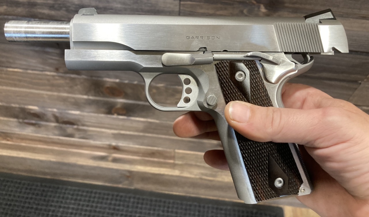

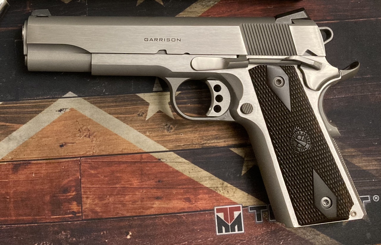

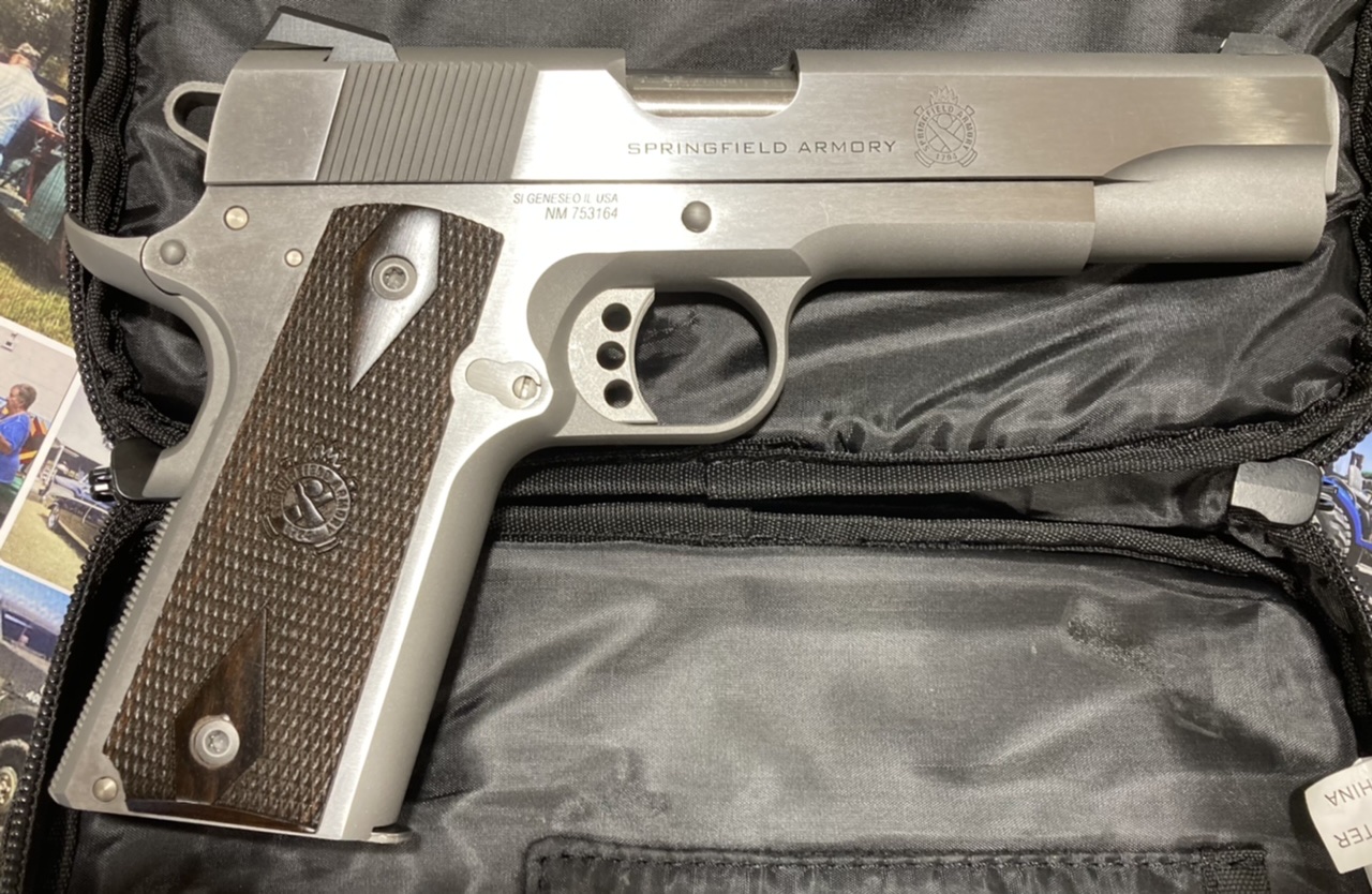

Ok, so here are some clean pictures of the Garrison 9mm.

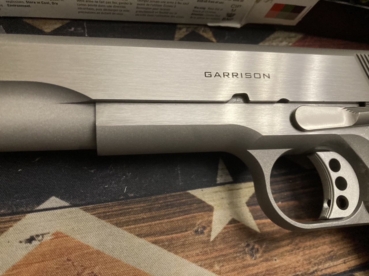

First thing I noticed was that the pressure on the disconnector was enough to hold the slide open on its own. I suspected I would have to sand the bottom as I did with the Loaded but I waited until I ran test rounds first.
I started off with some Remington UMC range ammo. The Garrison only comes with one magazine. Luckily I had a Kimber mag available. Magazines are identical, even stamped with the same patent number (assuming MecGar’s patent).

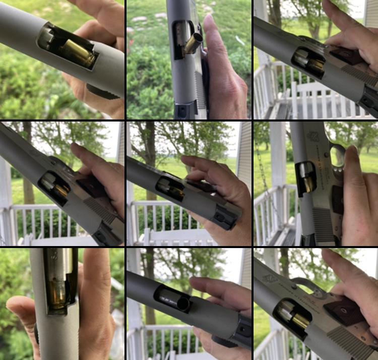

First two magazines only chambered the rounds manually. Of the first two mags, there was a 100% failure to eject. The giveaway was the failure for the slide to hold open on the last round. It was not cycling the slide far enough back to hit the ejector with enough force to expel the spent case.
Awesome right?
I took it back apart as sanded the bottom or the slide exactly as I did with the previous Loaded. I finished out that box with a 1 round per magazine failure to eject. That was a drastic improvement over the previous two magazines.
I moved on to a box of Blazer 115gr FMJ and averaged 1 failure to eject per magazine.
From there I took the gun apart, cleaned / oiled again and went to 124gr FMJ. I averaged maybe a little more than 1 failure to eject per mag, along with a couple instances of the slide failing to hold open on the last round.
The cycling manually feels pretty smooth. I think the recoil might be a touch heavy, preventing the slide from full rearward travel. At this point, there have been 158rds put through it. Only 3 mags ran without a failure and those were not consecutive magazines.
