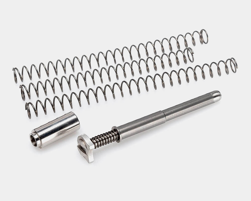

As you probably could tell from the title, John has put around 50,000 rounds through his TGO II. He has been through multiple recoil springs in this particular TGO II, partly for routine maintenance but largely because he was experimenting with different power level loads that had to cycle the gun reliably. He is currently running a DPM Recoil Reduction System, which he feels does live up to its name. He admits to being lax on firing pin spring changes, having done so only once that he can recall during his 50K round time frame.

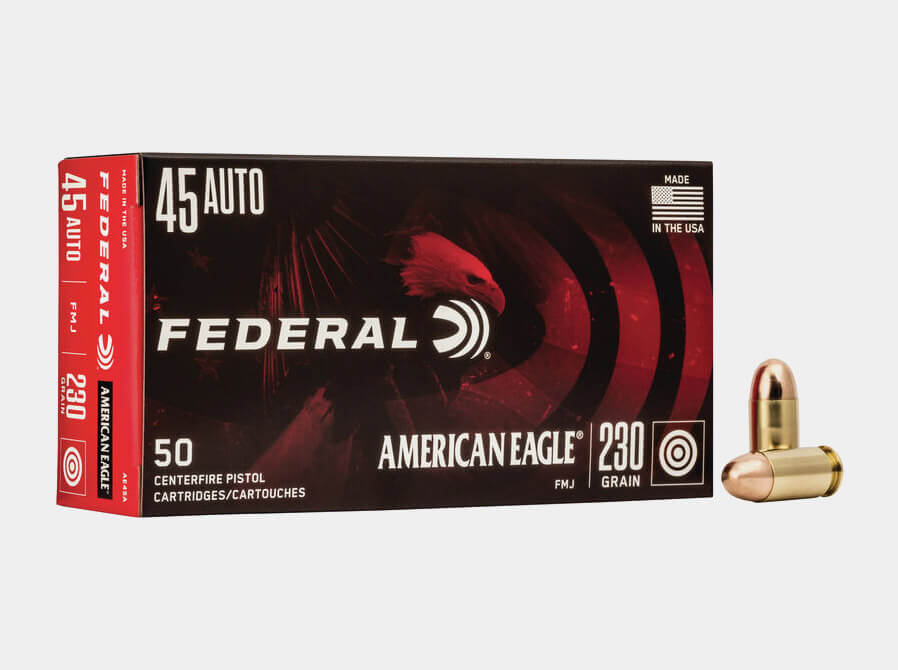

John estimates that about 30,000 of those rounds were American Eagle 230-gr. full metal jacket that he bought several cases at a time when he didn’t think he had time to reload. When he got more serious about winning, crafting a softer-kicking round that still made power factor in competition motivated him to get into reloading. He has settled on a load that makes power factor with 230-gr. coated round nose bullets.
Count the primers. John Strayer, shown here in his personal reloading space, clearly shoots a lot.
None of these have been +P loads, and .45 ACP being a low-pressure cartridge, his TGO’s barrel has stood up well. On visual inspection, it looks surprisingly good. I put it on the bench and tried it out for myself, and with the AE load and John’s current preferred reload, it showed sub-2″ 25 yard grouping potential.
