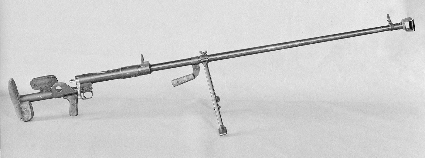

The PTRD 1941 Degtyarev was a bolt-action, single-shot 14.5mm rifle with the barrel and receiver built into a spring-loaded tubular frame. Sights were offset to the left of the gun. The PTRD’s weight was 38.5 lbs., and its length was 78 ¾”. The PTRS 1941 Simonov was a massive, semi-automatic 14.5mm rifle, magazine fed by a five-round clip. The gun could be easily disassembled into two loads for transport. The PTRS weighed 46 lbs. and was 84¼” long.
