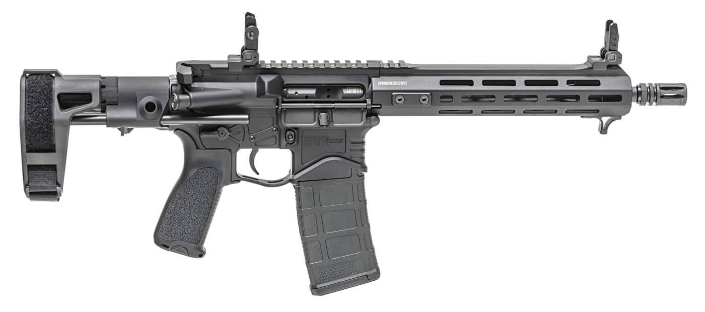

The latest from Springfield Armory, which I’ve chosen to call the “Quaint SAINT,” looks just like a typical MSR/Modern Sporting Rifle — with two exceptions. The SAINT pistol’s barrel length’s less than 8″, and it’s fitted with a stabilizing brace. While it simply looks like a Modern Sporting Rifle with a very short barrel, it fits the BATFE definition of a handgun. Who am I to argue?
Springfield Armory has introduced a full line of SAINT Pistols, like this SAINT Victor 5.56mm.
As one who was never bitten by the MSR bug, I suddenly find myself fascinated by the latest iteration of the MSR platform from Springfield Armory. In 2016, Springfield Armory joined the long list of manufacturers of .223/5.56 modern sporting rifles with the introduction of the SAINT. Now they have taken it one step further with the SAINT Pistol. This opens a whole new facet of handgun shooting for this old dog.
Taffin fell for the SAINT Pistol and really liked its handling and performance.
My approach to the SAINT Pistol was to see it as a close-range self-defense pistol. Let’s consider the gun.
She’s No Angel

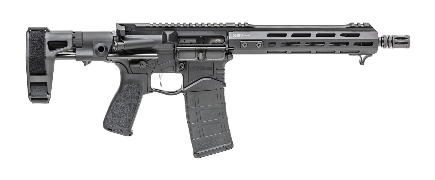

The SAINT Pistol’s 1:7″ twist Melonite-treated 416R barrel is a mere 7.5″ long and equipped with blast diverter to channel sound, concussion and debris away from the shooter. The receiver extension has an SB Tactical SBX-K brace to help stabilize the pistol for accurate shooting. Overall length is 26.5″ with a weight of 5.5 lbs. The upper receiver is forged Type III hard-coat anodized 7075 T6 aluminum while the lower receiver’s of the same material and fitted with the “Accutite Tension System.”
The new. SAINT Pistol has an MSRP of just $849.
The gas system’s a direct impingement pistol-length system with a low-profile pinned gas block under a free-floated M-Lok forend sporting a safety stop. The trigger is nickel-boron coated and the trigger guard and the pistol grip are from Bravo Company. The SAINT is exceptionally well made with no looseness or rattling. It just seems to be solid all the way around.
