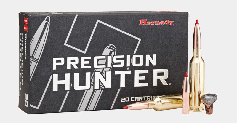

hornady 6mm creedmoor cartridge
The 6mm Creedmoor cartridge, like this Hornady Precision Hunter load, offers precision, power and range.

Springfield Armory graciously provided me with a Waypoint 2020 rifle in 6 CM for me to use for this article. The ammo scene being what it is right now, I only picked up a box of Hornady Precision Hunter and Hornady Match ammunition from the local gun store. Accuracy for both was very good.

Although my passion is long-range shooting, I recognize that the 6 CM doesn’t make a half-bad hunting round either. Typically, 1,000 lb/ft of energy is used as the threshold for what would be considered ethical on medium game. The 103-gr. ELD-X bullet in the Precision Hunter ammunition hits that benchmark at about 500 yards. Here on the East Coast where most hunting areas are populated by thick forests, sometimes 100 yards is a long shot. Hornady, Barnes, and Berger have other options with bullet weights from 70 to 100 grains to handle most any varmint or predator also.
