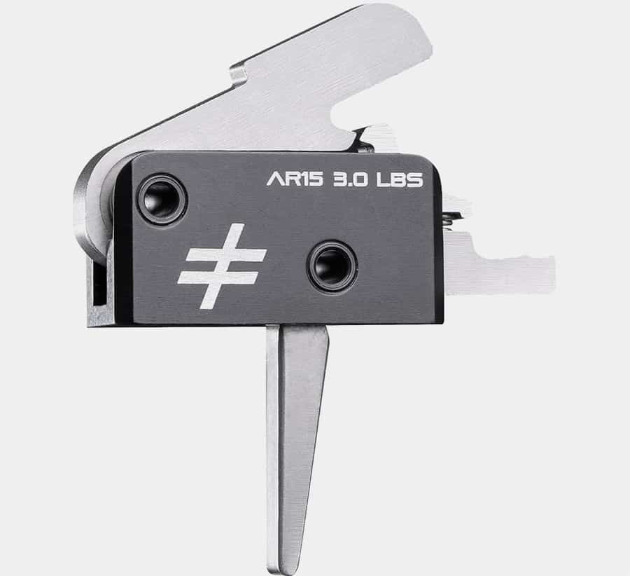

Blackout Defense is an up-and-coming trigger company that has really made an impact on the market recently with these triggers. They are named the “Zero” because they have practically no movement while installed in a mil-spec lower when on safe. This is far different from what you will find on mil-spec triggers and even some aftermarket drop-in triggers. And when you disengage that safety, the pull and reset will again remind you of why it is called the Zero.
testing the blackout trigger on the range
The Blackout Defense trigger proved to be a real winner in the author’s Springfield Armory SAINT rifle.
The trigger housings are made of aerospace-grade aluminum. The trigger, hammer and disconnector are all wire edm cut. The hammer is S7 tool steel, and the disconnector and trigger shoe are both A2 tool steel, so you will see no shortcuts on materials were taken for this trigger pack.
This is a drop-in, or as it is often called a “cassette-style” trigger, so installation is relatively simple and just about anyone can likely do this with minimal skills and tools.
