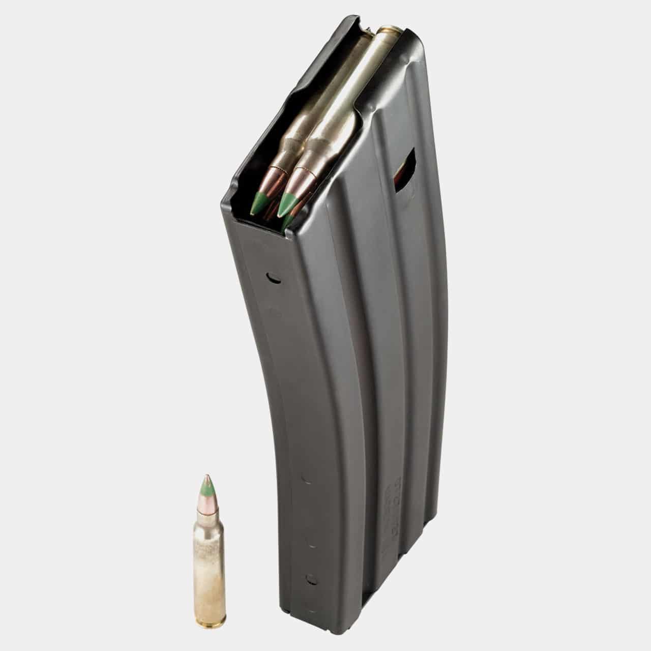

The 5.56/.223/300 BLK DuraMag SS is made by C Products Defense and is described as an improved version of the U.S. GI magazine. The DuraMag SS magazine uses a 410 stainless steel body (DuraMag also offers its Speed magazines with a 6061-T6 aluminum body). It is offered with either a black or orange anti-tilt follower and in 5-, 10-, 20- and 30-round cartridge capacities.
duramag stainless steel magazine made by c products
DuraMag SS magazines are manufactured by C Products Defense here in the U.S.
First off, the stainless steel body makes the magazines heavier than polymer or aluminum. Unloaded, the 30-round stainless steel magazine weighs 6.2 ounces. I weighed a 30-round aluminum and a polymer magazine, and they tipped the scales at 4.3 and 5 ounces, respectively. Extra weight can be a good thing. It aids ejection, meaning it falls out of the magwell quicker and more reliably than polymer. Stainless steel is also more durable than aluminum and polymer. The downside is it is heavier, so, the more mags you carry, the more weight you need to move.

I repeatedly ejected empty DuraMags from a SAINT Victor AR-15, and they all fell free, with scuff marks being the only result. Most of the testing was with the Victor, but I also tried the magazines in several other rifles, some with ambidextrous mag releases. No issues. Every time the magazine positively locked into place.
ammo used to test the duramag ss stainless steel magazine
The DuraMag accommodated typical 55-grain ammo (center) as well as rounds with different nullet shapes like 300 BLK subsonic ammo from Gorilla Ammunition (left) and Nosler 77-grain HPBT (right).
I also dropped fully loaded DuraMag magazines from chest height to simulate a fumbled reload. We all fumble a reload occasionally, and that’s ok if you can recover quickly. What you don’t want is your magazine hitting the deck and losing its lunch by spilling out rounds. The DuraMag kept the rounds in place. I also stepped on loaded and unloaded DuraMag magazines with no ill effect. I also loaded them up by hand (tedious) and used a Mag Pump AR-15 magazine loader (fast).
Heavier bullets are usually longer and have a different profile and ogive. Lead-free and heavier Nosler 77-grain HPBT rounds and my favorite 300 BLK subsonic ammo with a 205-grain bullet from Gorilla Ammunition had no issues in the magazines.
The Victor ran smoothly with no stoppages with the DuraMag SS magazines. I didn’t baby the mag-azines, either. Over the last few months, I’ve used these magazines in all types of ARs. The routine was load, shoot, reload. No issues. I was totally confident the DuraMag would do its part and feed whatever AR I was running.
