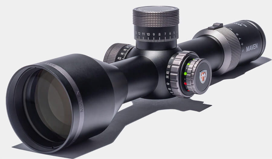

Maven RS.4 5-30x56 variable rifle scope profile
For a high-magnification, variable power optic, the Maven RS.4 5-30×56 scope is relatively compact.

The RS.4 comes in either MOA or MIL configurations. The one I tested happens to be the MIL configuration, providing 10 mils per turn on the elevation knob, a zero stop and the choice of two illuminated MIL-based reticles. The windage knob isn’t locking or covered, so you’ll need to be careful that it doesn’t spin inadvertently while you’re carrying it or taking it out of a pack or case.
Scope knob on Maven RS.4 3-30x56
Maven uses bright, easy to control turrets to adjust your scope. However, it does not come with covers so use care to avoid bumping it.
There’s a tandem illumination and parallax knob arrangement that has become popular on scopes of this type, which is convenient and efficient. The illumination lights the entire reticle up in either green or red, with a shut off in between settings.
The side focus parallax knob adjusts focus from 15 yards to infinity, making this a great option for not just precision centerfire rifles but those serious about precision rimfire matches, also. The 34mm main tube means there will be a ton of good mounting options and plenty of elevation for just about anything I want to shoot.
